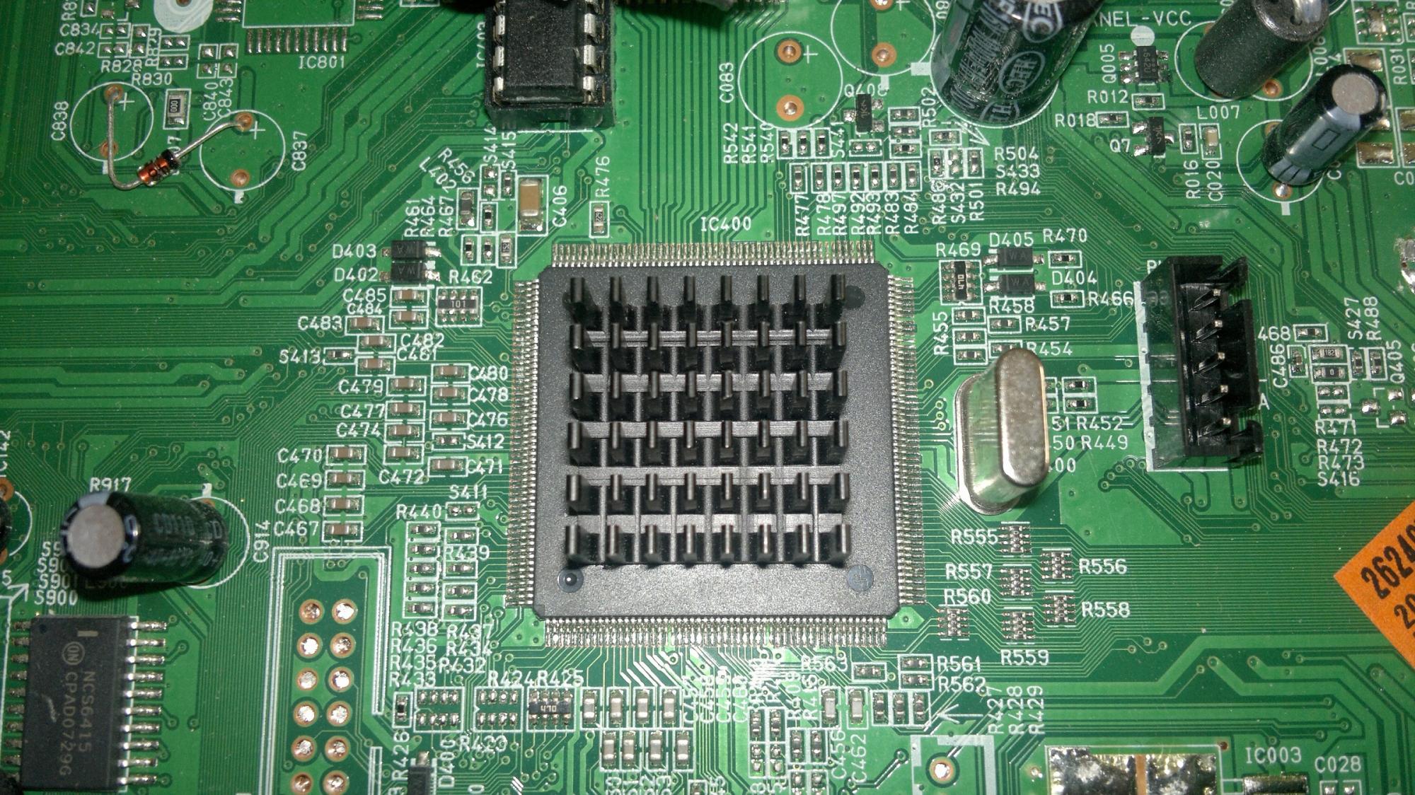

            IC400 is the VCTP Microcontroller on the M/B - it's near the centre of the board and has the semi-rigid heatsink attached that resembles a 3" long piece of black tape - does yours not have this? And the chip does get pretty hot, on mine anyway. I'll upload a pic shortly.

              Re: 32" Goodmans TV
              Yeah, I see it. Agreed, it gets hot, don't imagine it being a major issue though.

                #47

                  It seems to have been an issue on my board - as I mentioned in an earlier post it was reflowing SMD components around/underneath/adjacent to this chip that finally provided my fix.
                  System: HP xw6600 Workstation, 650W PSU | 2x Intel Xeon Quad E5440 @2.83GHz | 8x 1GB FB-DDR2 @ 667MHz | Kingston/Intel X25-M 160GB SSD | 2x 1TB Spinpoint F3, RAID0 | 1x 1TB Spinpoint F3, backup | ATI FireGL V7700 512MB | Sony Optiarc DVD +/-RW | Win 7 Ultimate x64 | 2x Dell UltraSharp U2410f | Dell E248WFP
                    Odd. What were the symptoms when your TV wasn't working?
                    Also, did you use thermal paste for the new heatsink?

                      I had various symptoms, from 2s-to-black/intermittent running/LED flashing (various rates)/not starting with HDMI connected. As I seemed to resolve one issue another arose, so I've been all over both the PSU and M/B, looking at the circuit diagrams and trying to rectify the relevant stages on each board. It's taken me absolutely ages over the past 3 weeks, done my head in at times, but I saw it as a challenge and was determined to fix the bastard.
                      I simply attached the heatsink with superglue; over the years I've found it to be very effective in all sorts of applications. The original T-Wing is only attached with adhesive anyway so I guessed I had nothing to lose - as it turns out it's working rather well in conjunction with the fan.
