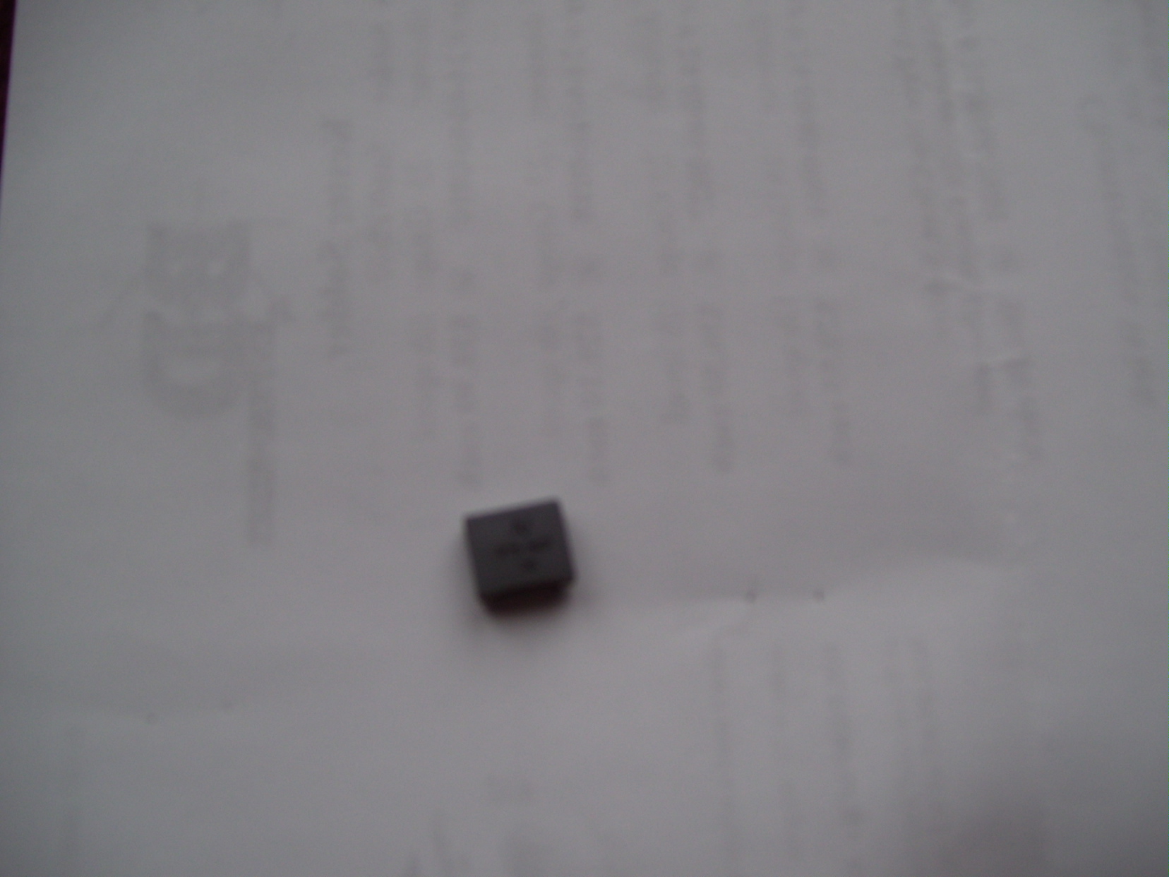

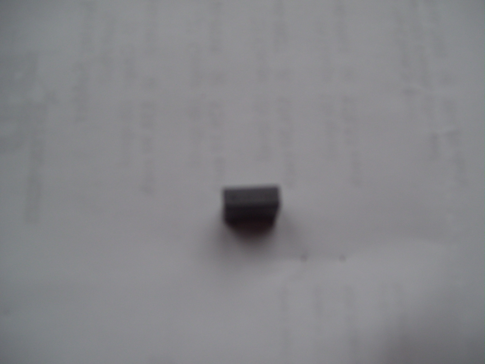

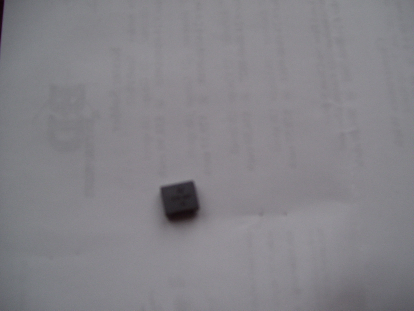

            Here are some photo of this part I know that these photo are not very good and the sun is in the clouds today
            Here is what is on the top of the cap AV .22 J160
            Here is what is on the side of the cap AV next line R75 MKP next line (K)
            I hope that you can tell what type of cap this is so I can order some
            Thanks for you time and help all who have posted something

              Man, those are some fuzzy pictures. I guess this puts the lie to the aphorism 'A picture is worth a thousand words' because your description of the text tells me everything I need to know.
              AV is the manufacturer's logo, .22 is the value (.22uF), J is the tolerance (5%), 160 is the voltage (160 volts). On the other side, R75 is probably a date code, while MKP indicates it is a metalized polypropylene film cap.
              Digikey 495-1278-ND is one possible replacement, Mouser 539-171224J160F-F is another.
