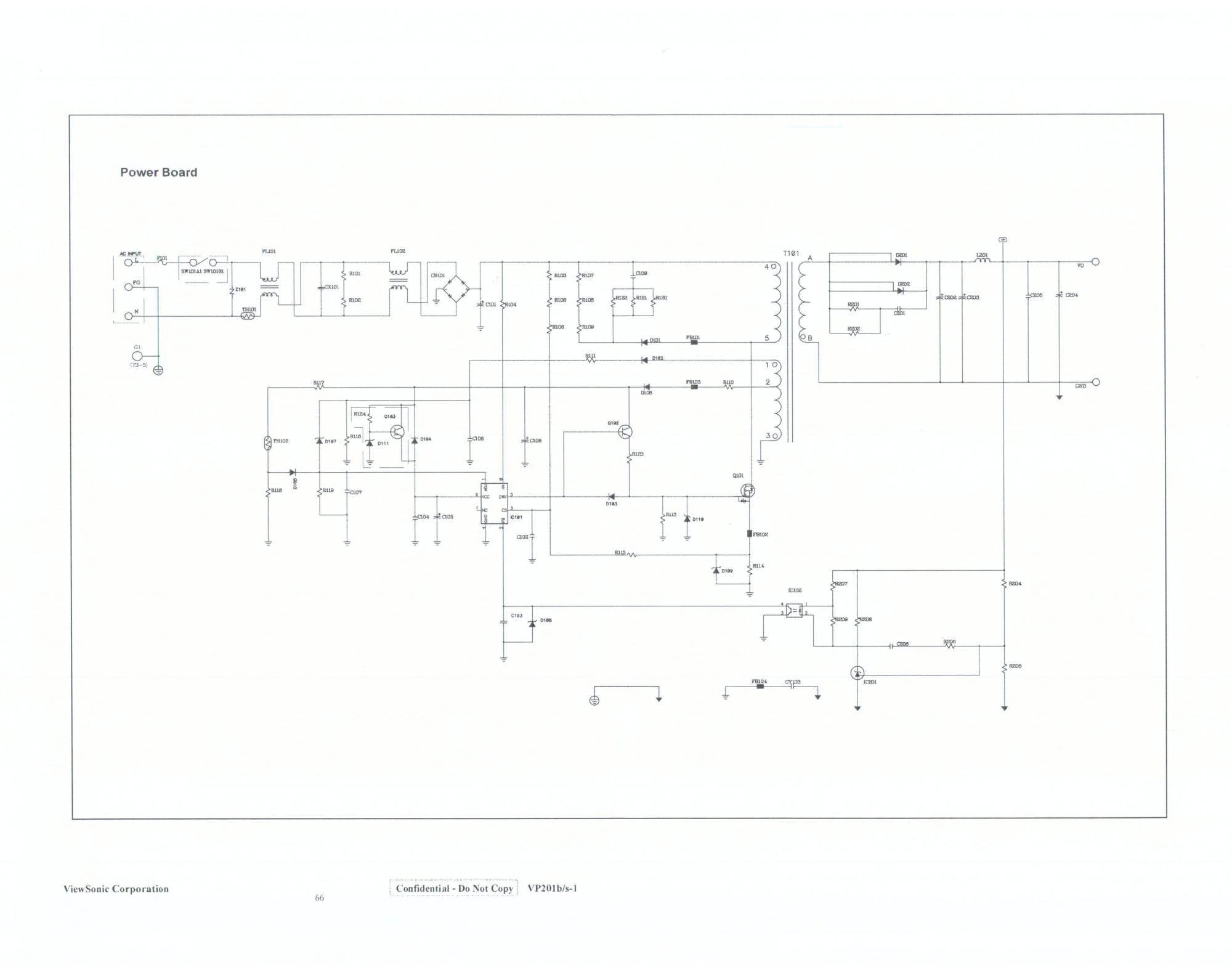

                A little help please with locating the components. Current sense resistor, power cap, starter cap.

                    Re: Viewsonic VP201b power supply option
                    R114=current sense resistor.
                    C101 is the main filter cap.
                    C105 is the startup cap.
                    Some people (I WAS one of them) ignore the small electrolytic caps. C105 and C106 should both be checked and replaced if there is any question about their condition.

                          I seem to have misread the schematic. If C108 is a small electrolytic cap, check it. Low capacitance on these caps can cause problems.

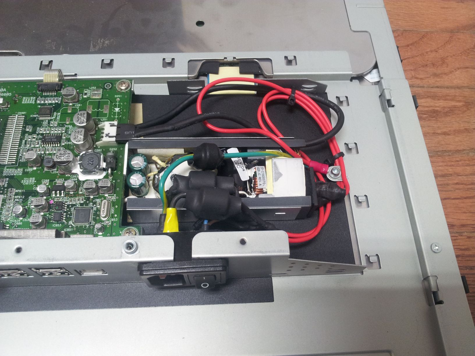

                                  I know this is an old thread but it's coming up on google and I have a few things to add.
                                  1) The monitor will happily run on the HP 18.5V 3.5A supplies
                                  2) If you crack off the plastic casing it will fit in place of the original power board, barely (see image)
                                  Recapping my board didn't quite do the business so I decided to go this route since used laptop supplies are dirt cheap and work out of the box. Used the back ends of crimp connectors to interface with the C6 power pins and the rest is just solder and heatshrink. Ignore the black connector, should have re-used the original. If anyone else does this remember to strap the earth and connect the hot wire (should be the blue one) through the switch.
