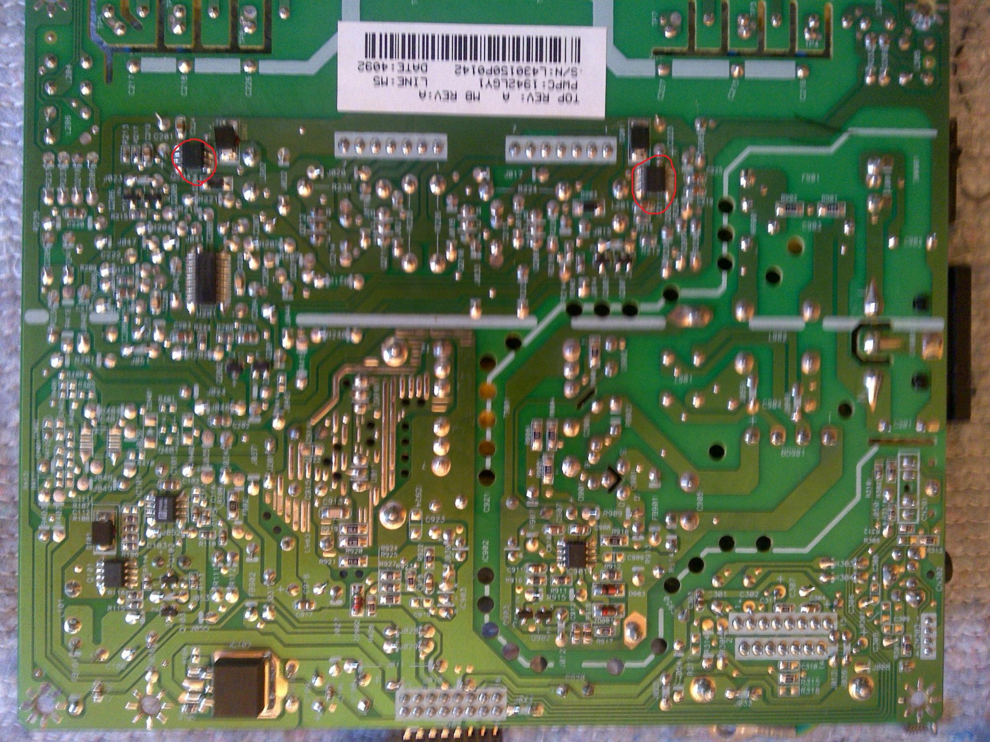

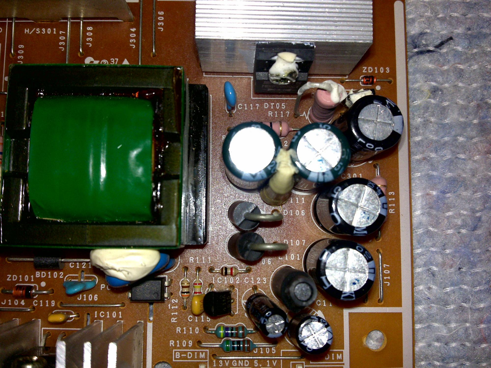

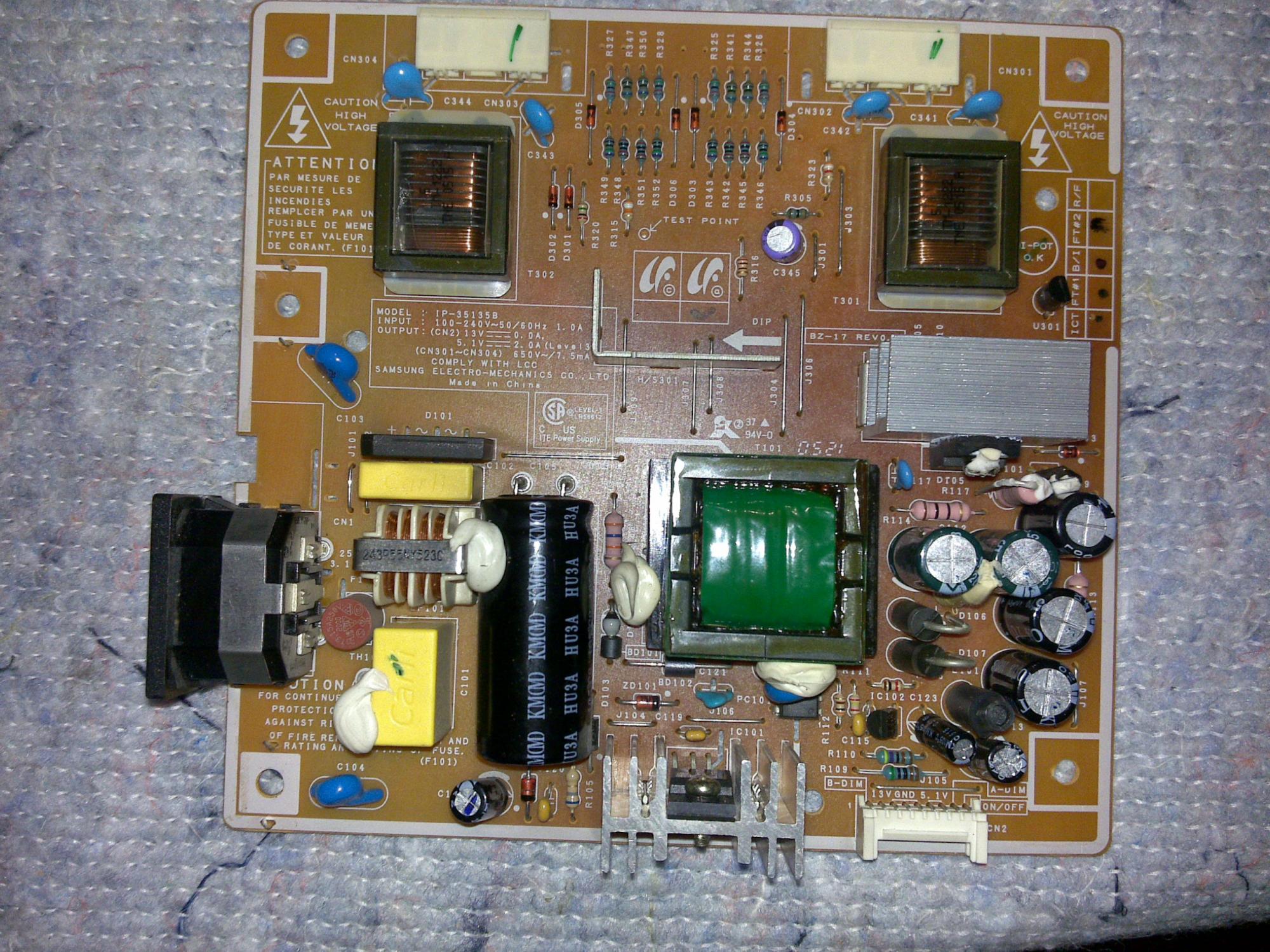

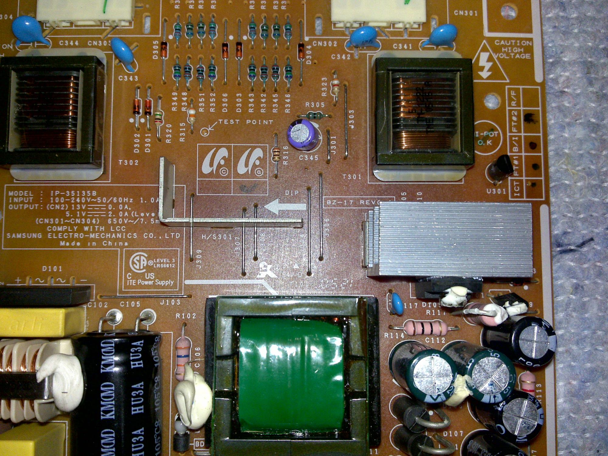

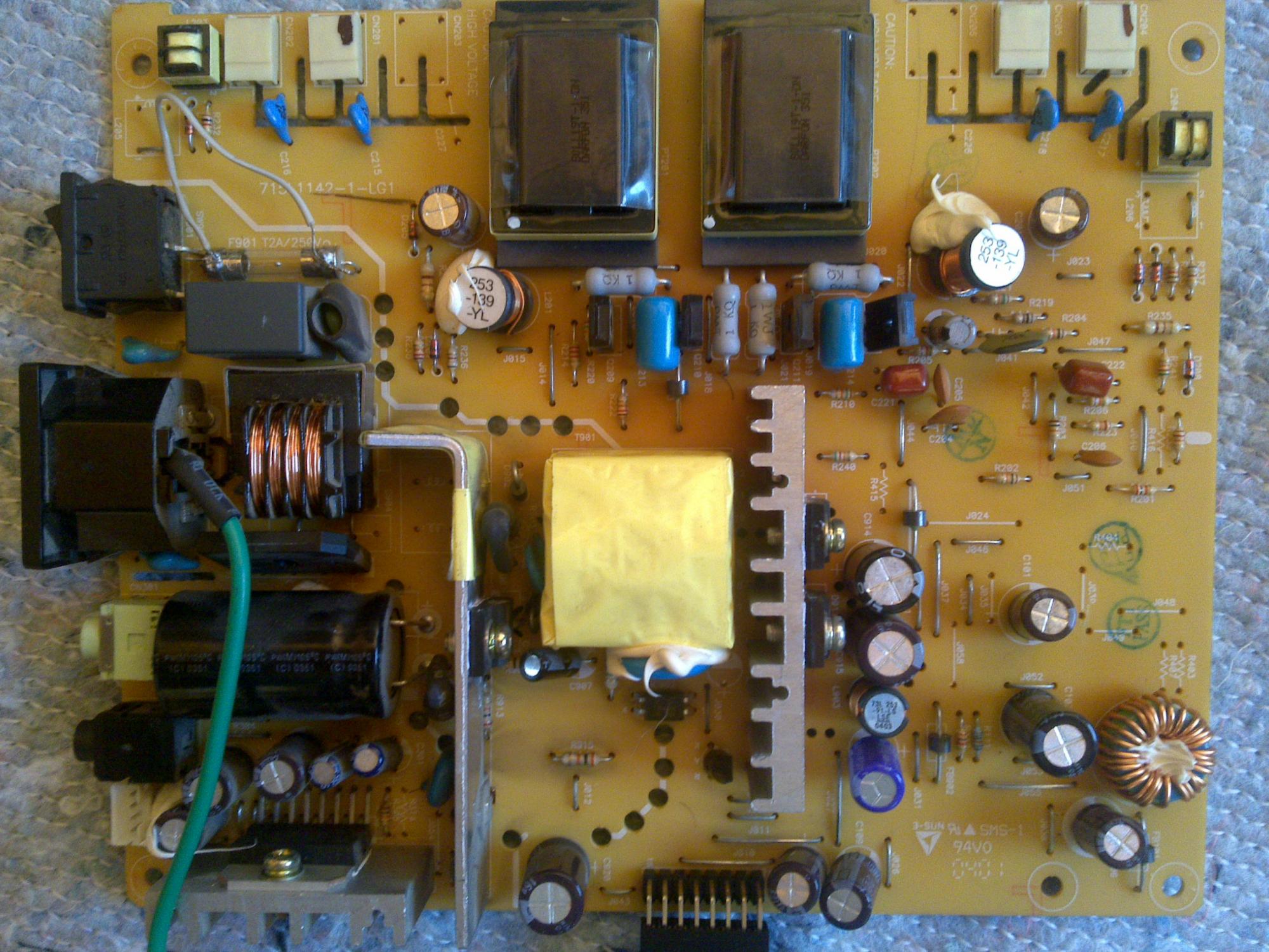

          Re: Iiyama Prolite E481S goes dark after 1 second, blue power LED steady on
          thanks for your interest
          these pictures for my fault board.
            Hmm, made by Samsung.
            1. What brand of capacitors are these?
            2. I would like a picture like the first, but of the back side of the board.

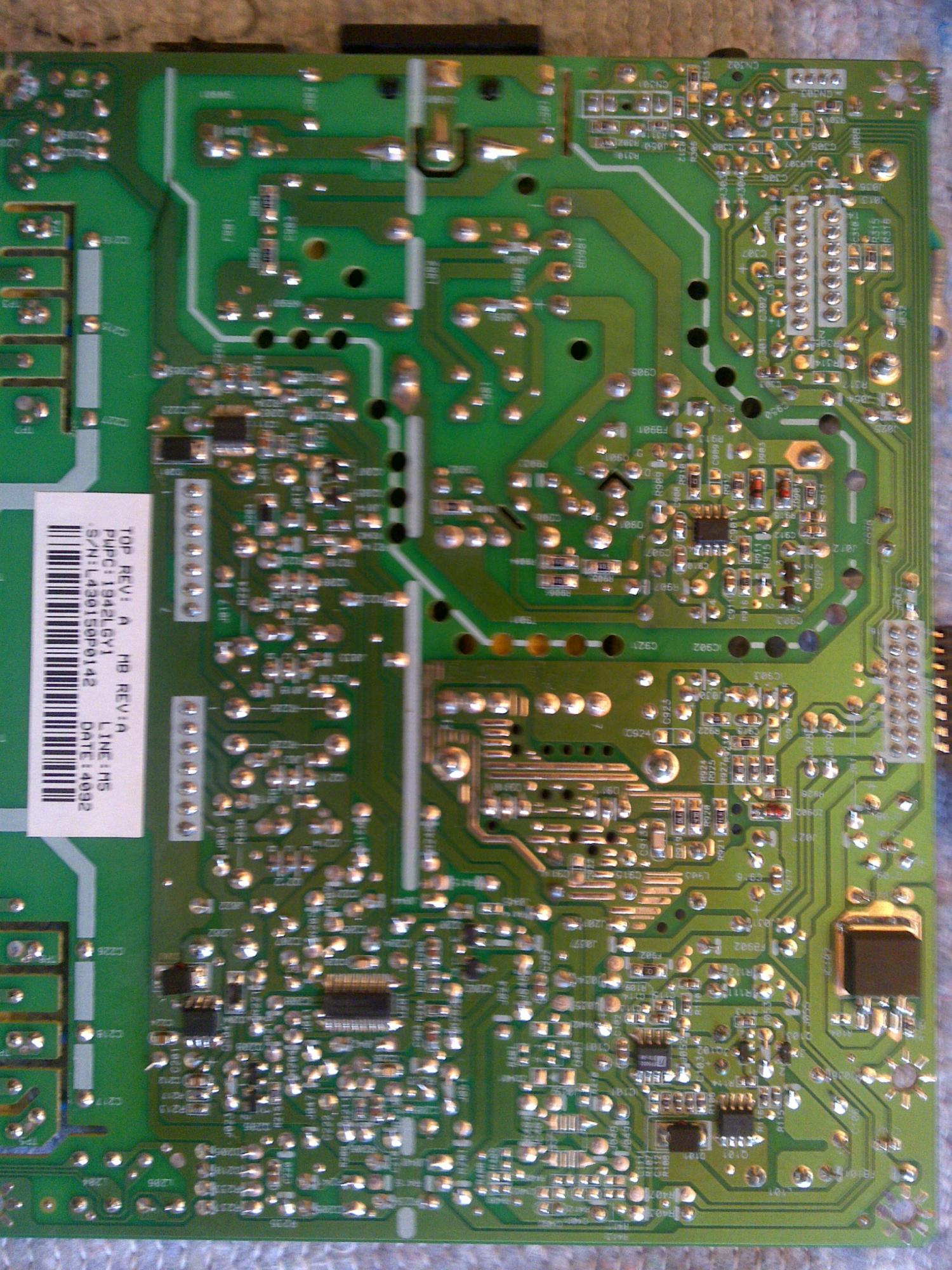

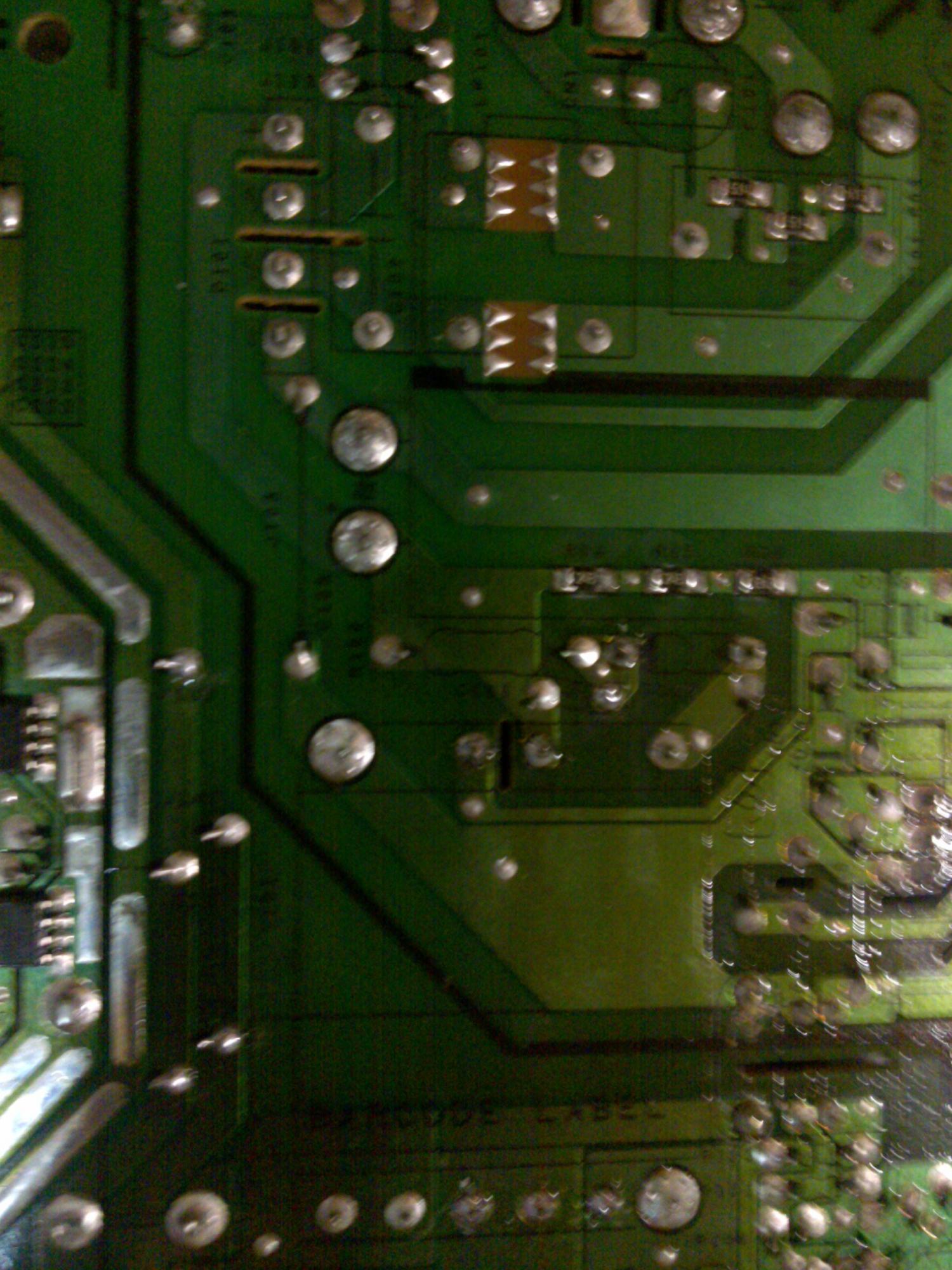

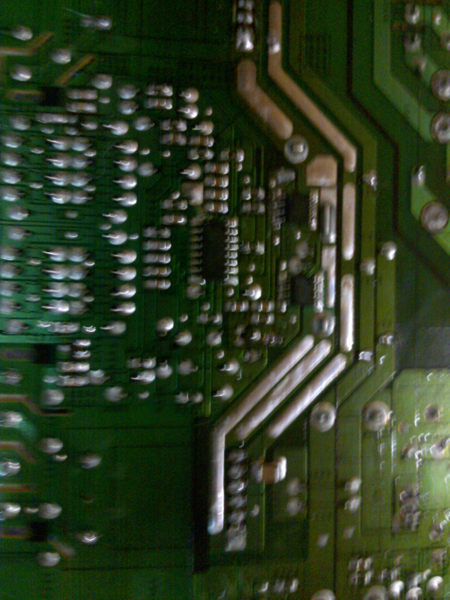

            • enghijjawi
              • Jun 2011
              • 10
              Thanks for your note and sorry for that error
              Actually, where was the images of the LG screen. If you remember the first to post on the schematic of this screen.
              These new images for the screen iiyama
              Thank you and thank all the forum.

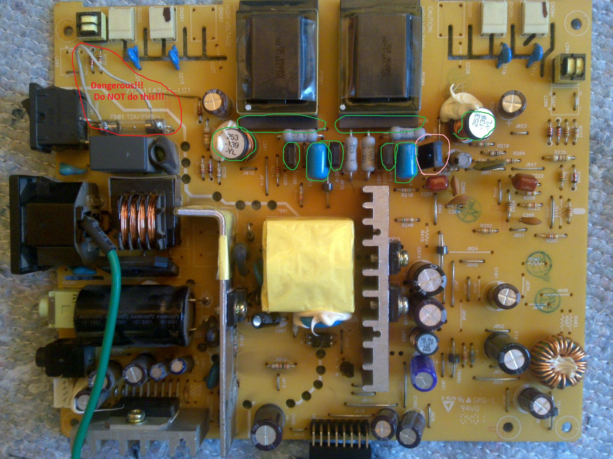

                I've marked up and attached the pictures. First, several comments.
                1. When I saw the jumper across the fuse, I ALMOST decided to ignore the thread. Bypassing a fuse is a very foolish thing to do.
                2. When I view pictures of the top and bottom of a board, I prefer to correlate left-right. It is more difficult to correlate top-bottom. It is pure HELL to try to correlate when the pictures are rotated 90°.
                3. The picture of the top was quite good - I can even read component identifiers without expanding it. The picture of the bottom was almost useless. Even expanded to full size I can't read most component identifiers.
                This monitor uses an inverter design called a Royer oscillator. It is readily recognizable by the large poly cap between the paired transistors and the inductor. The strengths of a Royer oscillator are the low component count and the high efficiency - it's a tuned circuit. The weakness of a Royer oscillator is the transistors are destroyed if anything goes wrong. This monitor has two Royer oscillators and a single control IC (on the bottom). The control IC will shut down both oscillators if either is not working properly. Individual transistors turn each oscillator on and off.
                On the top I've circled the jumper across the fuse in red. Remove the jumper and replace the fuse.
                I've circled one transistor in pink. That appears to be larger than it's companions. The transistors must have identical electrical characteristics. If one fails, ALWAYS replace both.
                Common problems with a Royer oscillator are bad solder joints on the transformer, bad solder joints on the inductor, and a bad tuning capacitor. I've circled these in green. The control transistors are on the bottom of the board, circled in red. There is also a diode in each oscillator that can fail, I THINK it is next to the transistors on the bottom, but I couldn't be sure.
                PlainBill
