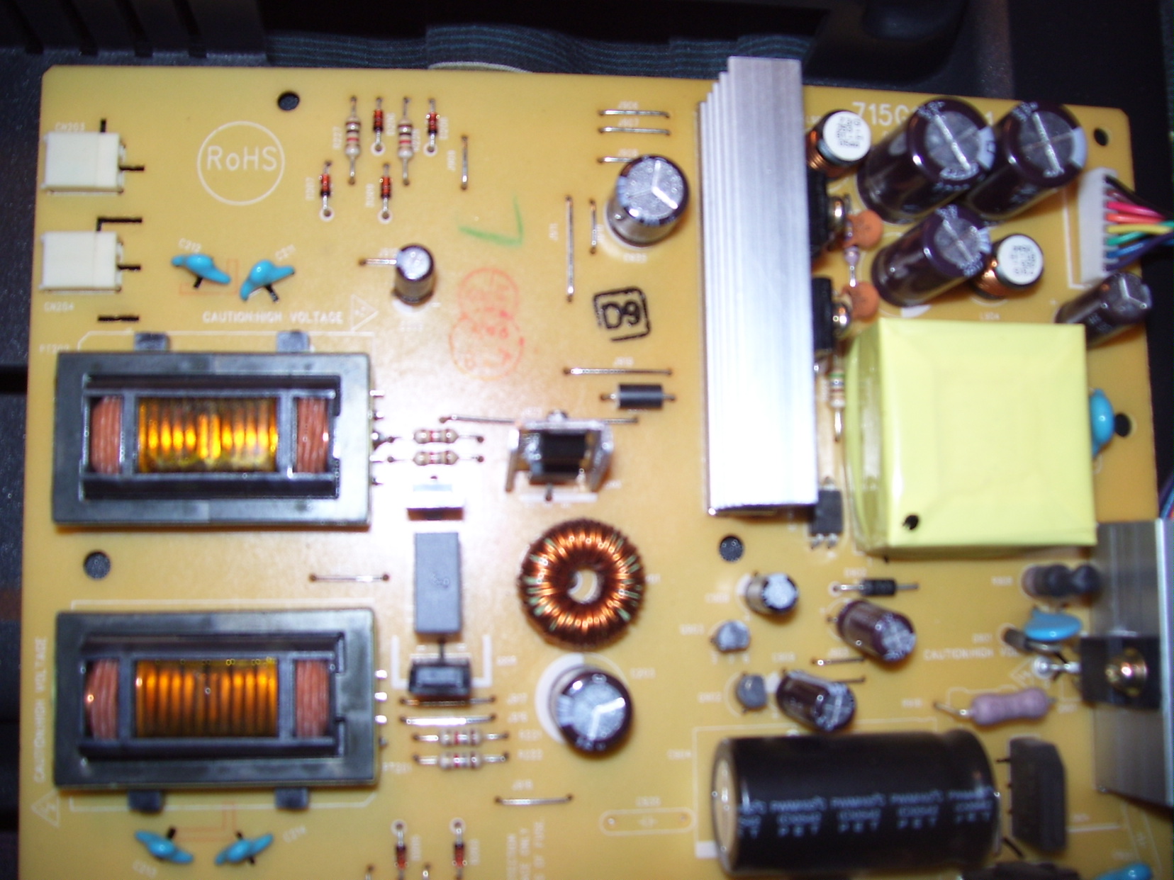

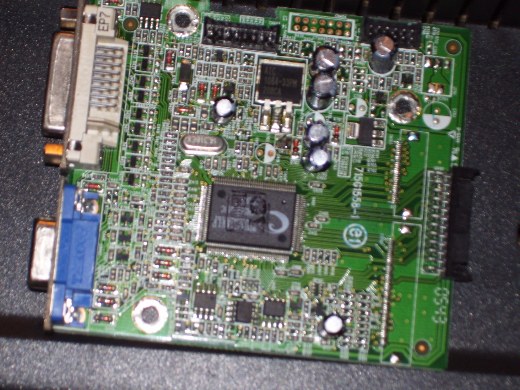

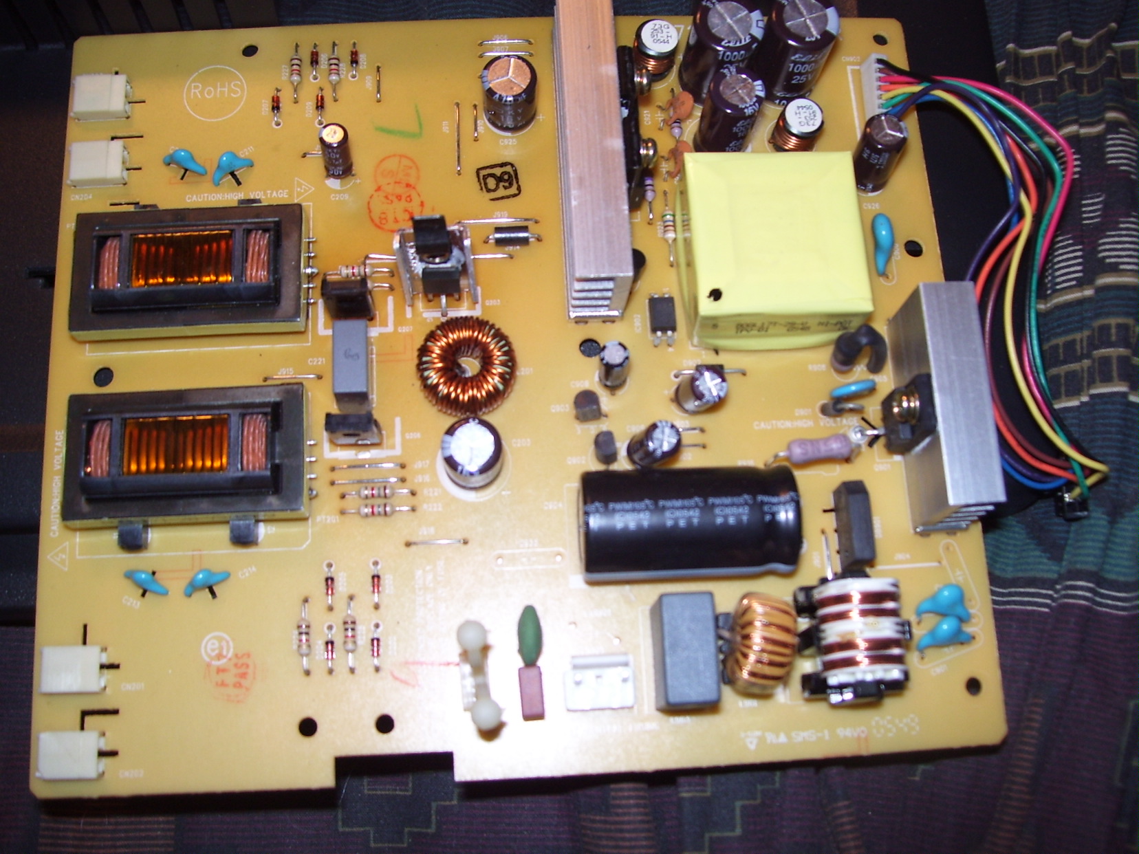

Acer LCD monitor which are very dead
    replied
    Re: Acer LCD monitor which are very dead
    Here is some photos
    on the control board next the 2 cap off to one side you will see the fryed transistor
    on the power on both board the transistors Q902 and Q903 are discolored
    Last edited by sam_sam_sam; 07-02-2011, 07:55 PM.
    Leave a comment:
    started a topic Acer LCD monitor which are very dead
    Acer LCD monitor which are very dead
    I have two Acer LCD monitor which are very dead nothing no led no image
    I do not see any bad caps I have not found any bad parts one of the monitor
    How ever there a few spot are mark where allot of heat has been at one time
    The other monitor has Sims transistor that pop so I know that board is bad
    any idea on the one that dose not seem to have any bad parts what could be wrong with it
    The model is # AL1716
    Date code 12/2005
    they are the same model #
    Thanks for any info you can give me
    I have fix one LCD moniter and one LCD tv already that had bad caps in them
    and one router and five switching power supplys Which work very well
    Last edited by sam_sam_sam; 07-02-2011, 07:48 PM.
    by momaka
    03-15-2023, 10:17 PM
  • maralexbar
    How to force Acer Aspire Series to bootup BIOS/UEFI on external Monitor?
    by maralexbar
    I ask this question in general as there are many Acer Aspire models with UEFI Insyde BIOS that do not boot to the BIOS on an external monitor (VGA, HDMI, etc) showing only the Internal LCD (LVDS, eDP etc).
    It's a pain to work on Acer notebooks with a broken screen and not being able to access the BIOS using an external monitor.
    If anyone knows how to force the external monitor as primary for Notebooks of those models
    11-02-2024, 09:18 AM
  • noah95
    Dead Acer AL 1916W Monitor
    by noah95
    Hello everyone, i have an old acer monitor "AL 1916W"
    it was totally dead but after i replace some bad caps now the led turns green and red when it's in sleep mode.
    but the picture at all no backlight or a dim picture in the LCD.
    i just wanted to know how can i test the backlight and the lcd or from where to measure the voltage going to the backlight or the lcd, to know if the problem in the psu or not.
    i did test most of the component there if there's a short but they seems fine.
    03-25-2022, 03:12 AM
  • bripoll
    Acer Veriton N4670GT Dead
    by bripoll
    Hello, I have an Acer veriton n4670GT that, due to a fall to the ground, only started if I did a BIOS reset.
    The power button ar ok, and when power off windows, then if press power button, this power on, but goes to boot loop, like press power button forever
    It crossed my mind to try a BIOS update and when I finished it turned off and no longer starts in any way.
    I have a flash programmer, but the file you download from the Acer website has a .CAP extension, it is not a .BIN
    I have programmed it, but it still won't start, it is dead
    Before programming...
    11-23-2023, 02:56 PM
    09-06-2024, 05:27 AM
