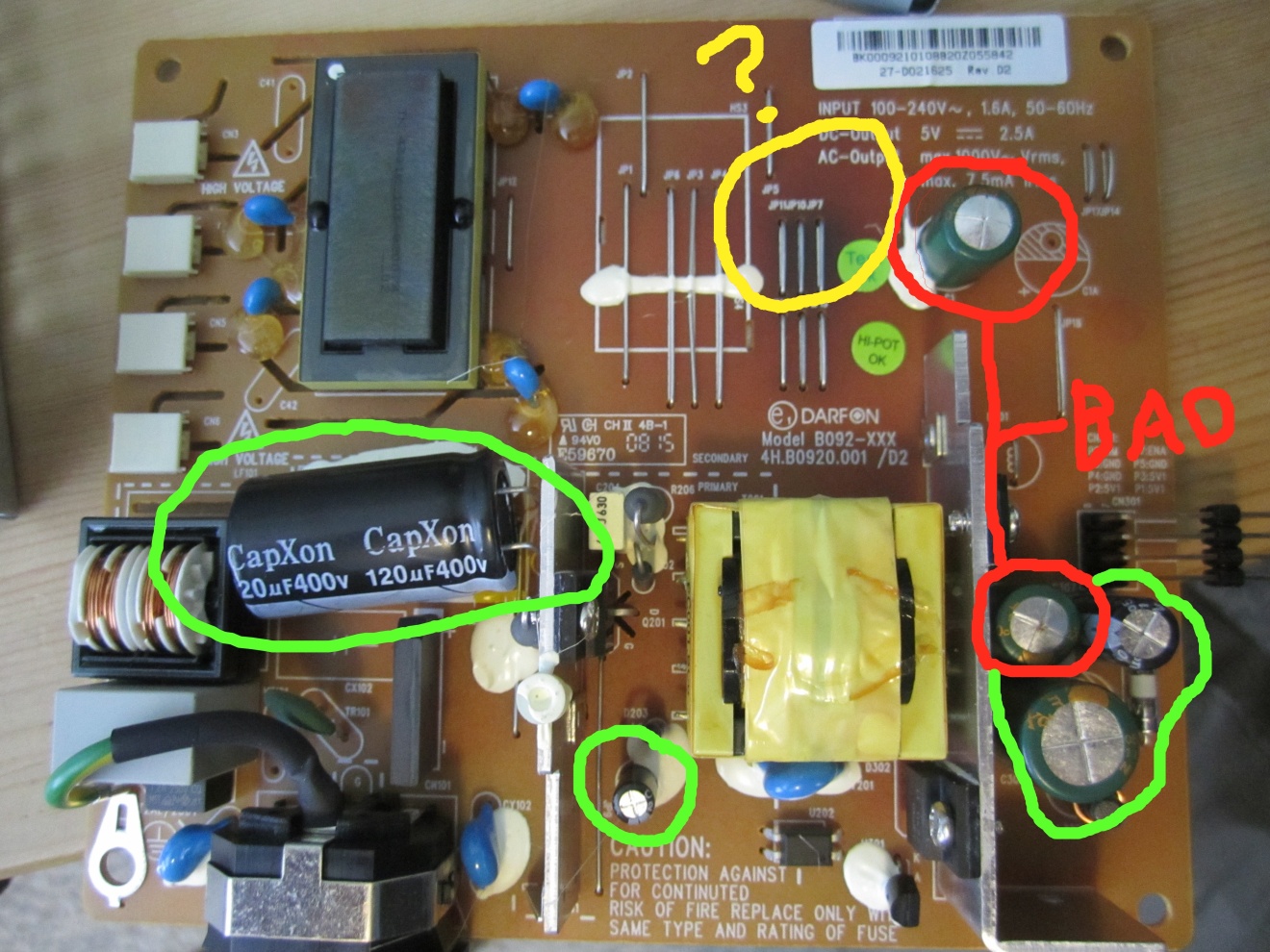

    Hi, I have a vx1962wm.
    It turns on for a few seconds, then goes black; the power light stays blue. I can turn it off and then back on, and the picture will reappear for a few seconds again, then go black again.
    There is a high pitched electrical sound from it when it is on and the picture is showing, the sound dies when the picture dies.

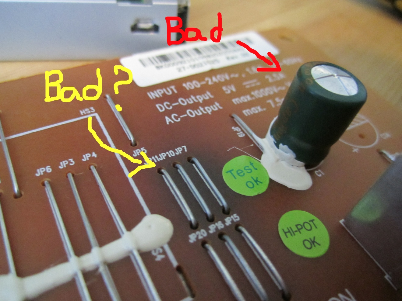

    I have read some threads here and it seems that I am another victim of CapXon. Two of the caps seem to be bad, the other 4 look good, including the big filter cap.

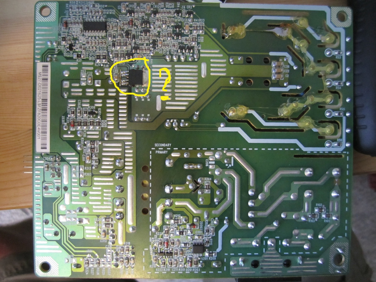

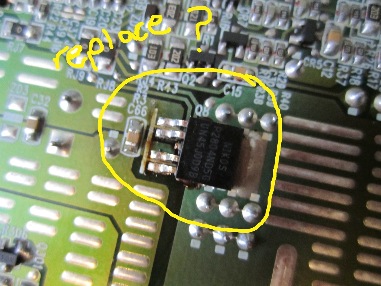

    However, there is also a dark area on the board with a part behind it. I don't know what it is. The model is:
    "NIKOS
    P2804ND5G
    UN45J0D9B"
    it sorta looks like it could be burned out, but I can't tell for sure.
    Obviously I should replace the busted caps with better ones.
    But my question to you is: should I replace ALL the caps, and should I replace the little doohickey on the back of the board (the NIKOS thingie)?

    Yes, two caps are definitely bad. However, with the exception of the large 400V cap, all five of the smaller ones should be replaced. Use Panasonic FM or FC caps available from digikey.com. Replace caps first, before anything else.
    The dark spot you see is generated by the Nikos p2804 mosfet. Since it is soldered directly to the circuit board and generates a lot of heat, it will discolor the board over time.

      So, do you think that mosfet is working properly? Is it supposed to discolor the board?
        You can see the screen for a few seconds when you turn it on, so yes, it should be working fine.
        No.
        But I think that's just bad design on Viewsonic's part or whoever manufactured the power supply. There just needs to be more cooling in that area. The ripple from the bad CapXon caps probably also contributed to the problem.

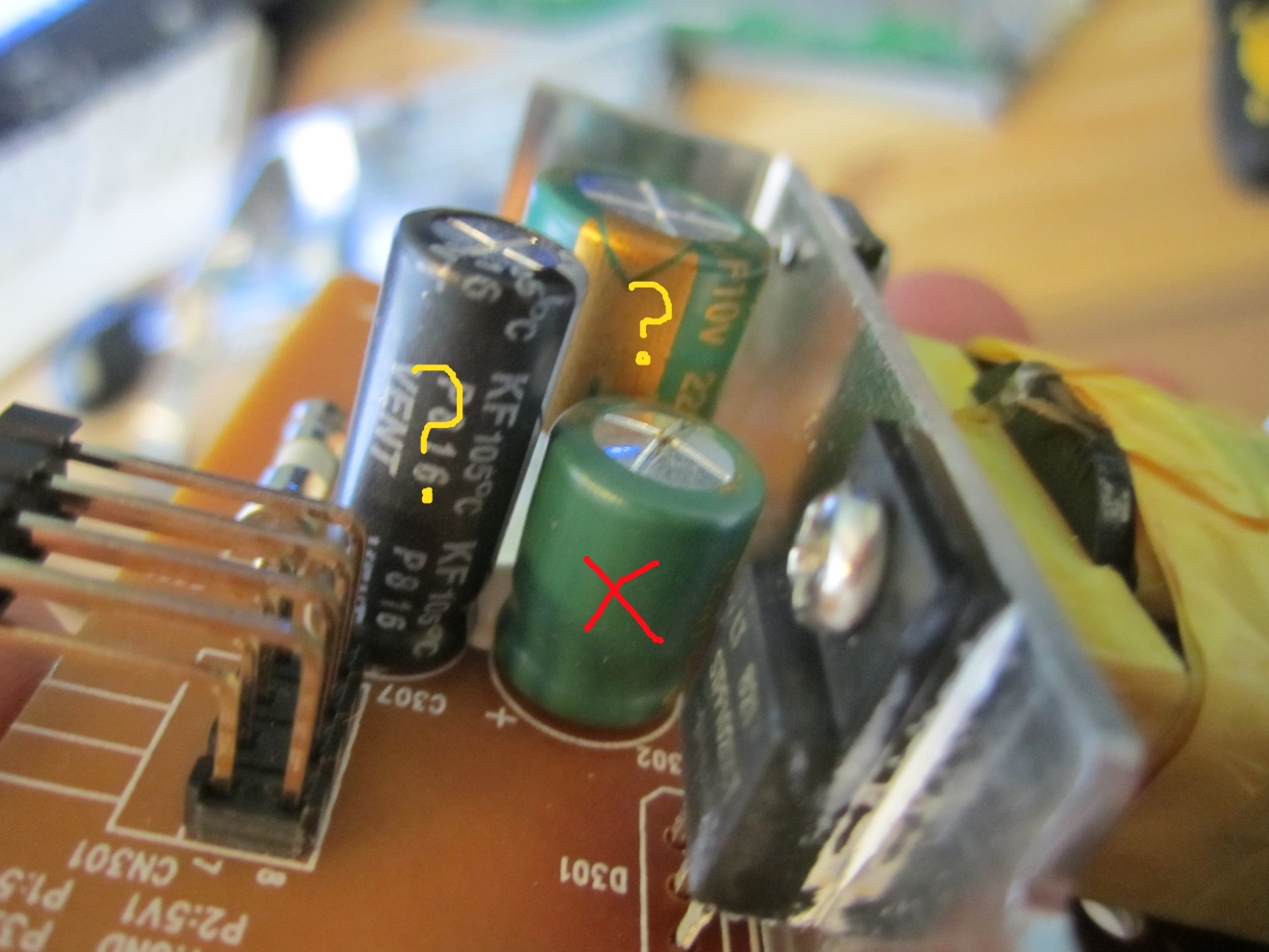

        Which series of CapXon caps do you have? I can see the black one next to the video/logic board connector is KM series.
        CapXon KM can be replaced with United Chemicon KY and Nichicon HE series. United Chemicon KZE, Rubycon ZL, and Panasonic FR and FM should also work fine.
          Re: Viewsonic VX1962wm, I think it just needs caps, need confirmation
          The green ones are GF series and the black ones are KF series. I notice 2 different types of caps on digikey that seem to fit the specs of these: ones that look very similar to these, and shorter, fatter silvery ones. are those better/worse/different at all?
          Also, what's a good way to disengage the caps from the white glue/cement stuff that seems to be everywhere?
          You mention six different models that should work well, does it matter which ones I get, or are they all good?
          Are the only specs I need to worry about the voltage and capacity? or do I need to match up the ohms and ripple and variance and color and whatnot?

            The glue can usually be pried off with a fingernail. Just give it time to yield.
            I prefer Panasonic FM FR, and FC. The other brands / series are also good.
            I wrote this procedure for selecting caps. Of course, you can substitute other series simply by changing 'FM' to whatever series you are interested in.
            Primary requirements are capacitance and voltage. Height and diameter are also important, so check the dimensions of the proposed replacement. It's REALLY embarrassing when you can't get the back on.

                So, this is what I have so far:
                Caps to replace:
                1. CapXon gf 220 uf 35v 1060 ripple 10x12.5mm
                2. CapXon gf 220 uf 35v 1060 ripple 10x12.5mm
                3. capXon gf 2200 uf 10v 1890 ripple 13x20mm
                4. CapXon kf 1000 uf 10v 1040 ripple? 8x20mm
                5. CapXon kf 22uf 50v 220 ripple 5x11mm
                KF datasheet
                GF datasheet
                I couldn't find the exact cap for #4, so I went with the closest one, does that ripple current sound right?
                I'm planning on replacing them with: (digi-key part numbers)
                1 and 2: P12411-ND
                3: 565-1650-ND
                4: P12354-ND
                5: P12927-ND
                I think I matched them up right, but I would really like a second opinion especially from someone who knows what the heck they are doing.
                Also, why doesn't the huge capacitor need to be changed?
                Thanks!

                  1 and 2: P12411-ND - Check, good
                  3: 565-1650-ND - Check, good
                  4: P12354-ND - Check, good
                  5: P12927-ND - Check, good
                  These caps handle relatively high current pulses (> 1 amp) at a frequency of (I believe) around 70 KHz. The mains filter cap handles current pulses of less than 1 amp at a frequency of 120 Hz. Each of these pulses generates heat. Because of it's larger physical size and location, the mains filter cap can more easily shed the heat generated, so it doesn't cook itself to death.

                      Thank you all so much for your superb help. I now know much more about capacitors and related stuff. I've ordered the caps, so they should be here thursday or so, then I'll put them in.
                      Thanks again!
                        Put the new caps in, and I'm writing this to you on my good-as-new screen! Thanks for all the help guys, I love you!

                          I would also like to replace the nikos p2804nd5g mosfet while I'm at it, is there any US source for purchasing just one or could you recommend a substitute.
                          Joe
                            It says earlier in the thread to replace all 5 small caps?
                            and you only need replace the Nikos if after doing that you dont get any screen flash.
