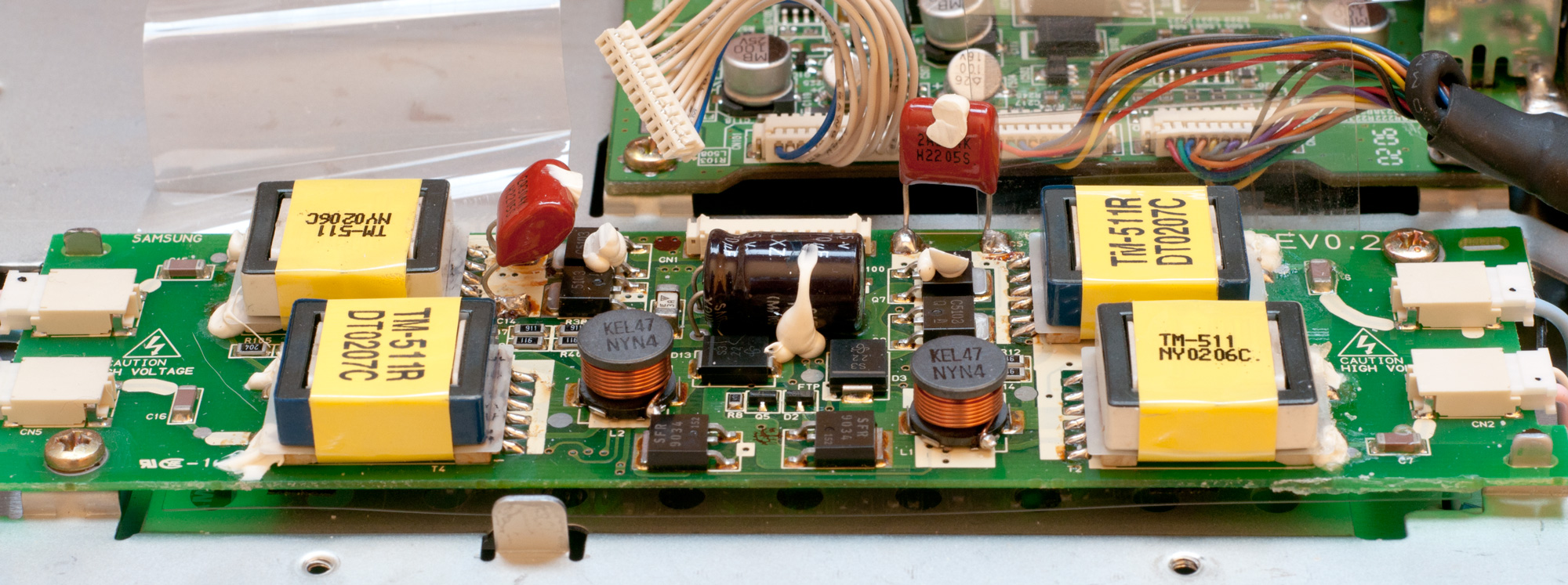

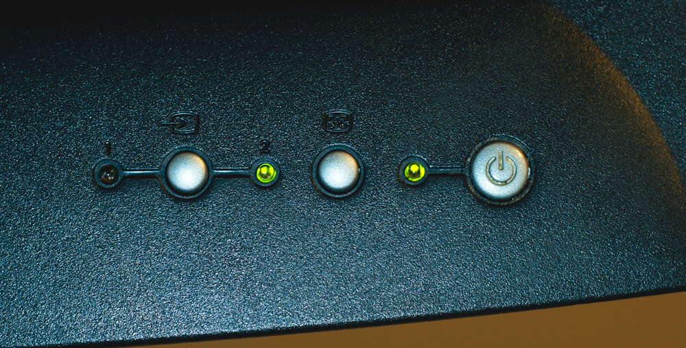

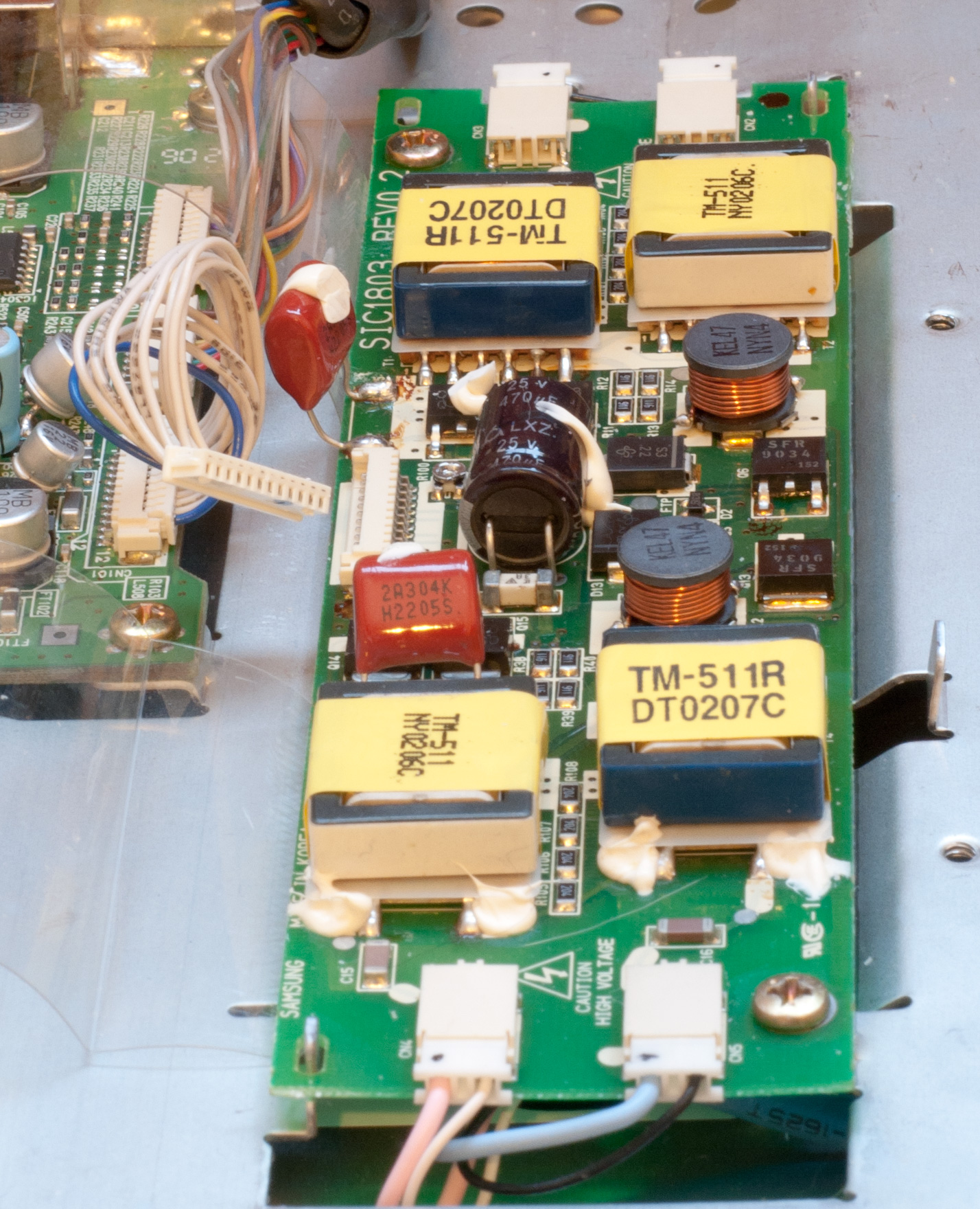

    I have searched this forum and the internet for hours trying to find my solution. Since I can't find anything I thought I'd post here since there seems to be a lot of very smart and helpful people.
    I have a Dell 1702FP that won't turn on. It has the same flashing light pattern as monitor in this video: http://www.youtube.com/watch?v=vUmX2E6bzf4. I found a post on Instructables.com here: http://www.instructables.com/id/FREE...y-Dell-1702FP/ that said to replace the capacitors. I replaced the two recommended ones and it didn't work. I went out and bought a multimeter that tests capacitance and all the capacitors have tested ok. After that I looked around the board and found that there seems to be damage on the Samsung SIC1803 board. Does anyone have any idea what I can replace the brown (I think they are capacitors) pieces with? Do you think that is the problem? Can I test anything else?
    Any help is appreciated. I'm very new at this but I'd love to fix my monitor if possible.
    Thanks!

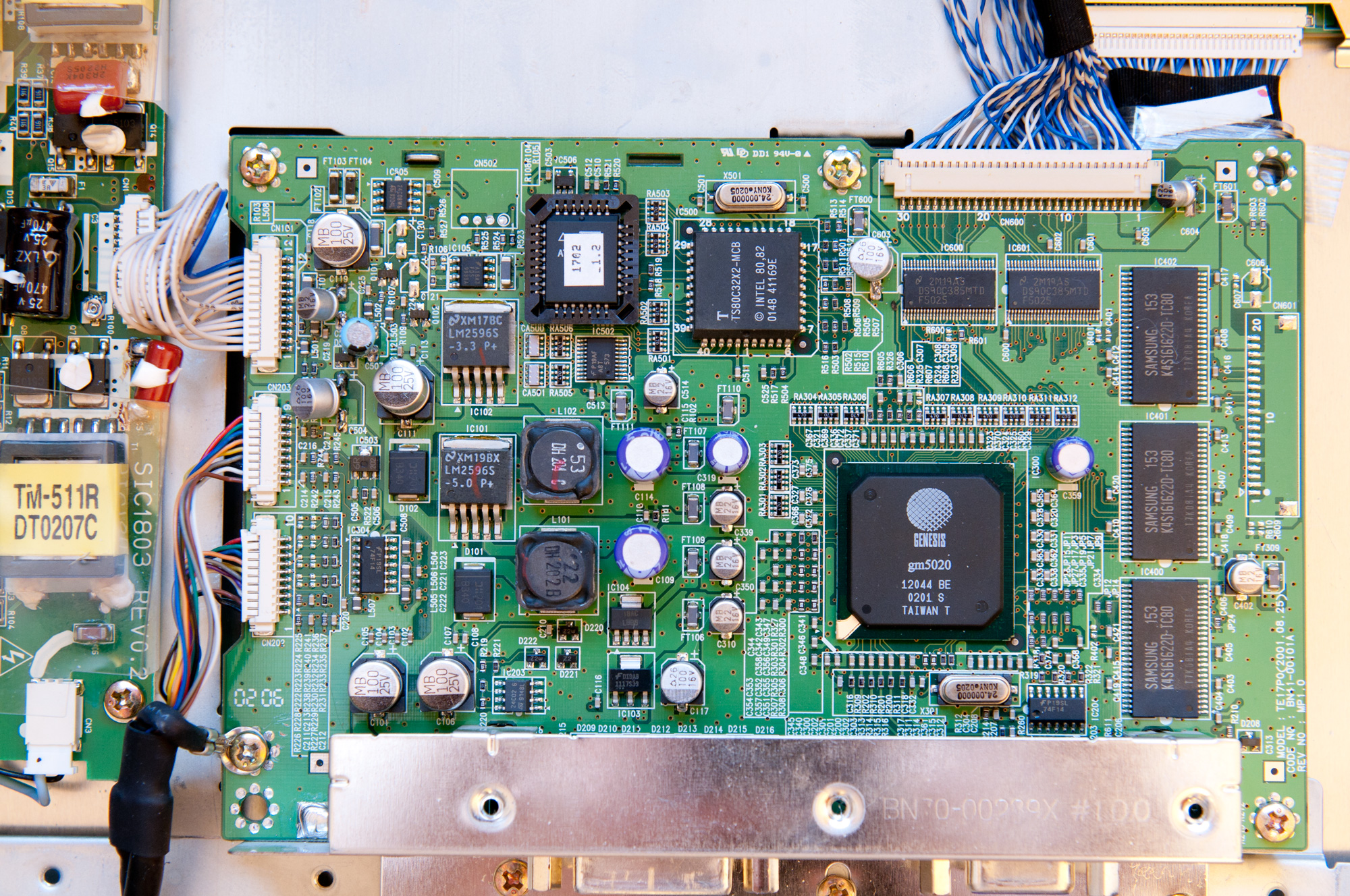

    1) Please post pictures of your power and logic board (like your excellent clear focused inverter board one).
    If your power LED is not on solid green, this could be bad caps causing unstable power (probably 5V DC) to the logic board. Or there is something wrong on the logic board.
    Either way, post the pictures and we can suggest test points.
    2) Did cap C5 look like that? That is, off the board?

      Re: Dell 1702FP won't power on (lights just flash)

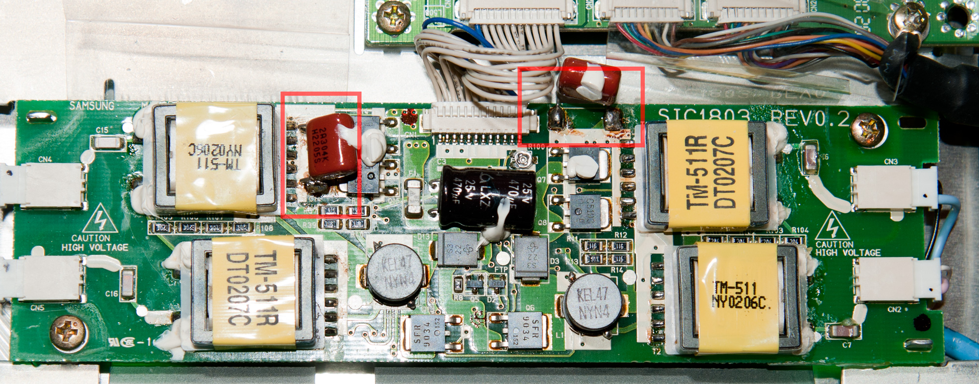

      One quick test you can do is unplug the cable that's connected to CN1 (do this with the monitor unplugged ). If the monitor power LED now works normally (of course you won't see anything on the display) the inverter is the cause.
      NOW it looks like C5 may be damaged; it's kind of hard to tell. If that is the case, and the monitor responded as I described with the inverter disconnected, the odds are Q7 and / or Q8 are shorted.

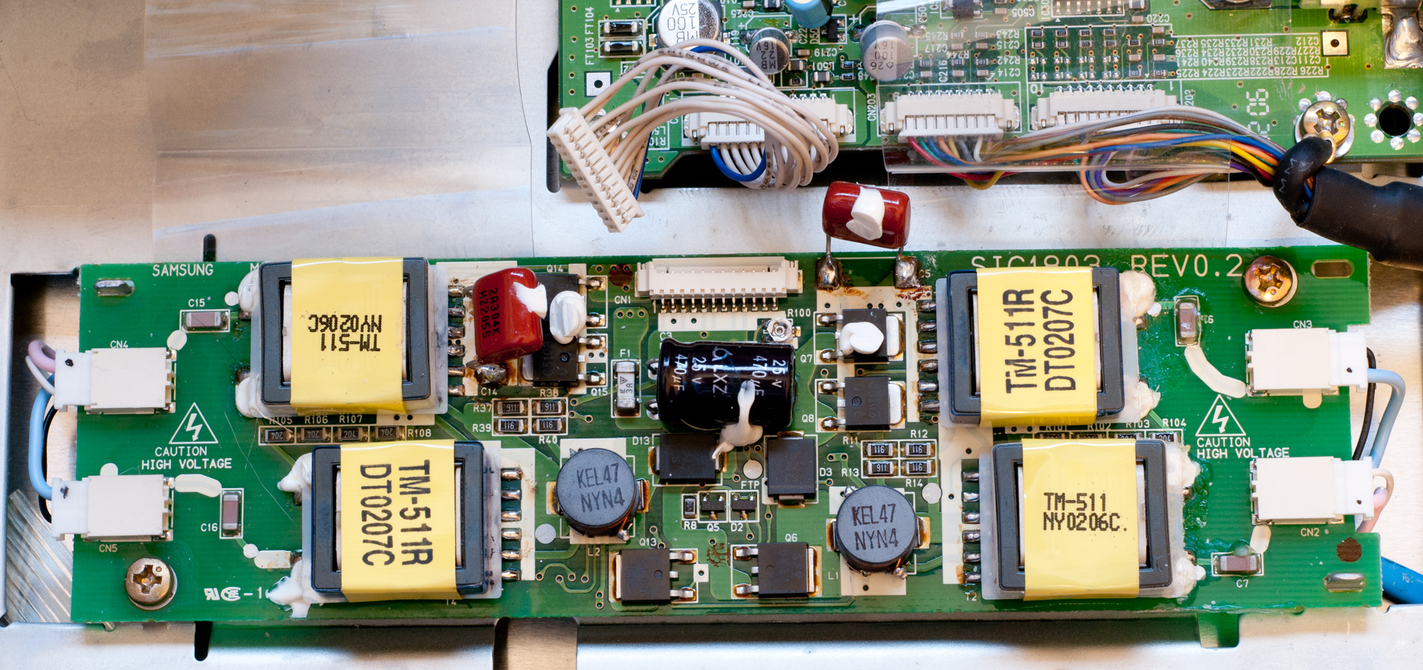

        Thank you both for the quick replies! I really appreciate the help. I have been getting pretty frustrated with my lack of knowledge and understanding I was just about to give up. I have hope again!
        Retiredcaps,
        1) I have attached two more pictures of what I hope are the logic board. I was hoping you wouldn't ask for them because it will show my very poor soldering. I read online that to test capacitors with a capacitance meter you need to remove one of the connections from the board. So when you see lopsided, poorly soldered capacitors that's what happened to them. All the ones I tested, tested fine though.
        2) No C5 was not off the board like that. I cut the adhesive in an attempt to see the capacitance rating so I could replace it. I couldn't find anything except the same cryptic numbers on the other side though. It did have that brown looking residue around it before I touched it.
        PlainBill,
        Thank you very much for the suggestion. I removed the CN1 connection and the lights are now staying solid green instead of flashing as they were in that video. I have posted a picture of the lights in case it's relevant.
        Ok, so from those results it appears it is something in the inverter that is the problem. This may seem like a stupid question but what are Q7 and Q8? Is there any way I can test if they are shorted? If so do I need to remove them from the board? I have uploaded a few more pictures of the inverter from different angles if that helps at all.
        Thanks again to both of you for all your help!! Hopefully I can get this up and running again.

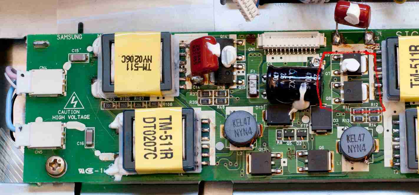

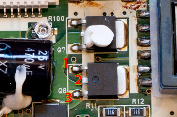

          Q7 and Q8 are PCB designations. See attached pic and what is circled in red.
          To test Q7 and Q8, you can do this "in circuit" (no need to desolder) by following the instructions at section 2
          https://www.badcaps.net/forum/showpo...0&postcount=13
          Report your findings.
          PS. You might as well test Q14 and Q15 at the same time and report those findings as well.

                The sequence goes like this: The power supply comes up, the controller on the signal card turns on the power LED and the backlights. Because the inverter has a short, this overloads the power supply, which shuts down. The controller no longer is trying to turn on the inverter, so the power supply comes back up, the lights come back on, etc.
                This is one of those 'clever' designs where the fuse rating is much higher than the power supply can provide.

                  Well, I tested the mosfets as suggested and I have posted my results below. I wasn't exactly sure what the pin order was so hopefully I did it correctly. I have attached an image to clarify what pin order I used. Also, I couldn't figure out how to set my multimeter to 200 ohms. I looked in the manual and online but it seems I could only set the scale (M, k or just ohms). Hopefully that will be ok. All the mosfets have the same identification on them (“C5103” and “Q A” on the next line) so it appears than two of them are defective (just as retiredcaps suspected).
                  Q7 Test
                  a) black on pin 1- red on pin 2 - .456 k ohms
                  b) black on pin 1- red on pin 3 – 1.261 k ohms
                  c) black on pin 2- red on pin 3 – .729 k ohms
                  Q8 Test
                  b) black on pin 1- red on pin 3 – 1.257 k ohms
                  c) black on pin 2- red on pin 3 – .726 k ohms
                  Q14 Test
                  a) black on pin 1- red on pin 2 - .457 k ohms
                  b) black on pin 1- red on pin 3 - .457 k ohms
                  c) black on pin 2- red on pin 3 - .5 ohms
                  Q15 Test
                  I also tested the fuse and here is the result:
                  F1 Test
                  .4 ohms
                  So now I have a few more questions. Which mosfets are the defective ones. Can they be replaced and if so what part should I replace them with? Should I test/replace anything else before I replace the mosfets?
                  Thanks again for all the help!

                    You did well. Q14 and Q15 are shorted collector-emitter. They are available from Digi-Key as 2SC5103TLQCT-ND for $1.14 each. They only have about 8400 on hand.
                    Before placing any orders, there are a few more things to test. Directly below C3 you have D3 and D13; and below them are Q6 and Q13. Check the resistance across D3 and D13. Also check all three combinations of the leads of Q6 and Q13 just like you tested Q14 and Q15.

                      Remove Q14 and Q15 (desolder them from the board) and retest pin 2 to 3 to verify. If they are indeed bad, you have to remove them anyway for the replacements.
                      If you can't set your multimeter to 200 ohms, you probably have an auto-ranging multimeter.

                                  Great thanks for the help. I will try replacing the diode. I'll post back the results.
                                  Thanks again!
