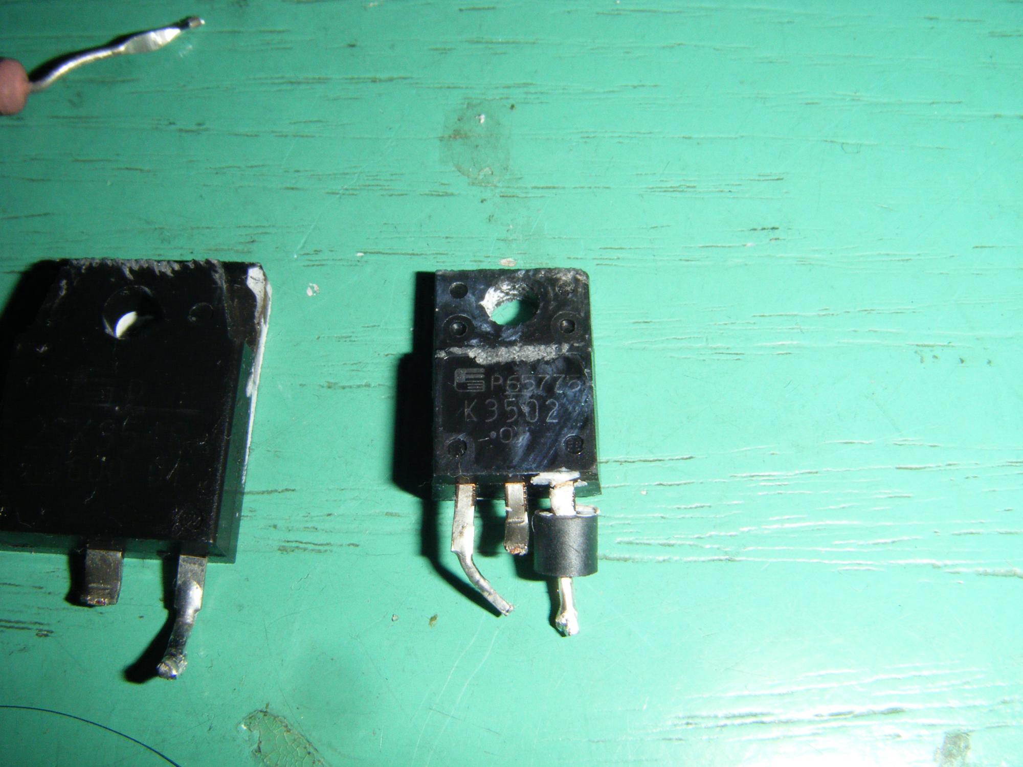

    Model : Dell 2407wfp

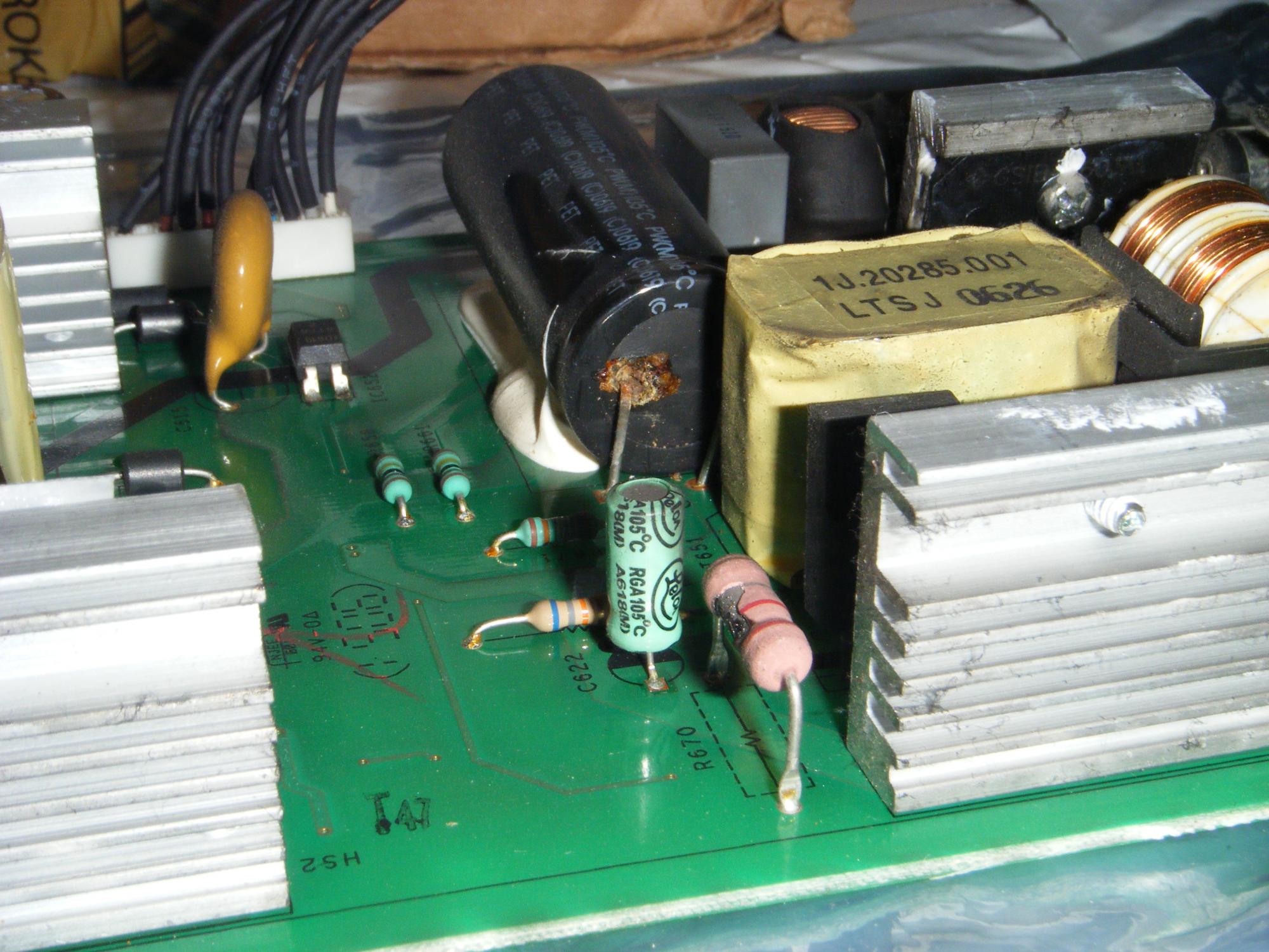

    Failure : No power LED. Owner claimed that upon switching ON the Power switch a Pop sound was heard + burning smell coming out of monitor.

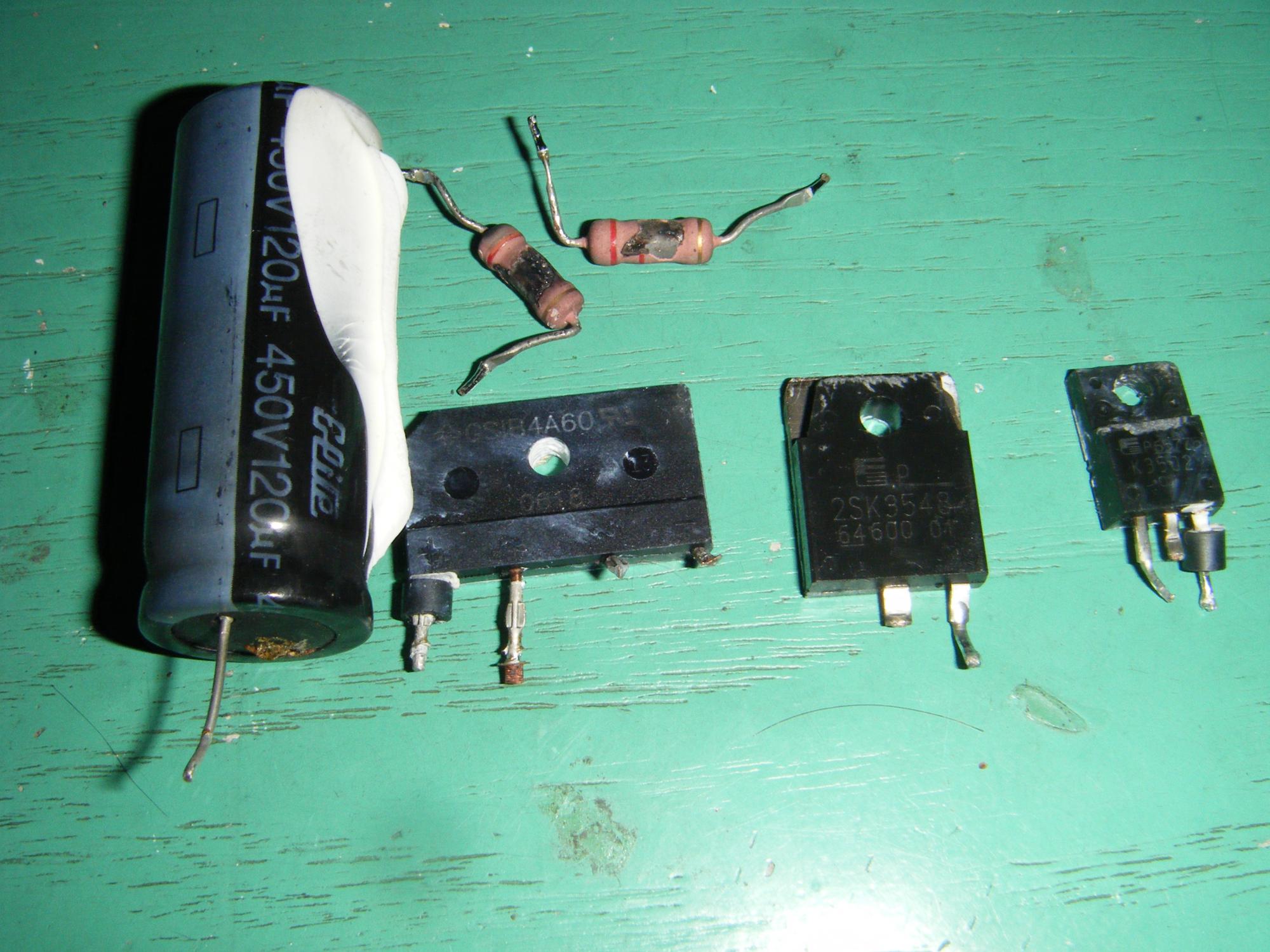

    Dissambled it and I can see that one of the leg of the Big cap is almost/already broken. 2 pink resistors got burnt. Proceed to measure some of the components & found out that
    1) Main Fuse open
    2) Bridge rectifier shorted
    3) Transistor Q601 shorted
    3) Transistor Q651 shorted
    So now i am needing the experts here to identify what is Q651. Marking on it is K3502 P65775(Fuji?). Also are there any other replacement option parts for the Bridge rectifier (Marking GSIB4A60) & Transistor Q601 (Marking 2SK3548)?
    For Transistor Q601 (Marking 2SK3548) I could only find 2SK3549 but I am not sure whether it is compatible.
    Thanks in advance, Guys!

    The bridge is easy,data sheet attached ,lots of similar ones about from many different manufacturers.Ensure the pin spacing is correct as shown before ordering.
    http://pdf1.alldatasheet.com/datashe.../GSIB4A60.html

      The K3502 is probably this :-
      http://pdf1.alldatasheet.com/datashe...I/2SK3502.html

        Thanks Rtech. Appreciate your lightning quick respond.
        I will check for the identical replacement parts. Just incase I couldn't find them, are there any other alternative replacement that you know of to replace them?

          Read immediately under "Commonly failed components"
          http://webdevsys.com/d530psuRepairNotes.htm
          And of course verify the cross reference is correct.....

            Found this but it's not in a real datasheet..........
            http://www.200ic.com/stock/Suppliers-2SK3548.html
            2SK3548 Datasheet:

              PCBONEZ, thank you. Appreciate it.
              From yours & Rtech's help, i am now going to place order on the parts to replace them. Hopefully no other components are failing or are 'walking wounded'. Lets see how it goes when the parts arrive.
