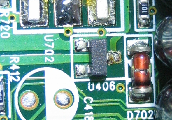

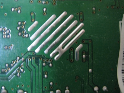

            Re: viewsonic vg720 no power, blown transistor on mainboard
            Managed to open it.
            The U406 doesn't seem burned from the outside (not that I can check it's fine or not).
            Also there's something that seems odd to me on the other side of the board. There's a connexion between two rows like it has melted. But maybe it's the way it's supposed to be.
            Here are the pictures (what would we do without pictures).
              Originally posted by edo
              Managed to open it.
              Use a DMM to measure the voltage on each of the pins. Use one of the screws holding the board in place as the ground point. That will tell us if it's working or not.
              The solder blob on the second picture is normal.
                You may not be that good but you certainly are that helpful. In no way could I have found by myself the solder blob was normal, as I'm absolutely not familiar with electronic terms and therefore lost with any related web search. Thanks for that information.
                I have no measurement tool neither the means to get one (back in a hurry from Japan, I just assembled a computer with parts from people's donations ) so I will try to remove the U406 and see if that solve the problem. I suppose melting the three solders with a hot screw driver is better than cutting them with a wire cutter. Sounds a bit Macgyverish but I'm very short on tools and need this screen to get power again.
                • edo
                  • Jun 2011
                  • 4
                  It worked ! Thank you very much for the advice. My first guess was the solder blob would have been the problem as the U406 seemed OK from the outside. You prevented me from removing the blob and that saved my screen !

                                          #40
                                          Thank you, the service manual was very helpful for getting the case off.
                                          U406 was fried, so I carefully removed it. Leaving the circuit open, or shorting pin runs 1 and 2 did not allow the power LED to come on, so I'm studying the schematics now. I'm finding 5V and 12V all over the place, so now focusing primarily on the board where U406 was originally mounted.
