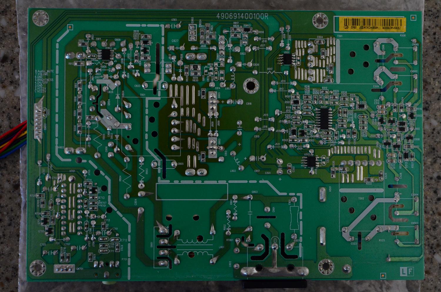

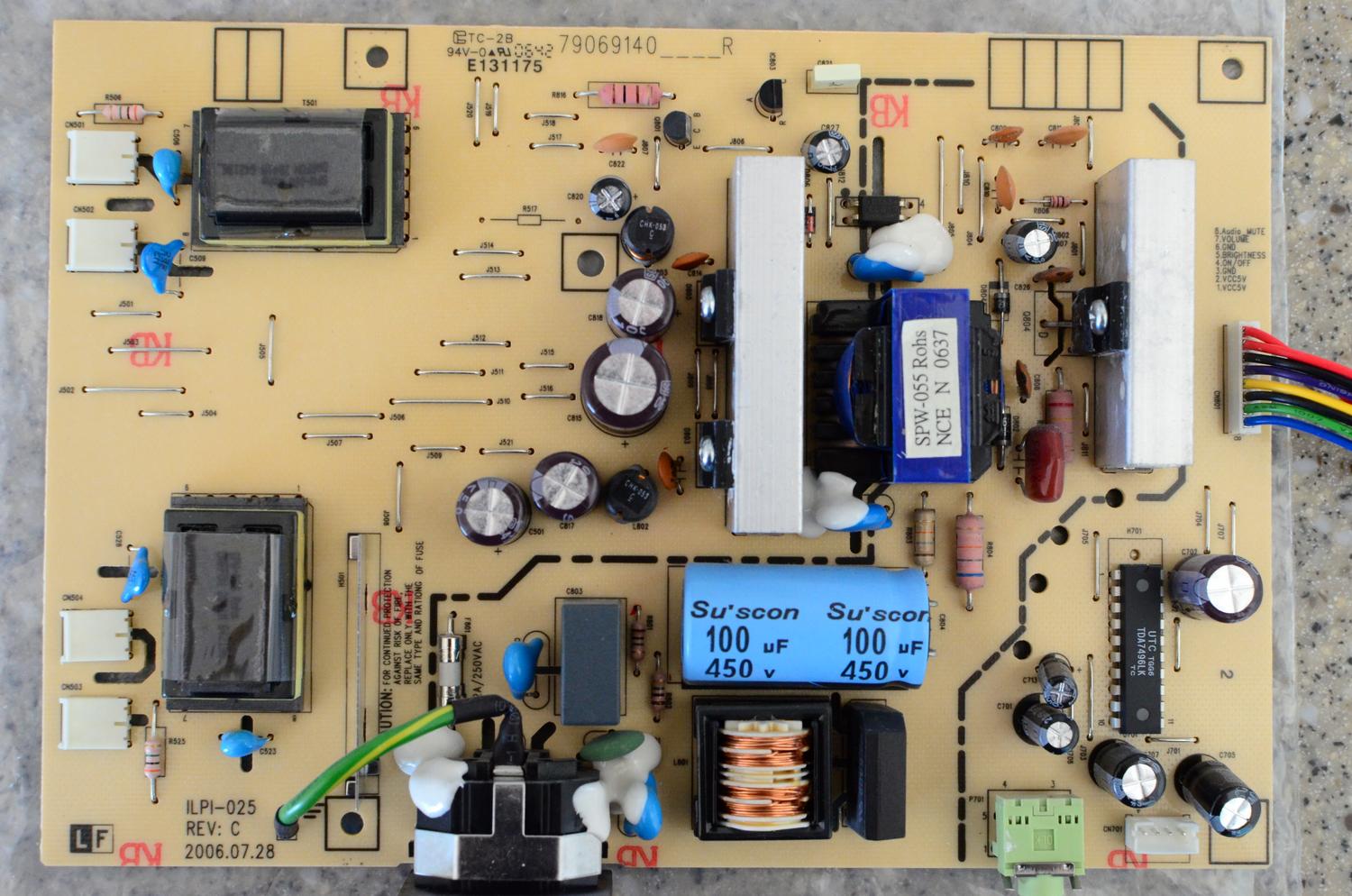

    The unit will not power on. No screen activity, no power LED, no noises, nothing. I have disassembled it and done some very basic troubleshooting. I tested the power switch and the fuse on the power board. The caps all look ok, no bulging or leaking. No funny smells from the power supply board. I didn't see any bad solder joints. I have not looked at the other PCB.
    Attached are two pics, front and back of the power board. I have _very_ limited experience repairing electronics, a cheapo multimeter, and a soldering iron. My experience with bad caps is replacing the visibly leaky ones. I have no experience with "testing" them. Anyone have suggestions for what I do next? Thanks!

    1) On CN801, measure DC voltage on each of the 8 pins with respect to ground. You can use a ground screw for your ground (black probe). Report DC voltages for each pin.
    If you have a manual multimeter, set it to 20V DC.
    2) If no DC voltages are present (they all read 0.0V DC), then CAREFULLY measure the voltage across the blue Su'scon large capacitor. Put your multmeter on 200V DC and put your black probe to the negative leg and your red probe to the positive leg.
    If you live in North Amercia, you should get around 165V DC.

      Thanks for the quick reply! I tested the voltages at CN801 as you instructed. Here are my findings:
      1 - 5.18 V
      2 - 5.18 V
      3 - 0.00 V
      4 - 0.08 V
      5 - 0.04 V
      6 - 0.00 V
      7 - 0.72 V
      8 - 0.68 V
      I had previously measured the large 100uF 450V cap. Tested again and it still reads 168.1 V. I am indeed in the US.
      Thanks again for your help!

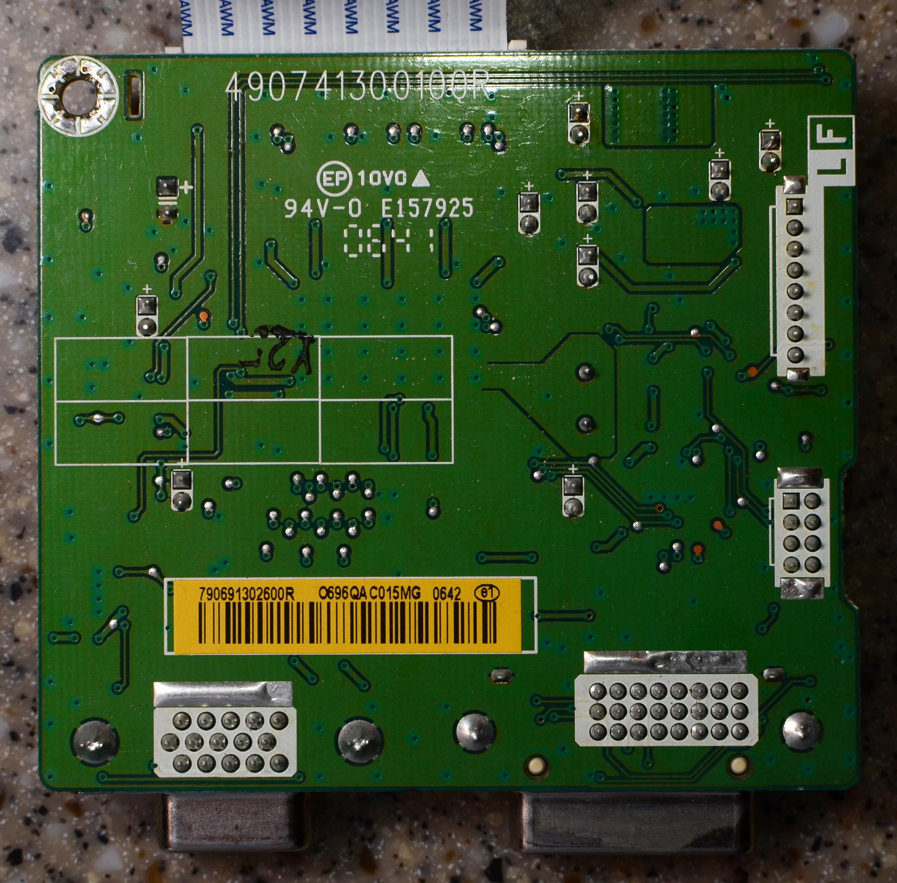

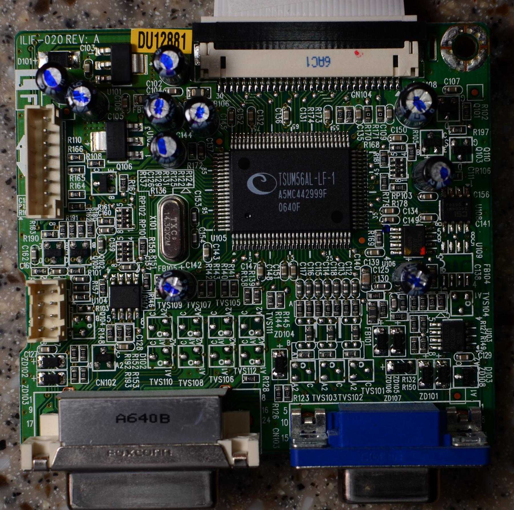

            I removed and photographed the logic board on both sides. It is labeled "ILIF-020 Rev. A". There are several caps on the logic board, none bulging or leaking, and no other immediately visible faults that I can see.
            Looking forward to your advice on points to test on the logic board. Thanks again!

              In the upper left of your logic board, try checking the voltages on voltage regulators U101 and U102. Leg numbers are silkscreened on board for each regulator. Measure and report voltage on each leg.

                I set my multimeter to "20" on the DCV scale and checked the three legs each of U101 and U102 on the logic board:
                U101
                1 - 0.00 V
                2 - 1.25 V
                3 - 4.89 V
                U102
                1 - 0.00 V
                2 - 0.41 V
                3 - 1.25 V
                Thanks!

                  Hmmm....I'm thinking that U101 may be bad. What's the part number of U101 and U102? The part number is usually followed by a dash and two-digit number like 18,33,etc. This number is the output voltage, ie, 33=3.3V

                    U101 reads:
                    A1
                    AS1117L-33
                    80630 14
                    U102 reads:
                    A1
                    AS1117L-18
                    80630 87
                    So, U101 is 3.3V and U102 is 1.8V?

                      Correct. From your previous measurement the output of U101, pin 2, was 1.25V. This output is fed to the input of U102, pin 3. Since the output of U101 is bad, then it also affects the output of U102. Replace U101. Also consider replacing U102, since we cannot determine whether it's good or bad at this point. These regulators are very cheap and are available at digikey.com.

                              I received my replacement U101 and U102 voltage regulators from DigiKey today. I managed to remove and replace U101 as suggested by jetadm123. I was too eager to test the repair, so I did not replace U102 in the hopes that it was still okay. I put the essentials back together and plugged it into my PC. It fired right up and looks great, especially considering the price!
