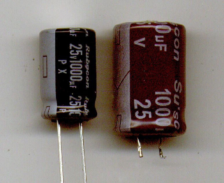

    • bw1
      • Sep 2010
      • 172
      Re: Use a higher voltage cap?
      That brings up another point in the article - size. Not a good idea to replace the smaller one with the bigger one, even though the cap/volt ratings are the same?

        • bw1
          • Sep 2010
          • 172
          Well in the example above, all I've got is the smaller one, and the bigger one is the one that was original. What's the best way to tell what to replace this one with? Normally, as long as the shape is pretty much the same and values on the side match, I just go with it, but when there's an obvious size difference, I'm less likely to do so.
          As far as I can tell, the [1000uF 25v 12.5mm ZLG Series] (Rubycon stock link @ badcaps) is what I would really need.
          Should I spend the extra and order that (nothing else needed at the moment, so would be a bigger order for a couple caps) or use the smaller one?
          • retiredcaps
            • Apr 2010
            • 9271
            Before you posted this, I re-read and edited my reply above.
            The only reason go from Rubycon PX to ZLG is because the electrical application require a low ESR cap like ZLG. PX is not a low ESR cap regardless of it is physical size. See
            https://www.badcaps.net/forum/showthread.php?t=2280
            So if these caps are part of your power board lcd monitor (i.e. an SMPS application), then you should get the ZLG since it is low ESR.

            • PlainBill
              • Feb 2009
              • 7034
              The parameters I use (and my target values) are capacitance (exact match unless several are in parallel, then try to achieve the same total capacitance), voltage (exact match, higher if necessary), dimensions (must fit in available space), ESR (lower is better), life expectancy (higher is better). If the information is available, I will use the ESR of the original as a 'not greater than' target.
              If the original was a 2200uF 25V and I have a 2200uF, 35V Panasonic FC on hand I'll use it if it fits. If I'd have to wedge it in, I'll get a proper replacement rather than turn out something sloppy.

              • bw1
                • Sep 2010
                • 172
                Well looking again I've got Samxon 1000uf/25v GT's, Rubycon 1000uf/25v PX's. The one I mentioned I would need to order is the ZLG series.
                Are you saying no PX's should go anywhere in a power supply board? Also, what about Samxon GT or GC.
                I know I've seen reference charts of ESR values for caps floating around here, but what about a reference for where each type is appropriate? That's what I'm never positive on.
                Also, I suppose, are there actual risks to using a higher ESR cap? Obviously, I'm the same way - I want the results the same or better as the original. I'm more curious than anything.

                  • PlainBill
                    • Feb 2009
                    • 7034
                    Note the link in my signature (above) - 'Which Caps should I buy?'. It takes you to a list of suitable series of caps in the FAQ. If they aren't on that list, don't use them in the power supply secondary. Note that you can recap most 15 - 23" monitors for under $10.00 including shipping.
                    PlainBill
