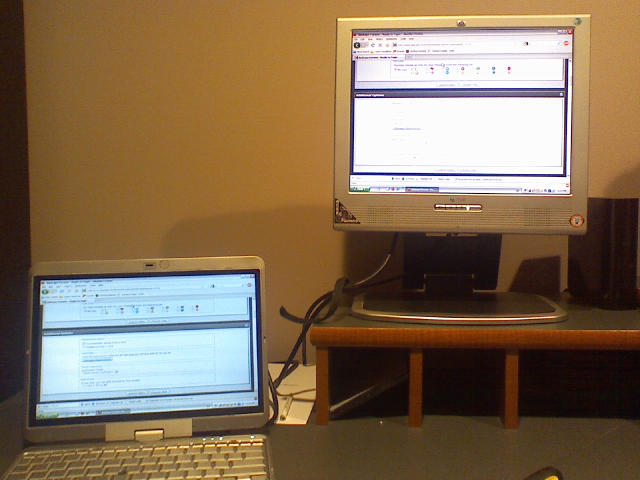

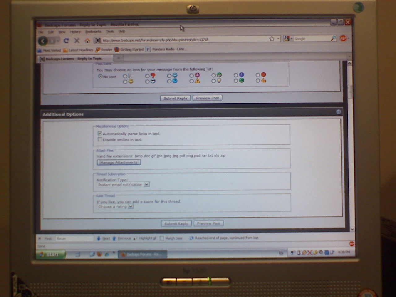

                                  #36
                                  Re: HP lcd L1502 15"
                                  Hello Everyone!
                                  Today I received my C5707 transistors. I went ahead and solderd them in and as you can see on the picture I am using my fixed and working monitor to post the update
                                  I changed only one set of C5707's and resoldered the other two. I also resoldered all the transformers. Hopefully this monitor will last me another few years
                                  I am a college student, so I try to save any way I can. I just wanted to say thank you to everyone who helped me fix my monitor (retiredcaps, plainbill, th3, kaboom, alexanna and steve2). I would not be able to do it without you guys. I have learned few things about electronics along the way. So thank you guys again!! You helped me save some money!
                                  sincerely,
                                  leo
