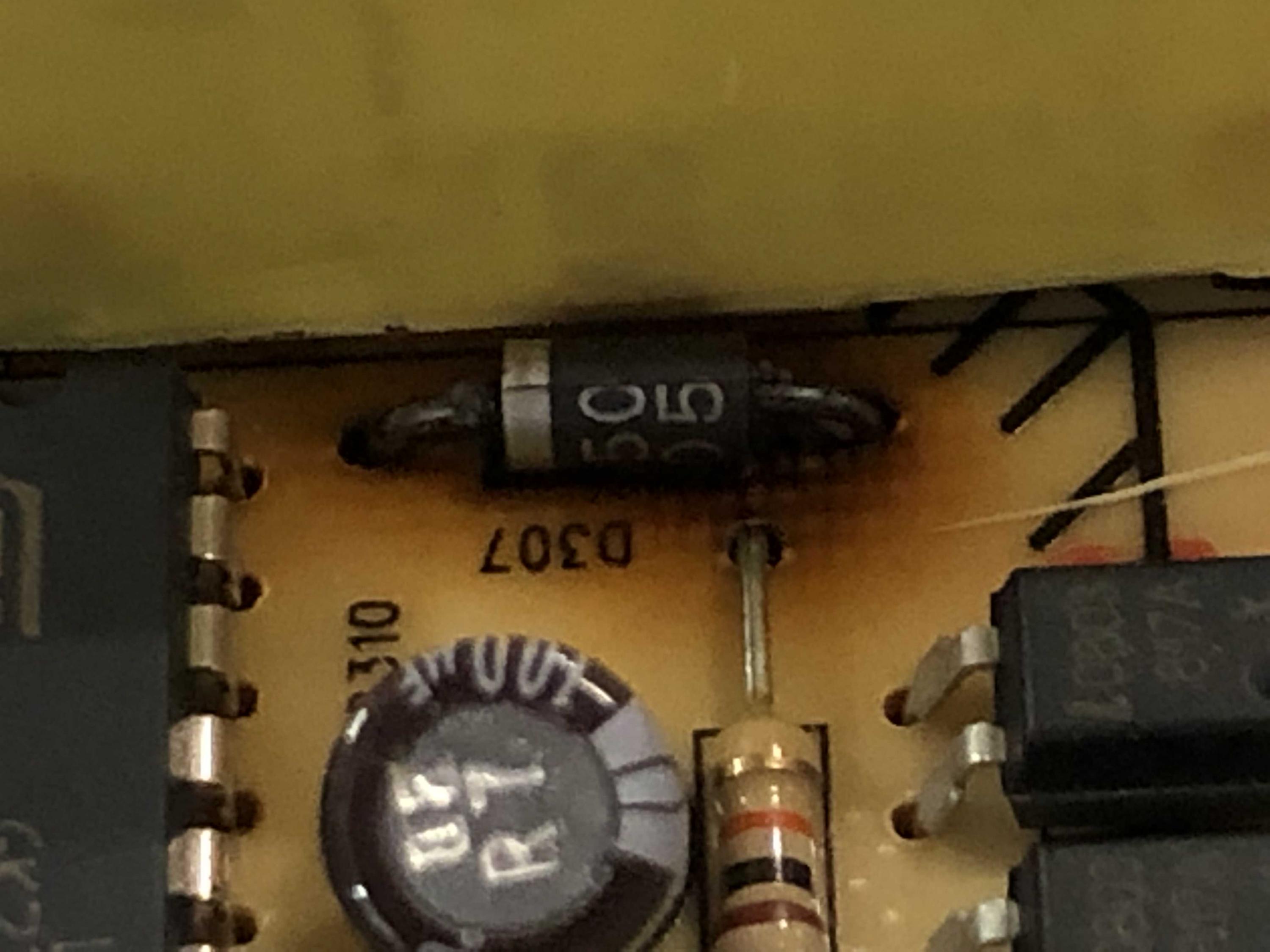

                I fixed it last Friday by replacing D307: I used UF4007 instead of UF1005.
                It's cost me less than 0,1$ !!!
                Thank you so much from me and my wife!

                      D307 now has about 230 ohms in both directions.
                      I'm going to replace it this time by HER306 diode, it has the same voltage, but several times more maximum current. What do you think about?

                                I have a LP3065 that doesn't work. I opened up the power supply and found that D307 was burnt. I'm seeing lots of different diode part numbers here, but it doesn't seem to match the numbers on the diode (50 05). Does anyone know which part number I should order?
                                • MHTSOS
                                  • Jun 2014
                                  • 17
                                  • Greece
                                  #56
                                  Re: HP LP3065 black screen, LED lighted, USB works
                                  Remove the diode and check if its full name is 1N5005.
