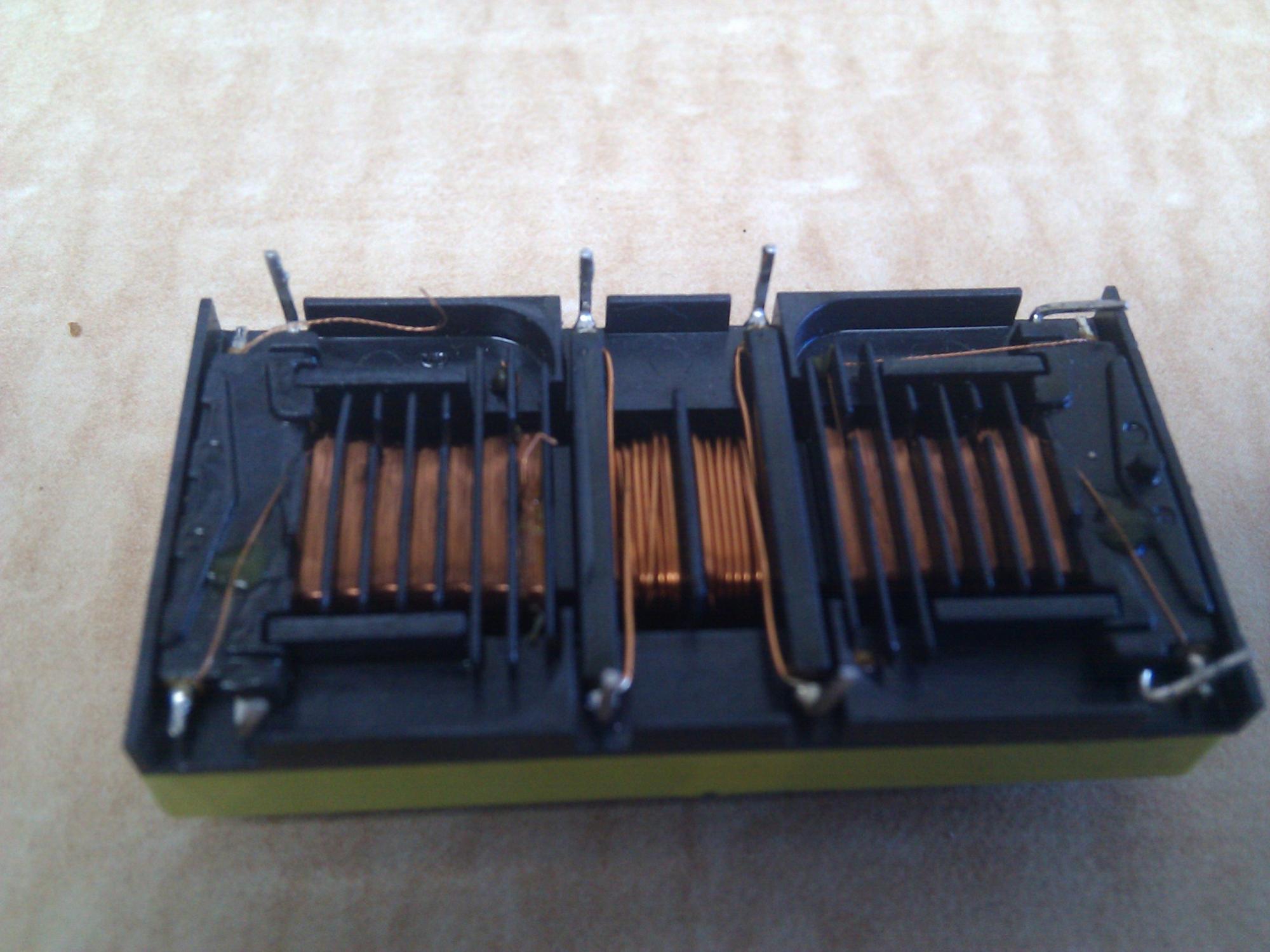

    Good Day folks!
    Firstly it's an honor to be surrounded by Experienced Electronic Techs like yourselves. I've been reading up on my particular monitor for a while now on this site... however i've run into a little problem. I dont seem to find a part number for the particular Transformer that i'm looking for, and I also still have the backlight problem with the green power light.

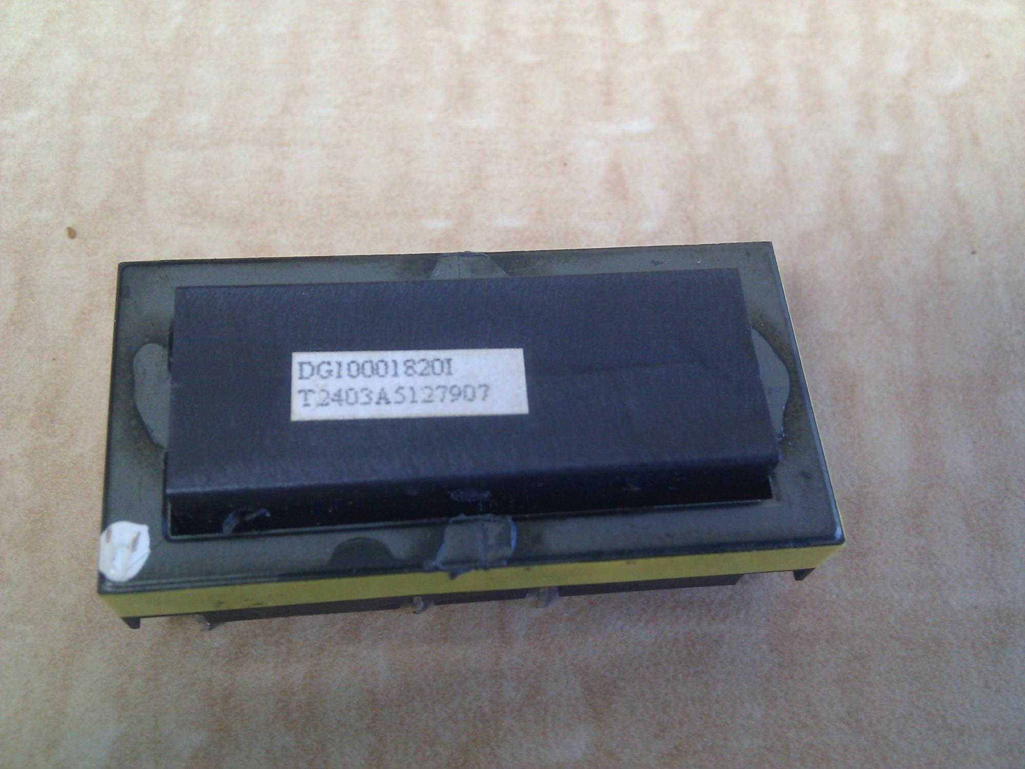

    On the Power / Inverter board there is a transformer that has a Yellow band around it, according to the sticker on it, it's a
    DG10001820I
    T2403A5127907
    I couldn't seem to find this particular one...

      attached the Images of what i'm looking for ...

          Thanks Smason, oh yea it's bad lol ... i'm not sure if you could see from my pics but one of the fine wires on the Transformer coils is no longer connected ... I would love to get my hands on that Transformer to go through the rest of the steps quoted on that forum i posted earlier...

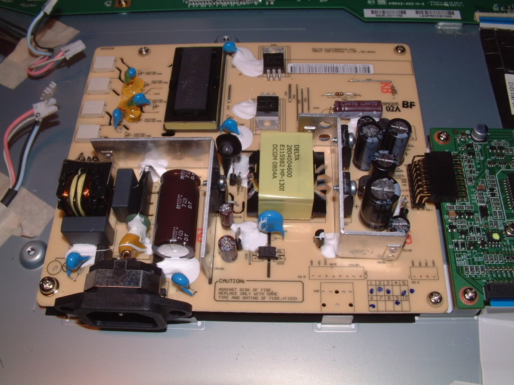

            Here's a pic of the Inverter Board, I may have found the item on Ebay though... but i need to be 100% sure
            http://cgi.ebay.com/TRANSFORMER-2874...737070131#shId
            TRANSFORMER 2874005300 M For AL1916W in DAC-19M005
            Just incase we need to look for that part again ...

              It is not uncommon for the manufacturer to use different power boards and/or revisions.
              The inverter transformer numbers do not match so I would not expect this part to work given the above statement.

                This might also be the MAX810 reset controller located at U406 on the main board. Not the power board. It's very common with this model. It causes a no power problem. You can read about it in this thread.
