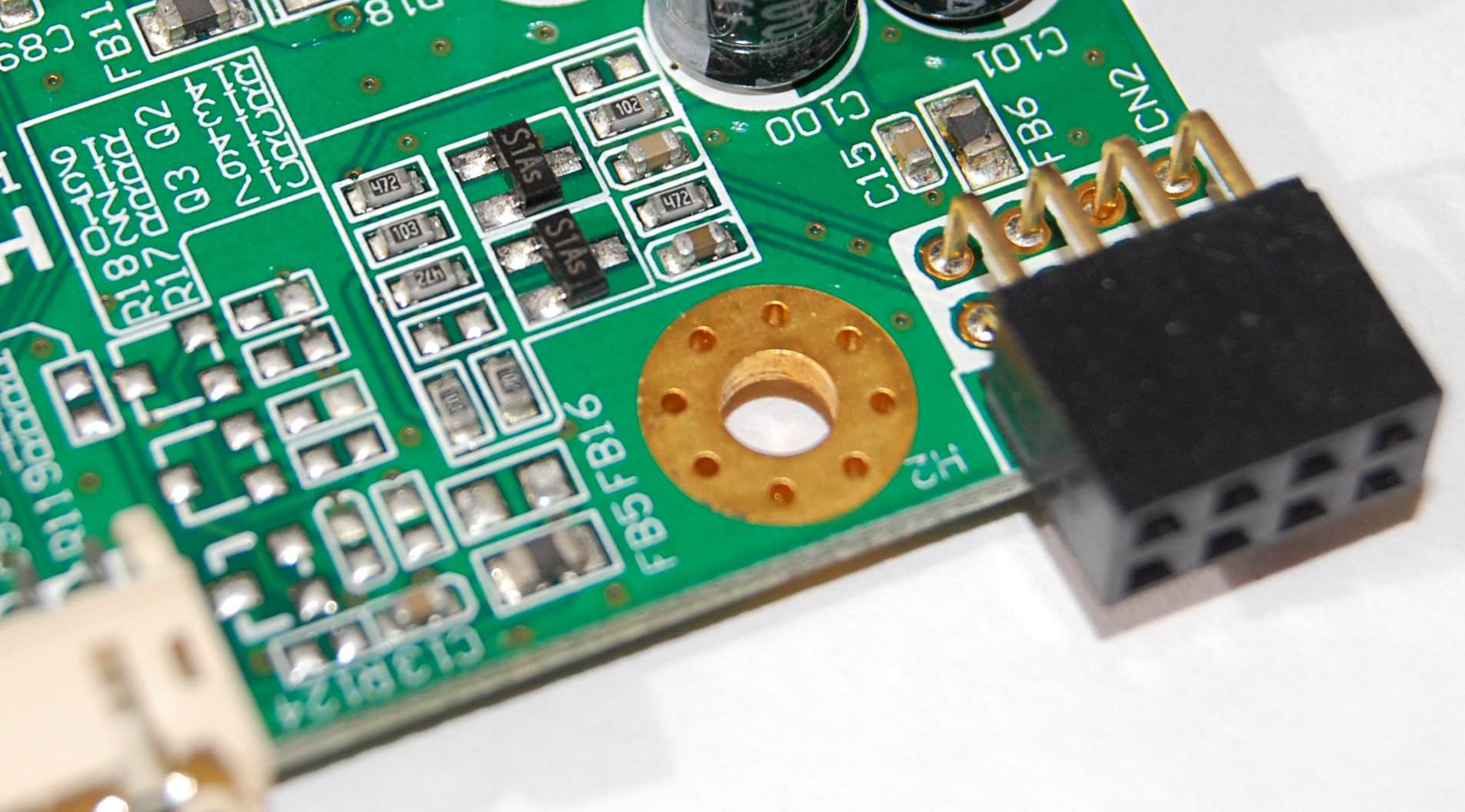

      Re: Hanns-G HX192D power LED flashes
      Originally posted by alexanna View Post
      The 2 voltages you describe are interesting.
      You mention .062v and 4.94v what does the silkscreen indicate these should be, is one dim and the other on? And I am also wondering why they change to 0v with the ribbon to the LCD disconnected.
      The silkscreen only says "ADJUST". The traces can be seen on the back side of the IPS board, one leading back to Q1 and the other to R12. It's more interesting on the digital board.
      The adjust lines are the two closest pins on the black connector. For orientation, the white piece at the bottom of the picture is the edge of CN5, the button cable connector.
      The upper adjust line is tied to the top pin of the left transistor, Q2, also the 1K resistor above it, R13, pulling it to +5V. The lower adjust line goes to R19, the top pin of Q3 and C17, which is connected to ground.

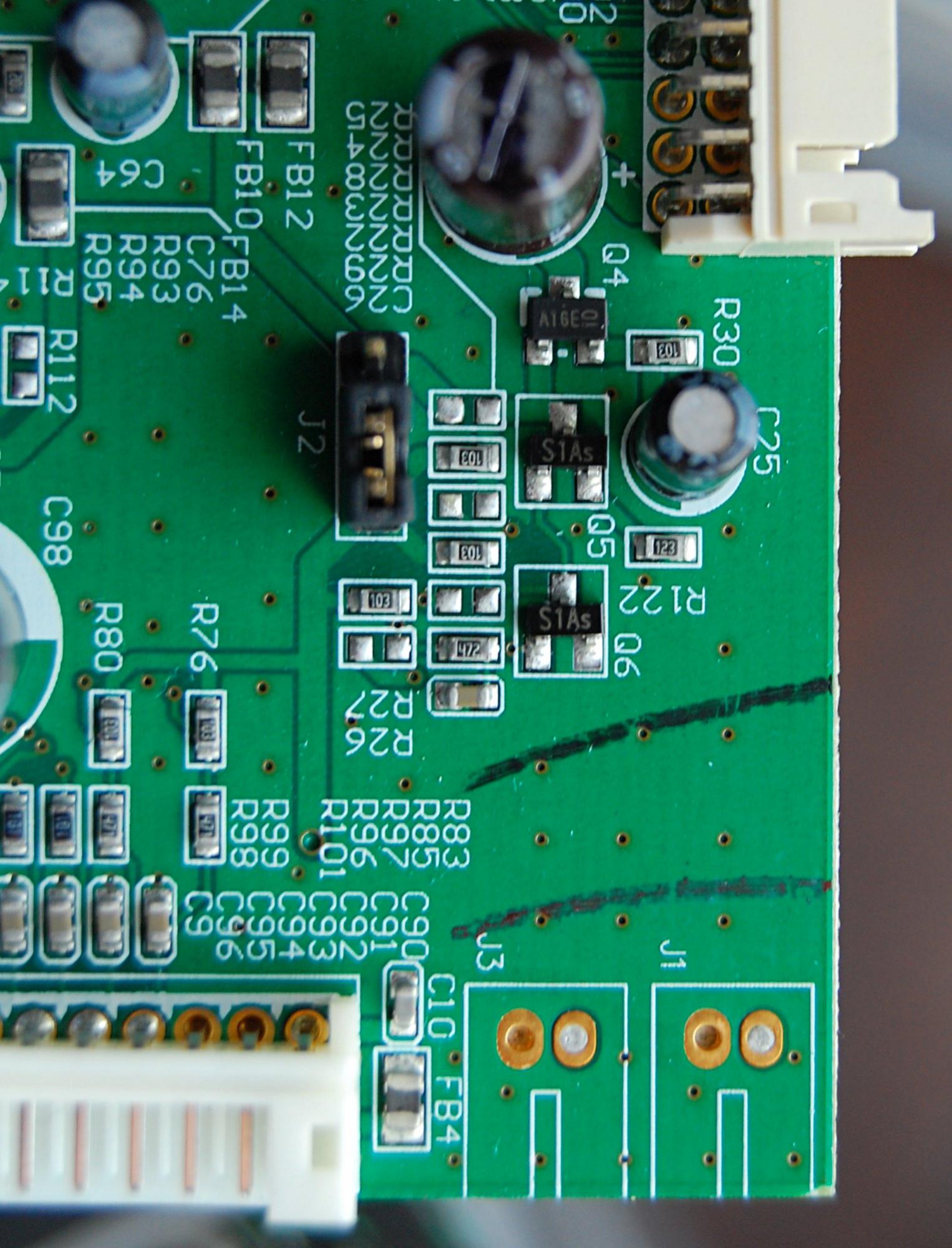

                  I can't find any ICs powered by J2. The center pin links to Q4, the right pin in the picture. From there, the output appears to go through the two S1As transistors (Q5 and Q6) and then eventually the output of Q6 goes through a 472 resistor and back to a pin on the left side of the processor.
                  I'll replace C25 and test again just in case.
                  After that, is there any reason not to remove the 24LC16 and test without it?
                    Nope.
                      Well, that made a difference. Instead of a fast flashing power LED as soon as AC is connected, it's flashing slower, about 1 Hz. The inverter whine goes on and off in sync with the LED as before. I'll report back after replacing the 24LC16B. Thanks again!
