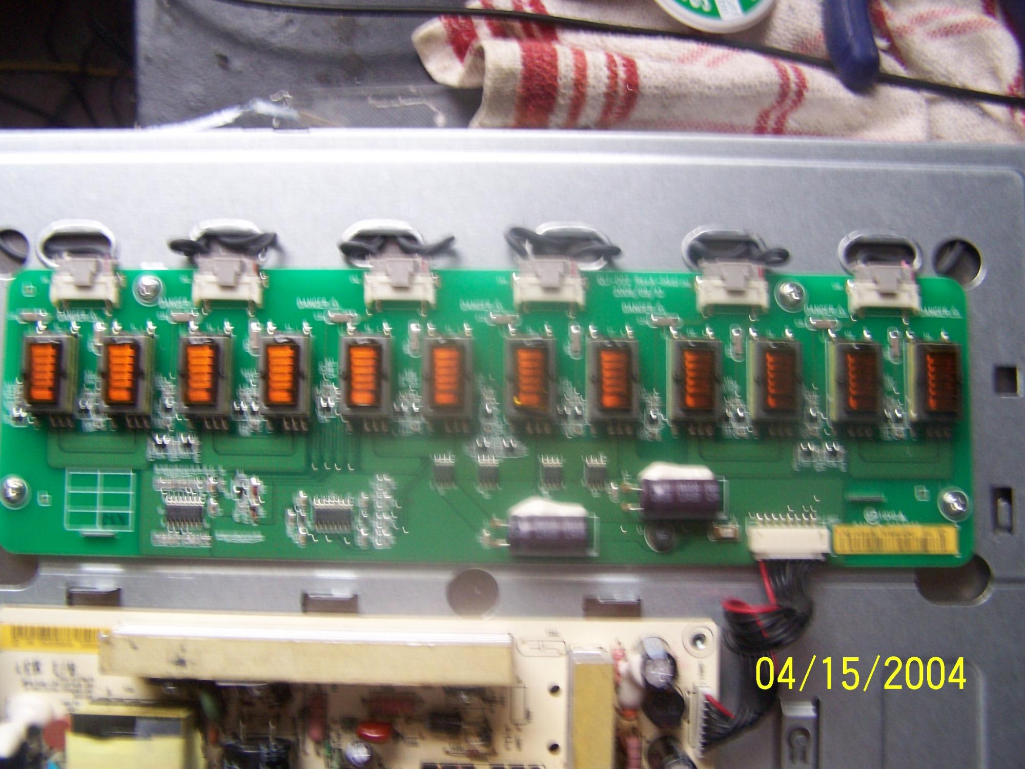

You can definitly pat yourself on the back for getting me this far .I replaced regulator 605 now have 3.3 volts and 1.8 from 604 . The power led lights blue and the controls seem to work ok . Now I need to work on back light proplems . The screen is blank .

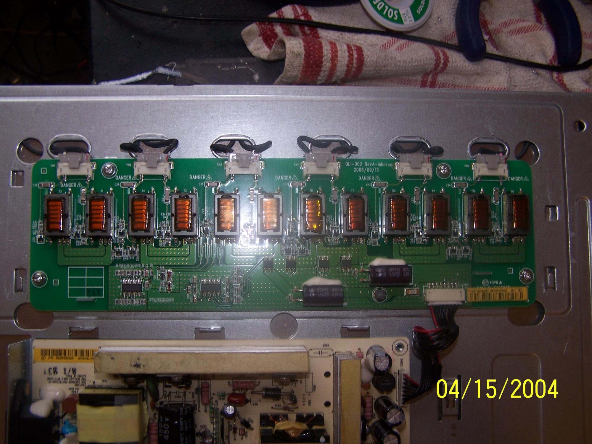

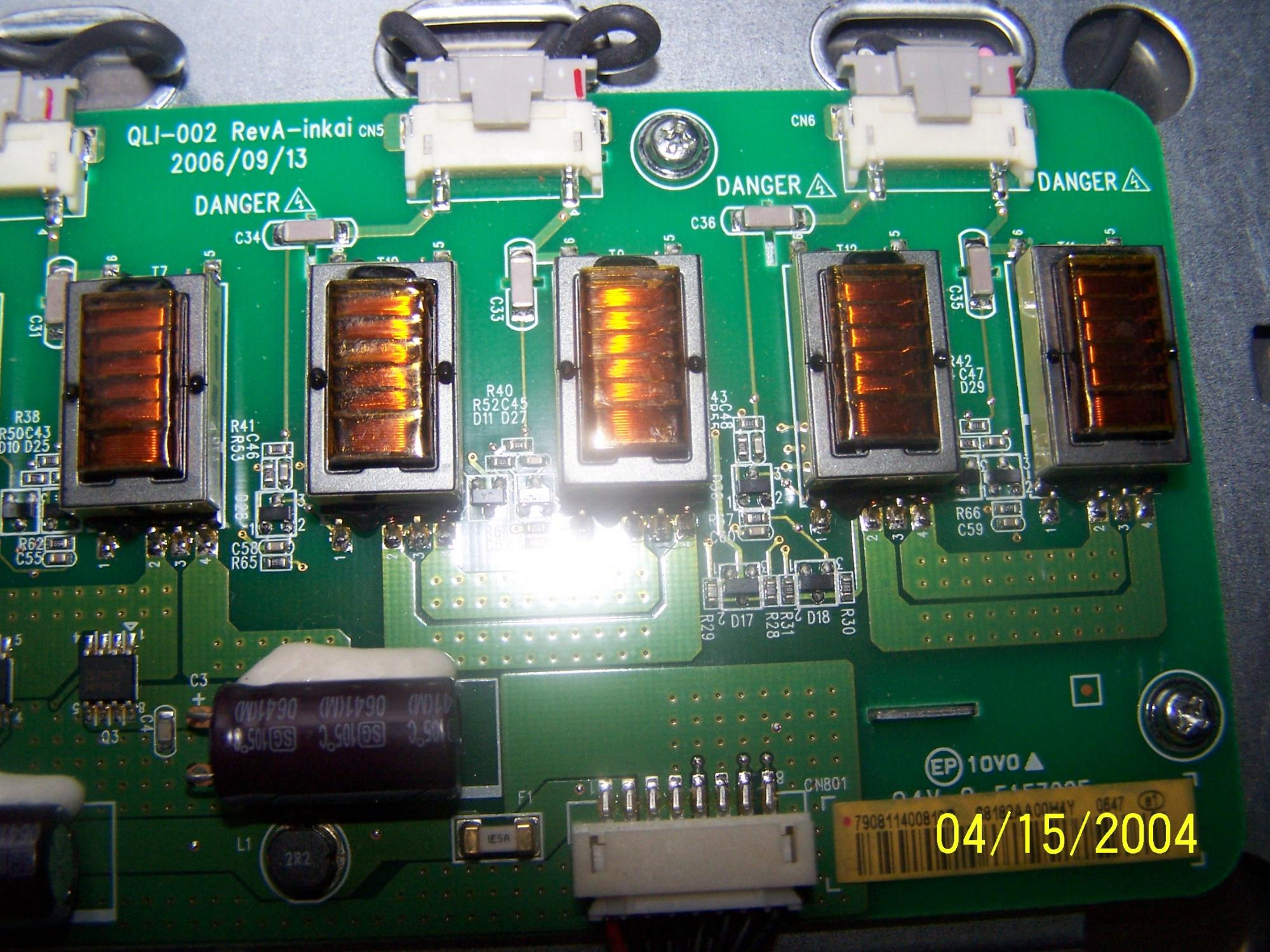

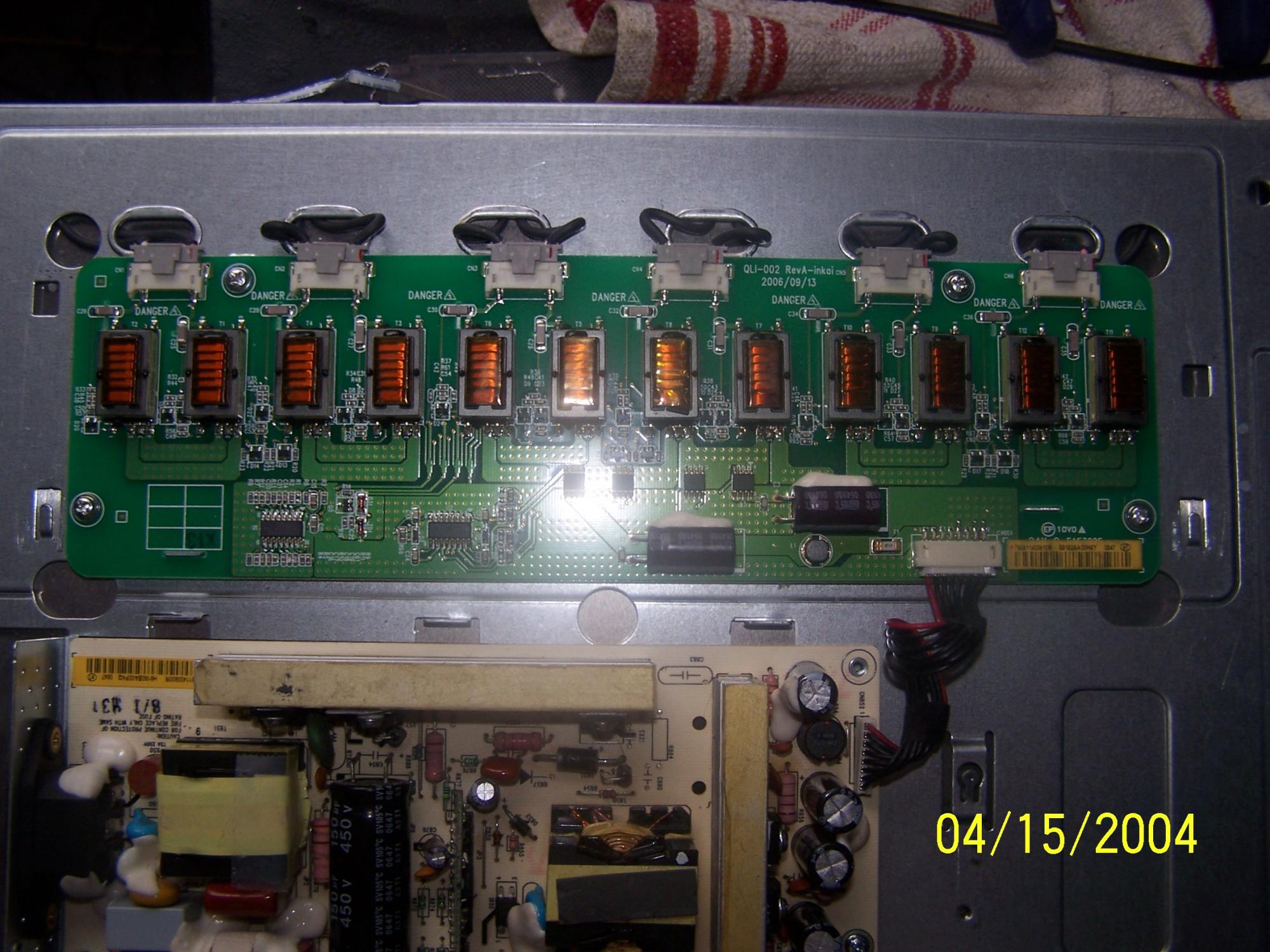

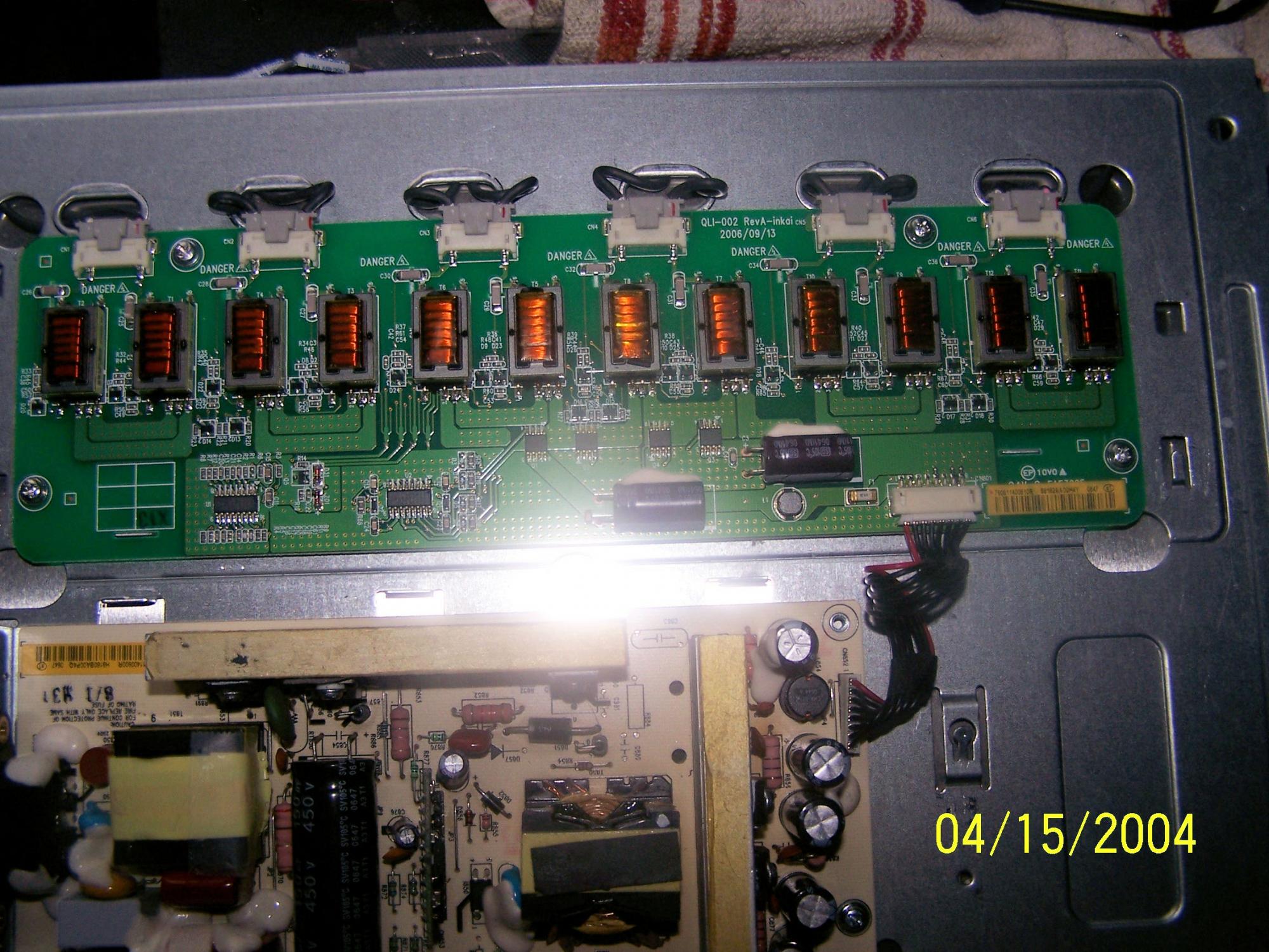

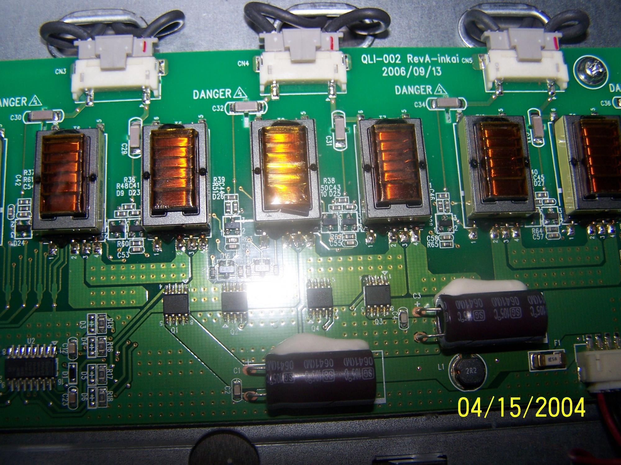

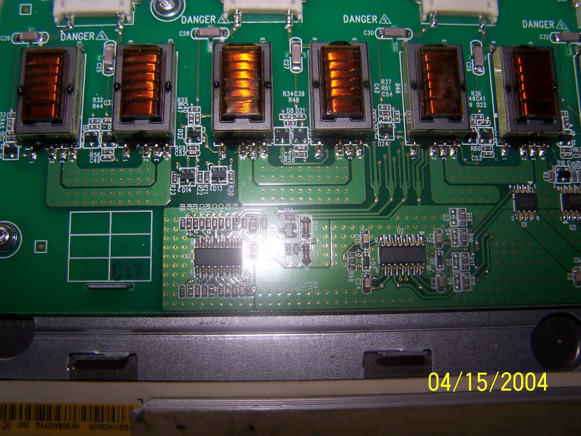

1) We'll need some good focused photos of the inverter board.
2) When you press the on/off button, do you see a momentary flash like the backlights trying to start?
3) In a dim room with the monitor on and connected to a running computer, if you shine a flashlight against the screen, can you see see a faint image of the desktop?
I dont see any flash when I turn it on and the screen is a complete blank.
the voltages at the input connector are
pin 1 26v pin 2 26v pin 3 0v pin 4 0v pin 5 5v pin 6 0v pin 7 0v pin 8 0v
The board has 2 oz9938 chips u1 and u2 which I assume are controllers .
The voltages on u1 are
pin 1 0v pin 2 5v pin 3 0v pin 4 0v pin 5 0v pin 6 0v pin 7 2v pin 8 0v
pin 9 0v pin 10 0v pin 11 .68 v pin 12 0v pin 13 5v pin 14 0v pin 15 0v pin 16 0v
This appears to trace back to the signal card. As closely as I can tell, pins 1&2 are 24V from the power supply, 3&4 are gnd, 5 is 5V from the power supply, 6 is gnd, 7 & 8 are brightness and backlight on which come from the signal card, passed through the power supply to the inverter.
PlainBill
Have you tried checking fuse F1 to the left of the wiring harness? Also, check mosfets Q1-Q4 for shorts.
I found that OZ9938 controller listed on an o2 micro site which is in a PDF.
I am unsure how to attach it.
It's showing pin 4 as the dim and pin 10 as on off ???

You can attach the PDF file using the "manage attachments" button. Same thing as attaching photos
