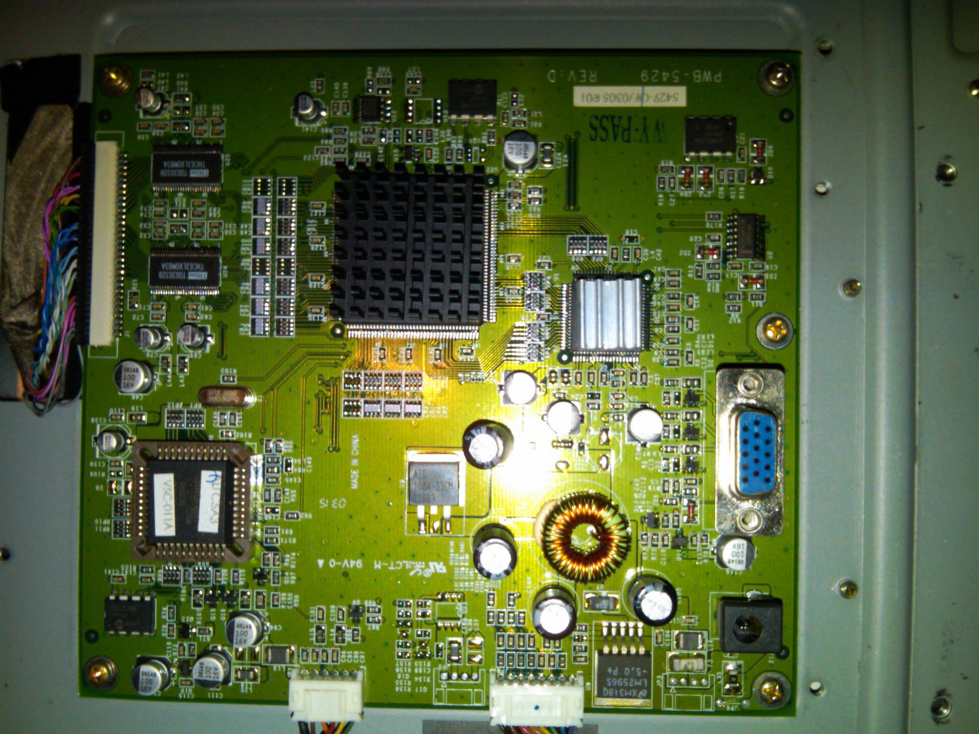

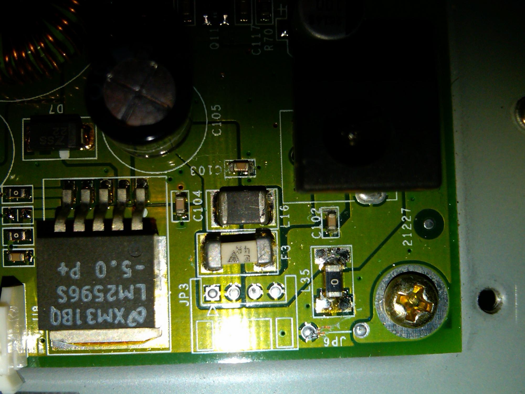

    I've got this monitor that has no power. I took it apart and measured ohms on C102, L35, F3, and L16. When I got to C103 I did not get my 3ohm reading I got nothing. Should I go ahead and replace this? I have posted pics of the enire board and another one zooming on the area I first was working on. Thank you all for the help.

    Did you measure the AC adapter? It should be ~12V.

      C103 is a capacitor. You should not get any resistance across a good capacitor. Like mockingbird said, check the input voltage from the power supply first. Check that on the small connector of the wire that you plug into the board. I had a lcd tv that had a problem only with the power connector.

        Hello took the jack of and re-soldered it. HA HA it powered on. Now I have alot of vertical lines and then goes blank. Is this trash or is there another remedy for this.

          Measure the adapter. If you can't fit the DMM probe in the hole, then put a paper clip in it, and then touch the paper clip with one probe and one probe on the outside of the plug.

            I did that and got a reading of 13.6.
