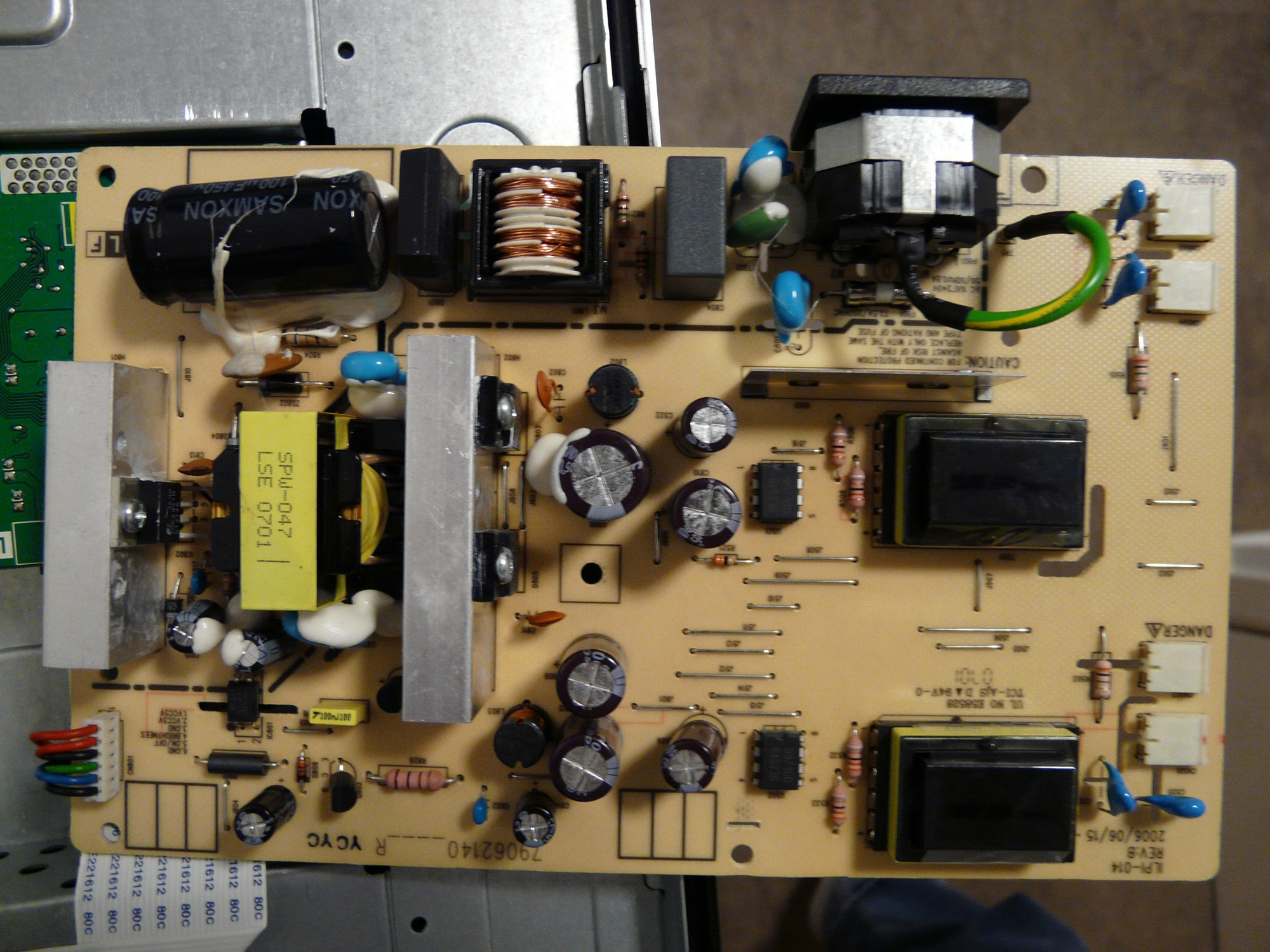

      I have previously measured the voltage across the main filter capacitor to ensure the primary rectifier is working, the voltage is around 300V. I only have a very cheap multimeter so can't get precise values.
      I have enclosed an image of the power supply board.

        1) 300V DC / 1.414 implies 212V AC. That seems correct for the U.K.

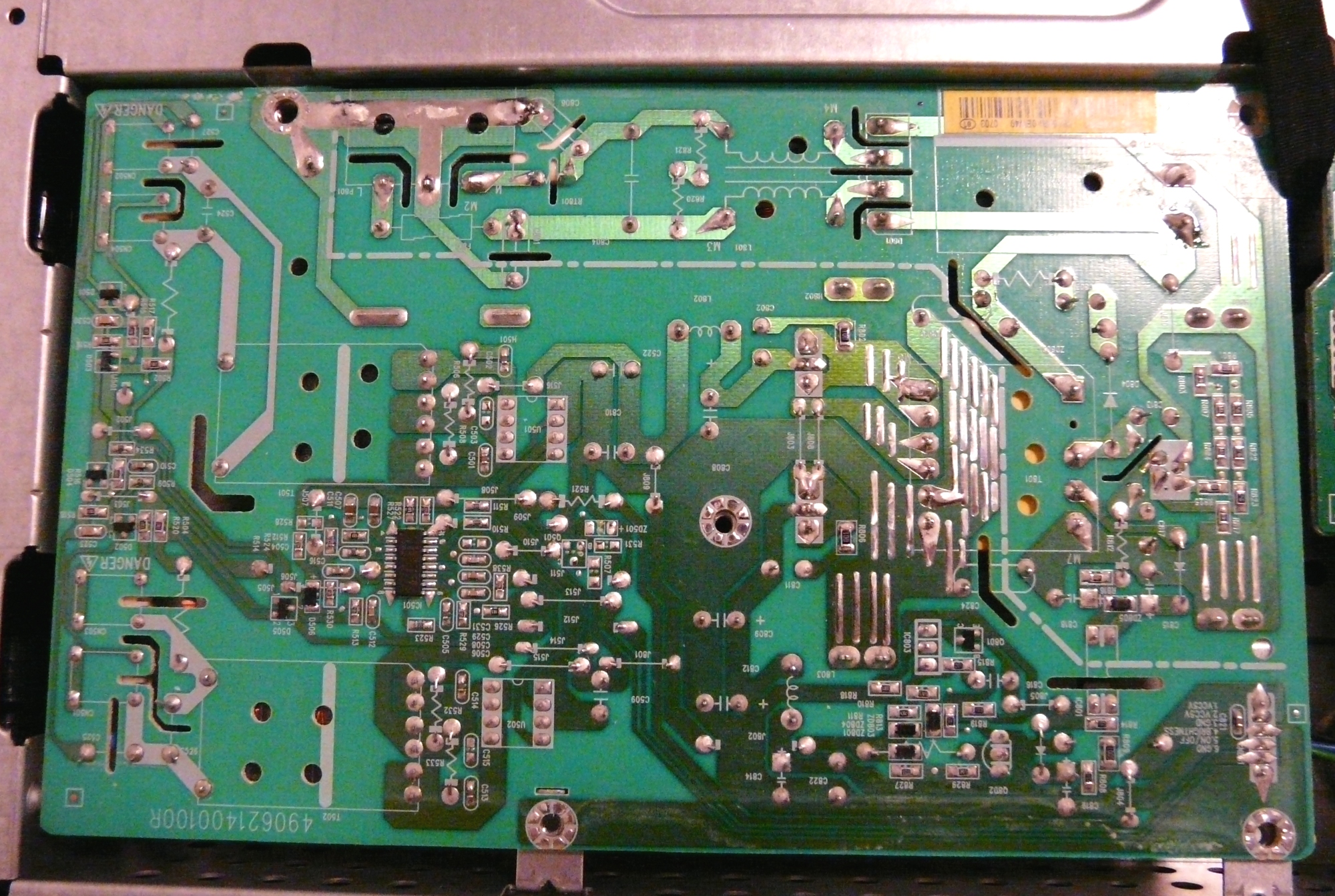

        2) Can we also get a picture of the back of the power board?
        3) Assuming IC802 is the PWM, what is the part number for it?

          Image of the back of the power supply board attached.
          IC802 is TOP245YN.
