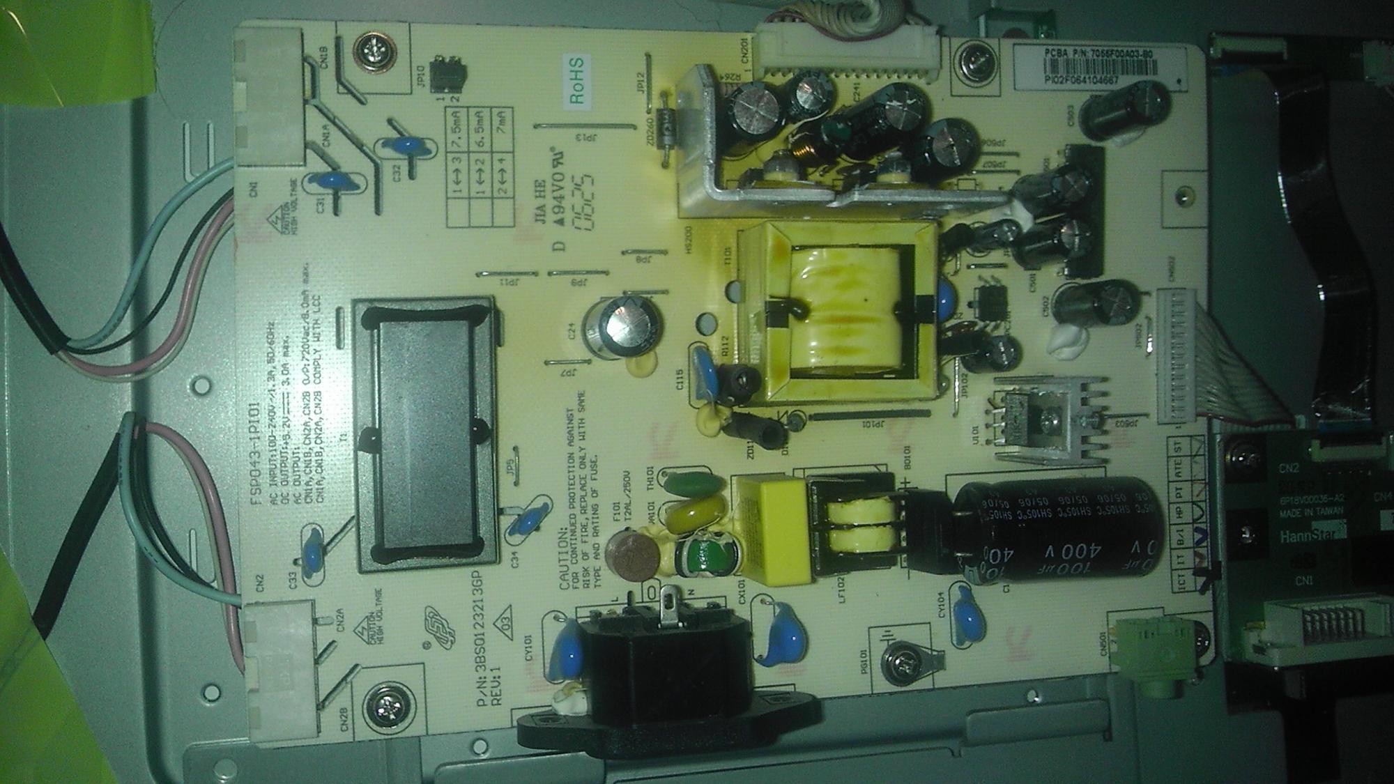

              I've got the same monitor, but it appears to be a different board revision, none of the Cxxx numbers line up. I've got 3 capacitors that appear to be swollen and one that's swollen and leaking slightly. There's also the smaller capacitors that aren't the tube-style and I can't diagnose them just by looking, and since I don't have a voltimeter that can read capacitors I think I'm SOL for the moment, unless you guys have anything to suggest.
                Here's the problem: You have a different board revision with different cap numbers silk-screened on the board. They're probably different capacitance values to boot. However, since you've provided no photos, I think it's safe to say no one here can really help you. The general rule of thumb is that if a few caps are leaking, then you replace all the electrolytic caps with the exception of the large 450V cap (unless it's also leaking). Suggested replacements are Panasonic FR, FM or FC series caps. If more help is needed, take a good focused top view photo of your board and use the "manage attachments" button to post it.

                    Re: I-Inc iF191D Bad Saxon caps
                    Alright, here's the picture, I think it turned out good enough. Let me know what you think. Thanks for the help so far.
                    • jetadm123
                      • 2169
                      Yes, definitely replace ALL the caps with the exception of the large 400V one. I count 11 caps. You can purchase the recommended caps from digikey.com. Select USPS shipping for lowest cost shhipping.
                      • oblivion2k
                        • Aug 2011
                        • 5
                        What do you suggest doing about the tiny blue capacitors?
                          The blue caps are ceramic, and rarely go bad.
                                Good to hear jsog, we had no idea what to do with those since they didn't even have their specifications printed on them. Digikey is missing a few capacitors that I need, a 50v 2.2uf, two 10v 1000uf's and a 10v 470uf (out of stock on the last one, no sign of the first two). There's a radioshack/tv repair store a few miles away from me, I'll check them out. 7 out of the 11 capacitors I tested with my friend's voltimeter showed they were bad, so I'm just gonna replace them all as you suggested. I'll get back once I have the capacitors.
                                Thanks for the data sheet Pcbonez. I'll just have to write down the polarity for each connector before I take off the bad caps or I'm gonna fry the board for sure :P
                                    2.2uF, 50V Panasonic FC
                                    Depends on the brand, series, and size. Put 1000uf 10v in the search and narrow it down from there. If you know the series, put that in too, like 470uf 10v PM for Nichicon PM series. Come to think of it... 10V? Are those original caps? Usually they'd be at least 16V.
                                      They often use caps of higher than necessary voltage to get a larger can which gives better Ripple and/or ESR.
                                      Can achieve the same thing by using a higher grade or a longer cap without the higher voltage.
                                      BUT: If you are going to reduce voltage from the original you need to check what the actual circuit voltage is.
                                      The voltage rating of the cap should be higher than the actual circuit voltage.
                                        Bought all the capacitors I needed. A friend at a local tv repair shop put in an order for me. We are working on it right now. Wish me luck!
