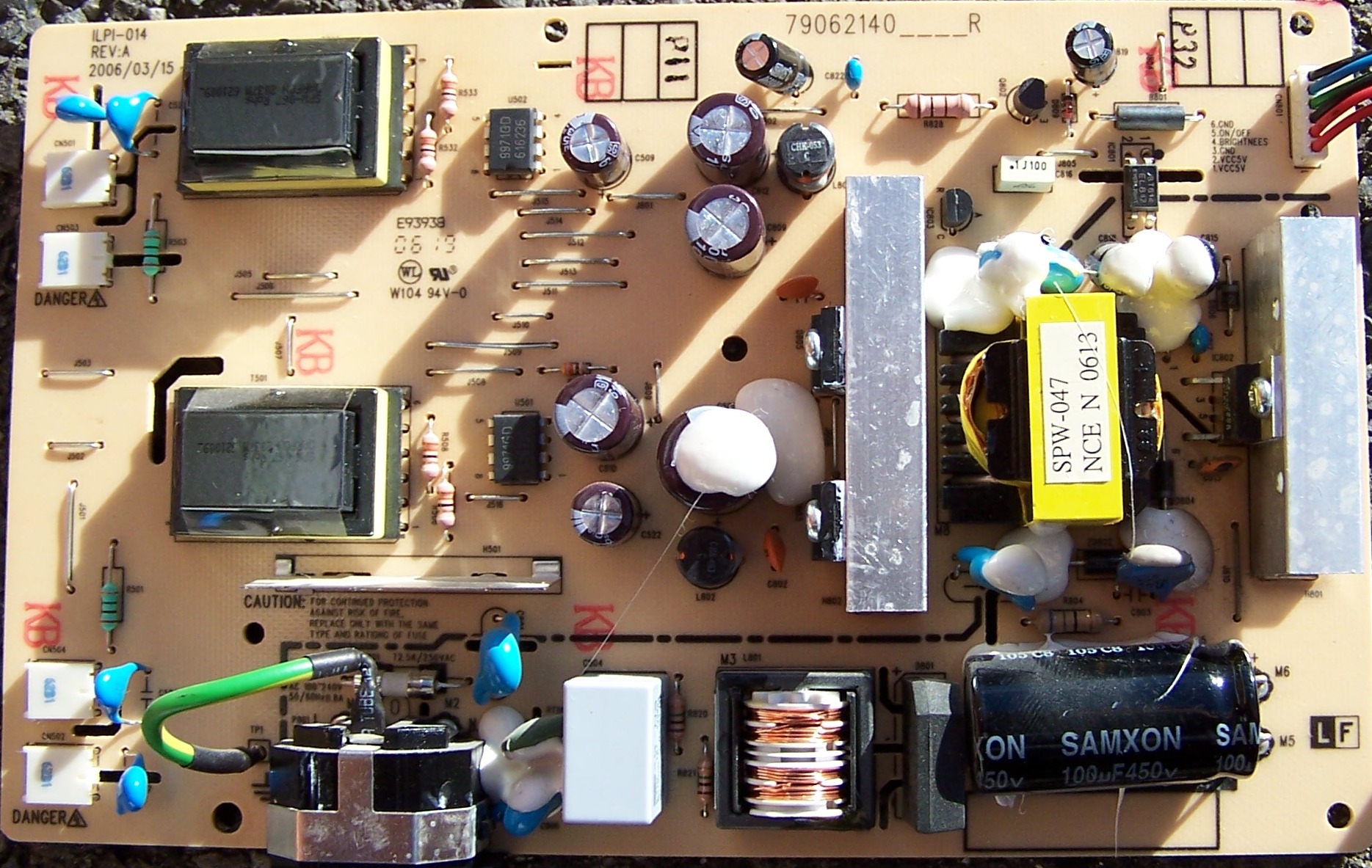

    I'm trying to repair a LG LCD 1718S which has the followiong symptoms.
    When you power it on the green light comes on so there is power to the board. 9 out of 10 times when you power it on you get the 2 seconds to death syndrome. Only its more like 0.5 seconds. The other time the picture is visible but disappears 10 seconds later. When it goes black however if I shine a torch on the LCD I dont see the pic. I've also had a look for bulging caps and all the caps look perfect (except for the ones covered in the white paste - can't see the tops) so I'm not sure if its a cap problem - could it be?
    Should I just blindly replace the caps and hope for the best?

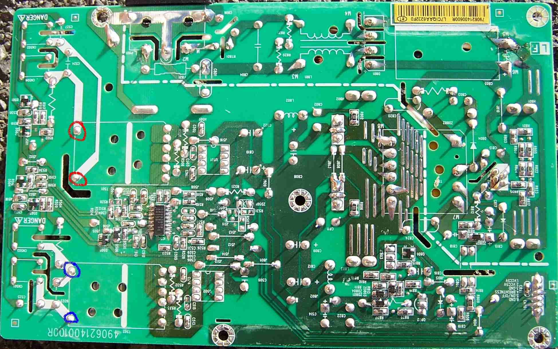

      You can scrape off the glue and check the caps. The glue is used during manufacturing to hold components in place. I would hold off replacing the caps until I exhausted all other possibilities.
      I marked what I believe are the secondaries. Put your multimeter on 2000 ohm (if manual). With power off and LCD unplugged, measure the resistance between the red dots. Do the same for blue. Report both readings.
      Do you have a spare LCD monitor lying around?

        Re: LG 1718S-BN no video
        I've scraped off the glue - all looks fine.
        Measured both points - they measure 460R.
        Funnily enough I have another LG (slightly bigger - 22") which is in pieces as I'm waiting for low ESR caps to arrive for it.

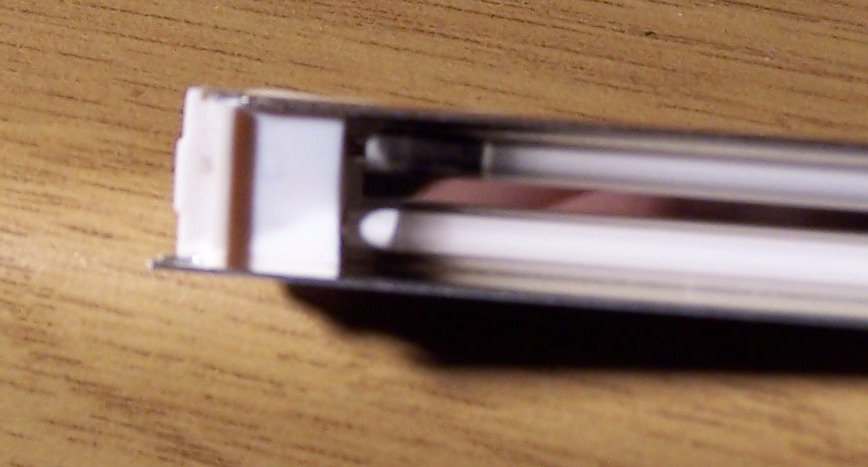

                            • gregmcc
                              • Aug 2007
                              • 23
                              I see what you mean about delicate work
                              I got it opened up and one of the ends of the CCFL is blackened.
                              • retiredcaps
                                • Apr 2010
                                • 9271
                                You can buy bare, pre-wired, or pre-housed ccfls from ccflwarehouse.com. Bare is the cheapest, but the hardest to put back together and install.
                                ccflwarehouse.com has good feedback from members here.
                                It is your call whether it is worth repairing from a $$$ point of view now that we know it is not wiring (which would have just required re-soldering).
