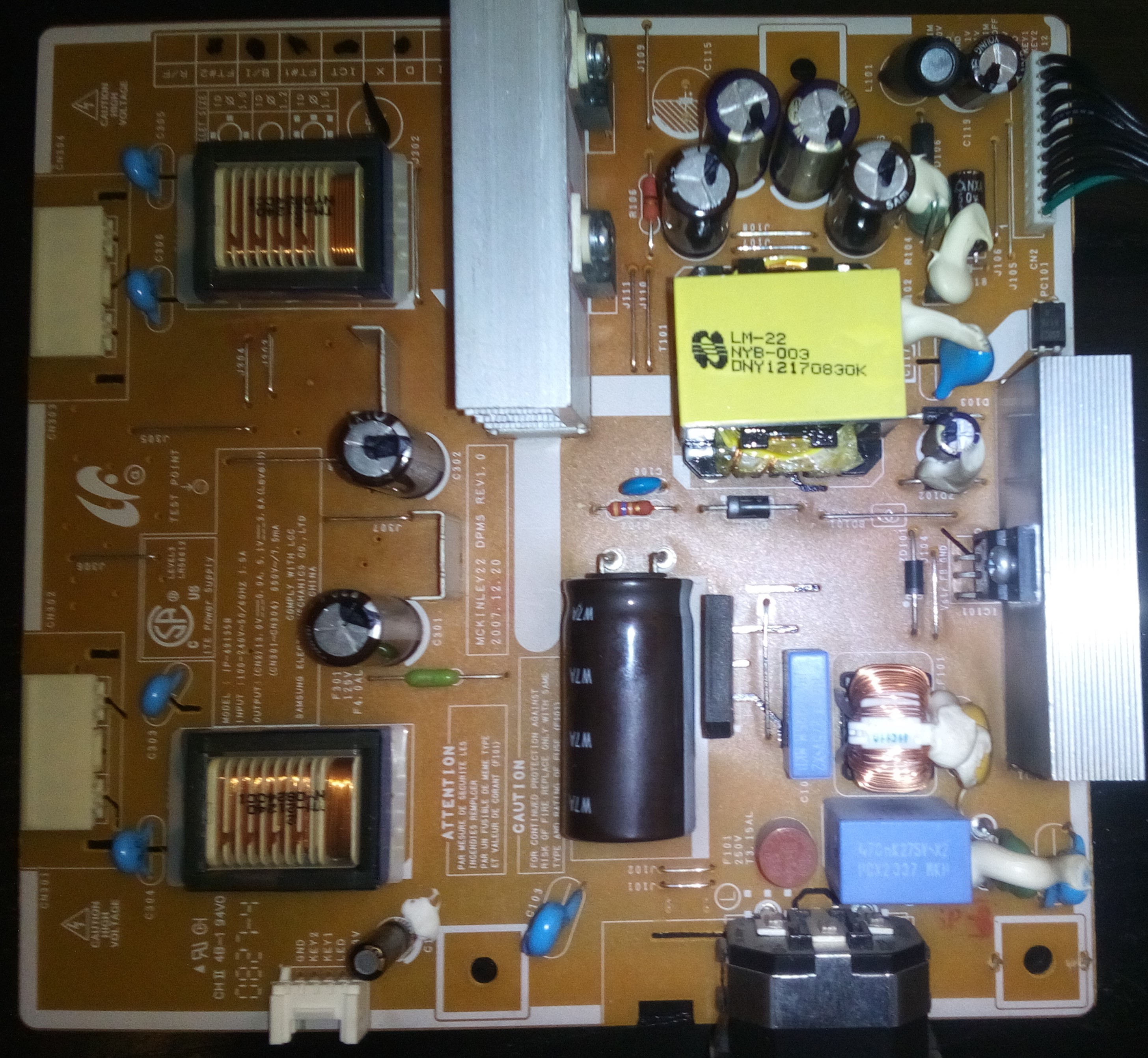

    I have marked two sets of pins on the inverter transformer.One red pair and one white pair.Measure each pair using the restance range on your meter and advise.

      Transformer is unsoldered and mesured:
      Red pins show 1.976 kOhms
      White pins show 0.894 kOhms

        Re: Samsung 2233sw '2sec to black'. Need guidance please.
        Looks like you need a new transformer...check Ebay with the number on the top of the transformer

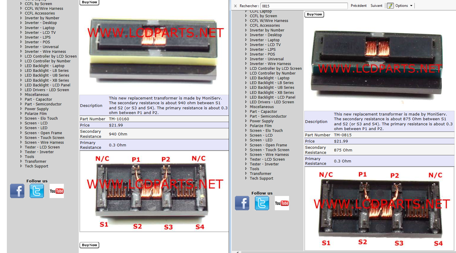

                        I had order the transformer TM-0815 and received TM-10160. Did someone know if they had an change on an new specs?
                        Because specs are différents.
                        TM-0815 is Secondairy 875 ohms and TM-10160 Secondairy 940 ohms. It will not fit?

                          #52
                          If you ordered the correct one,and received the wrong one, then send it back.

                              #54
                              Hi Everyone,
                              After waiting over months (parcel lost from China),(wrong model sent from an eBay user) and also another lost parcel that arrives 3 months after, i had soldered the new transformator TM-0815 and everything is back to LIFE :P
                              Yes sir! The monitor works again!
