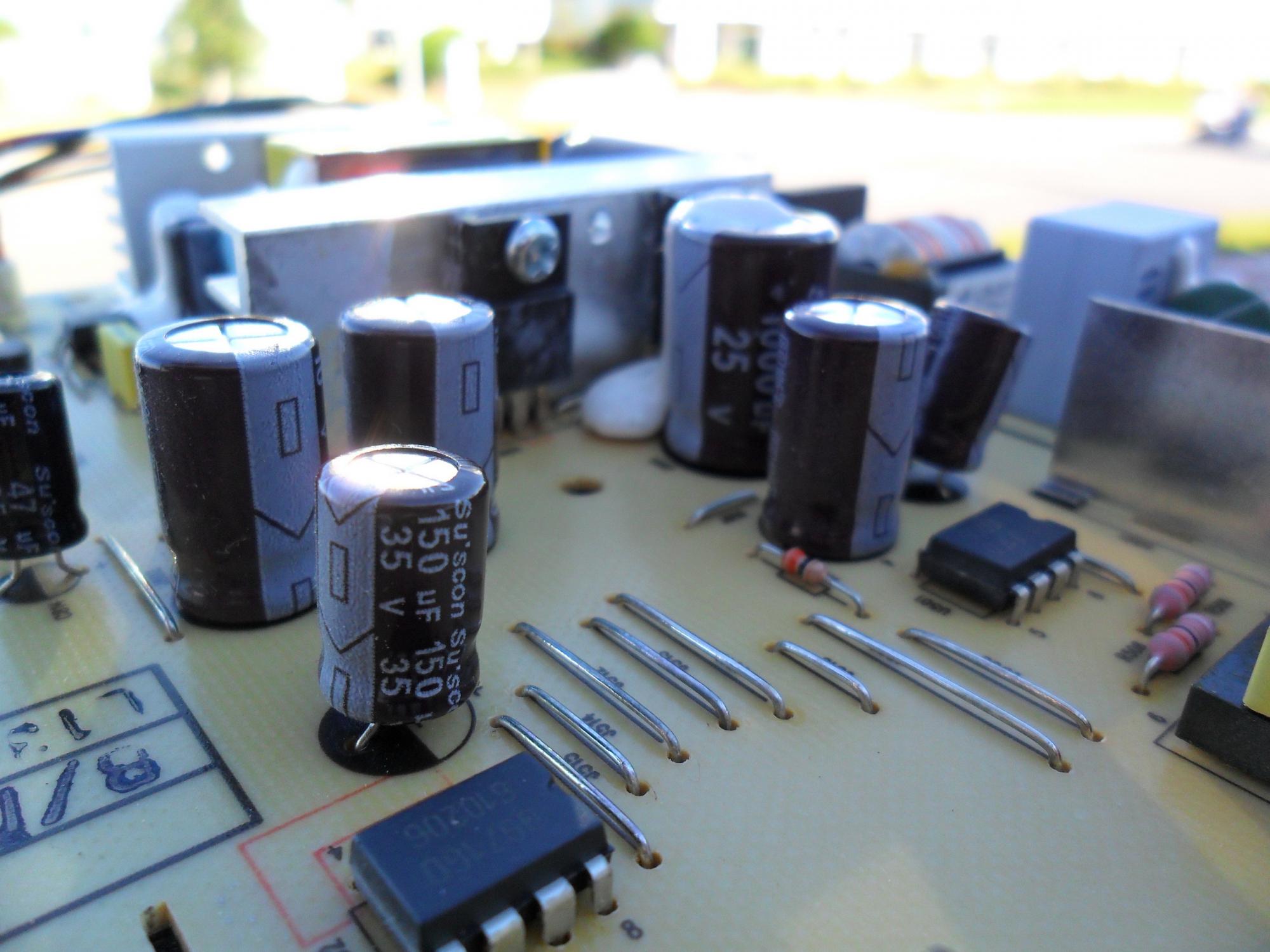

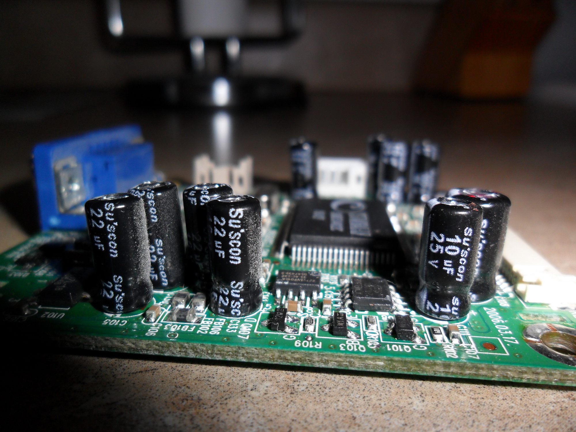

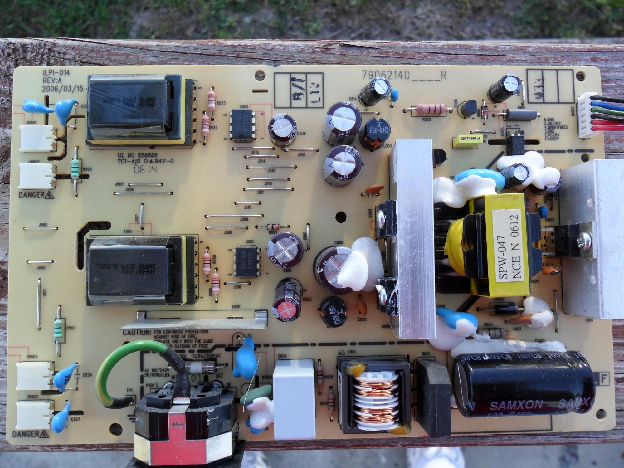

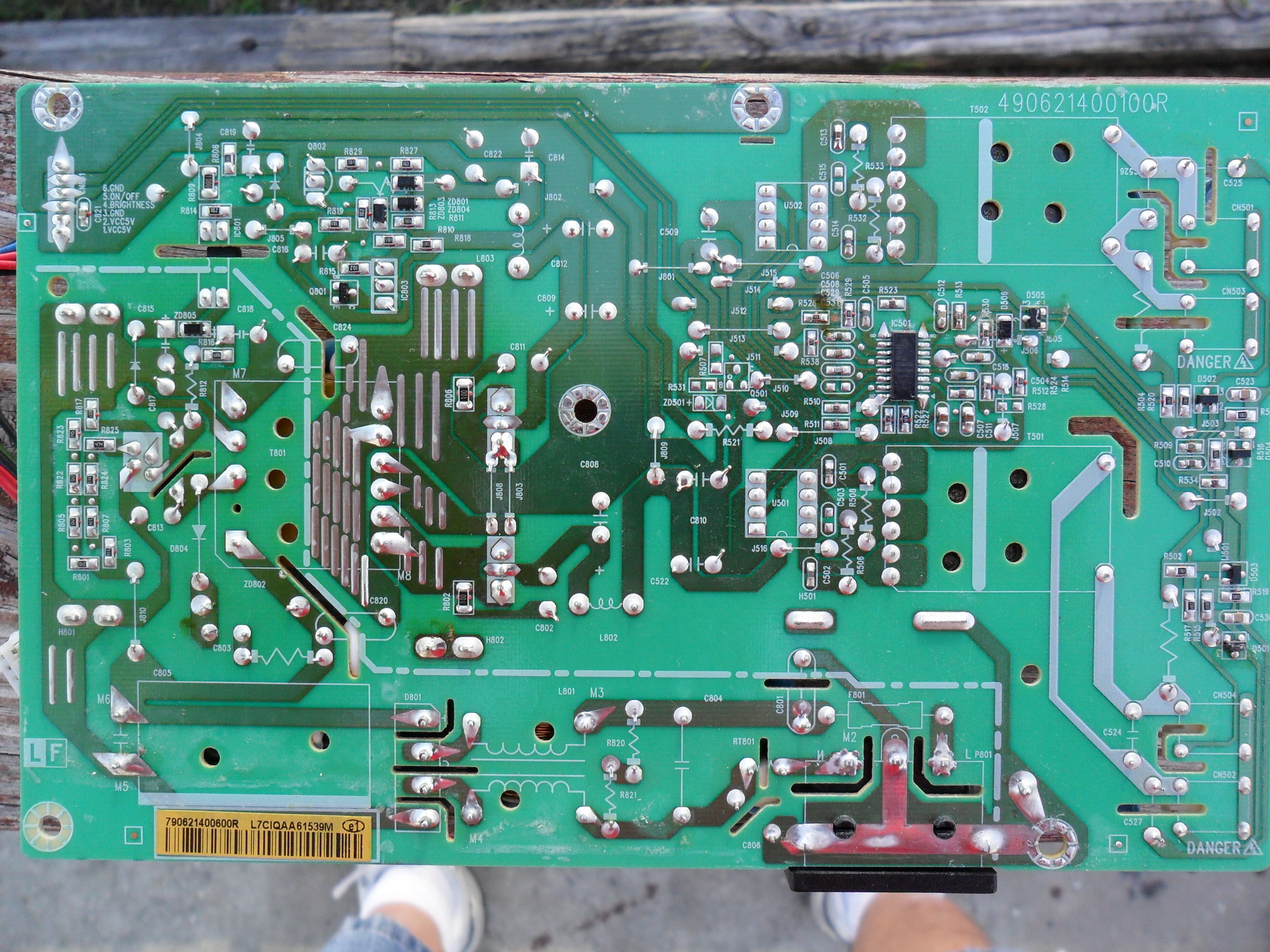

    Hi Everyone,
    This is my first time posting about a problem I have. I've fixed 2 other lcd's by replacing caps and they work fine, but this one I don't know what to do next. I have this monitor that doesn't show any video when I connect it to a computer. I replaced the power supply caps with panasonic FM's but I still get the same results.
    I get 5.14v at the power supply output cable and the backlights seem to came on and stay on, but there is no video, the menu doesn't show when I push the button either.

    Excellent clear focused pictures. A+
    Test voltage regulators U101 and U102. It looks like U102 should be outputting 1.8V DC. I can't tell with U101 because of the angle of the photo. With U102, the last two digits are 18 which indicates 1.8V DC.

        Seriously good pictures, Dude. I have only one question. In the first picture one pants leg appears to be longer than the other. Is that a fashion thing, or just the camera angle?

        4. There are two voltage regulators on the logic card - U101 and U102. Pins 1 and 3 are numbered, the tab is pin 2. With the logic card connected to the power supply, power supply on, etc, measure voltage from one of the mounting screws to each pin on each voltage regulator.

            U101 looks good. U102 pin 2 looks suspicious. If U102 is AS1117L-18, then I believe it should be 1.8V DC.

                  Bingo!! U102 is toast. It should be 1.8 volts. No promises that you will have a working monitor if you replace it. Feeding 3.84 volts into an IC designed to take 1.8 volts tends to do BAD things.
