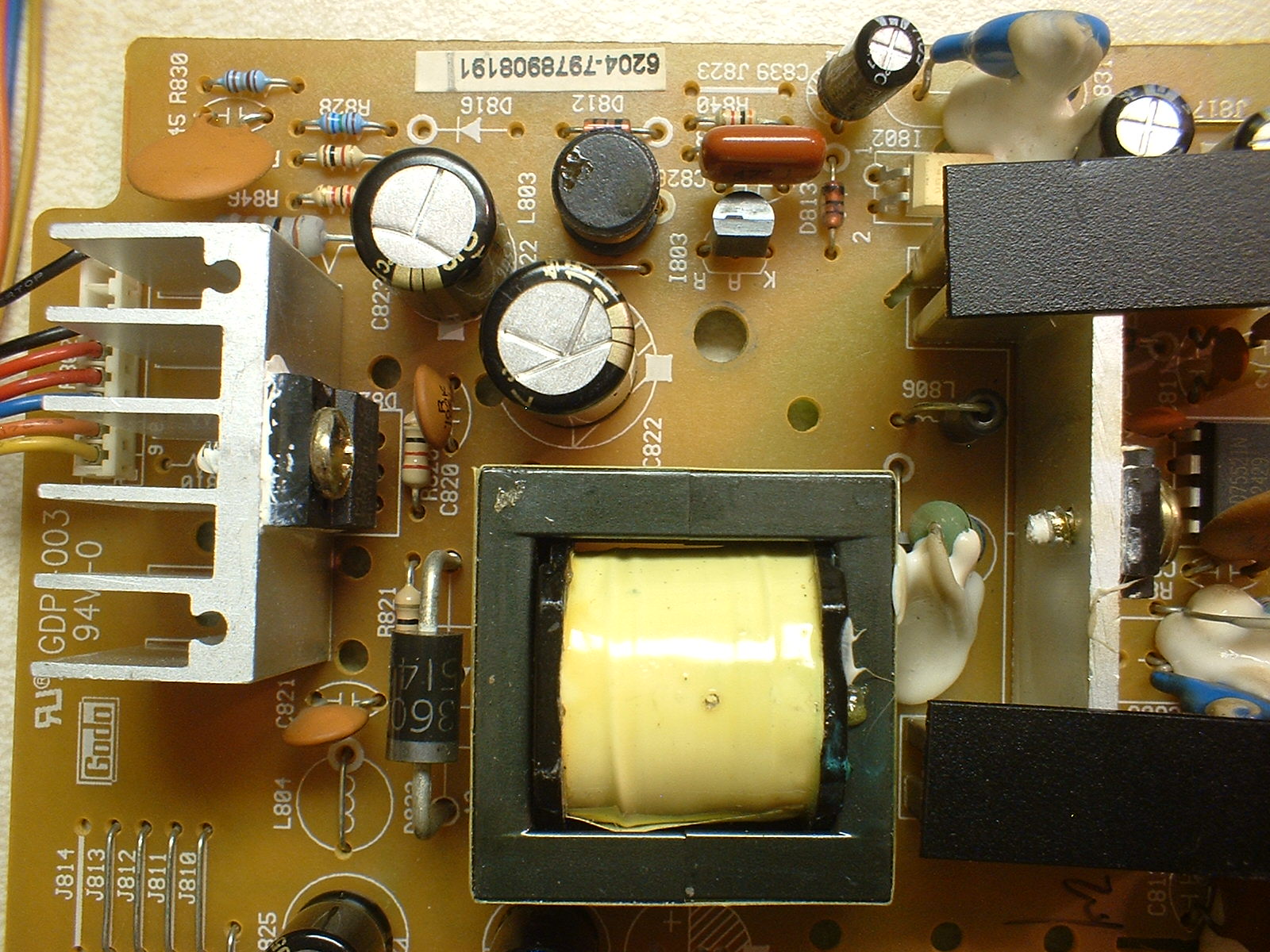

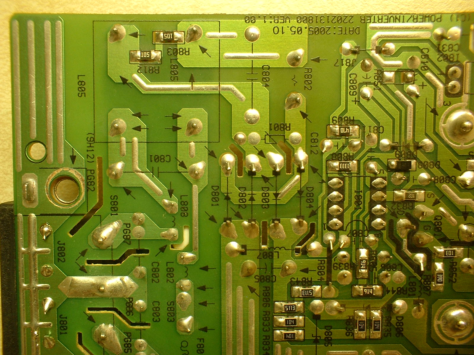

                    • junktv
                      • Nov 2010
                      • 3065
                      #70
                      Re: Viewsonic VE710b

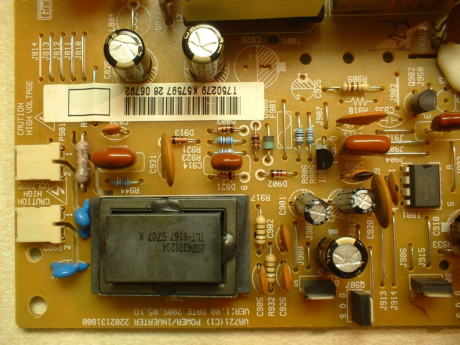

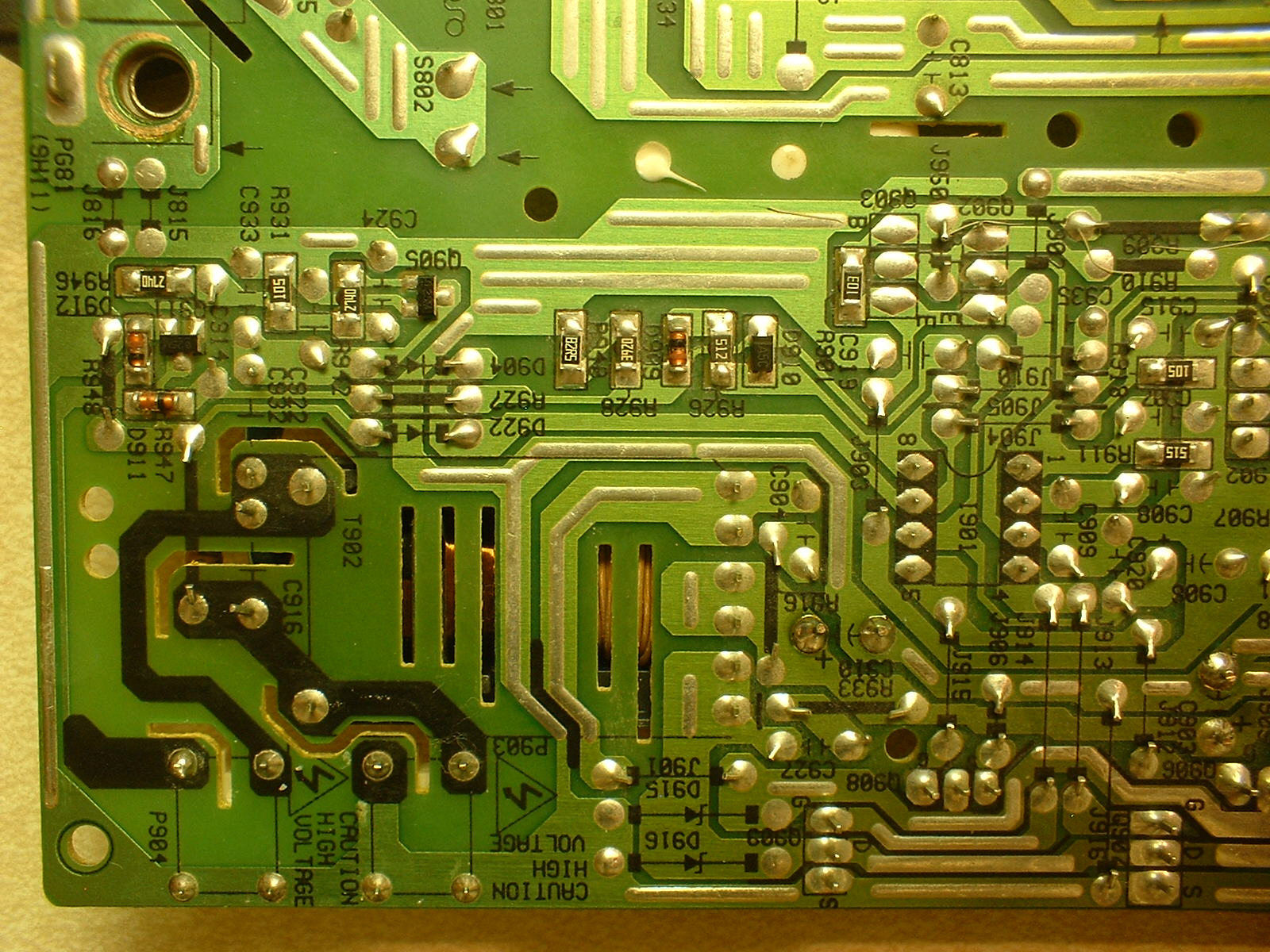

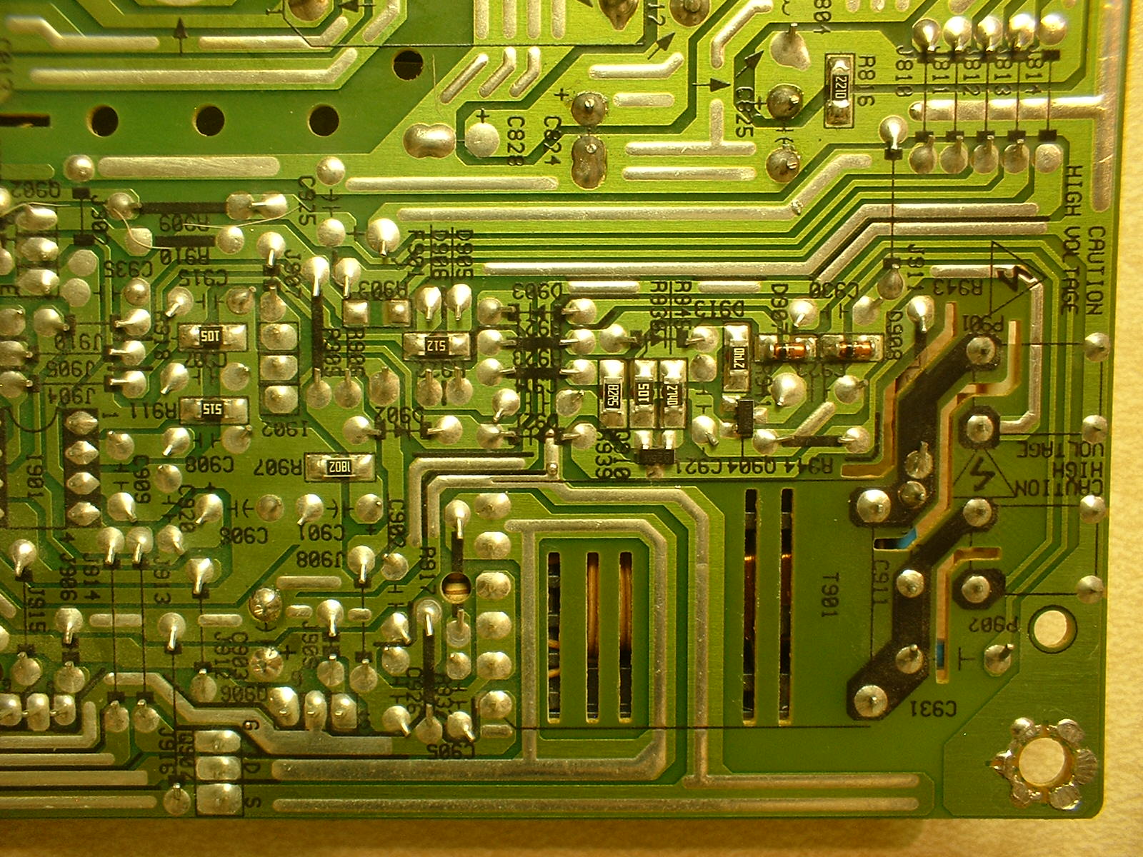

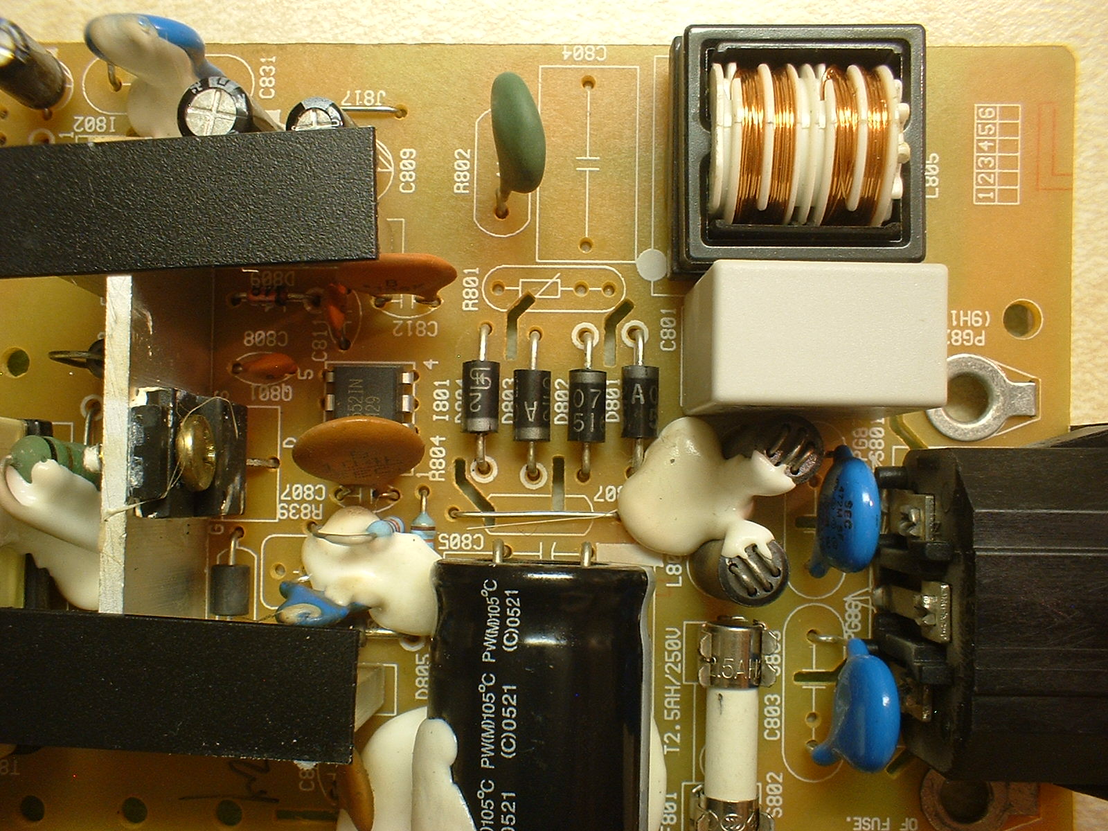

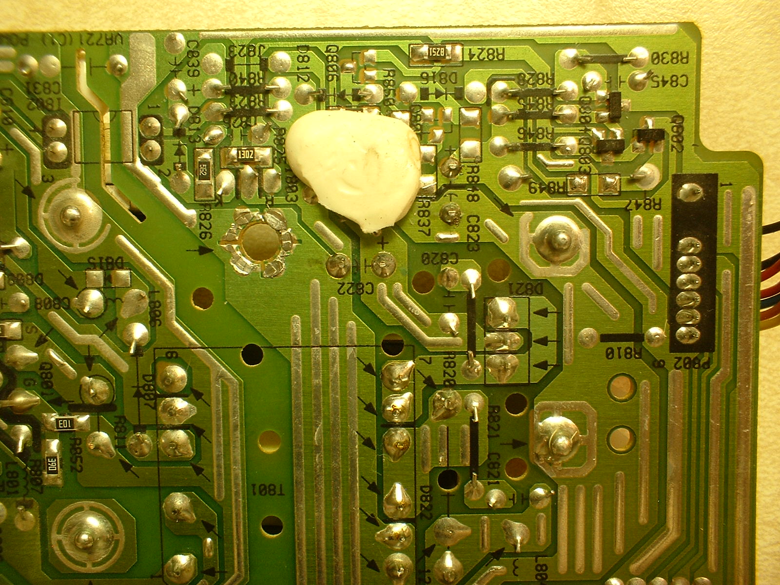

                      It's been dark for hours here but this is about the best i can do with my cheap older than dirt cam (fuji a200).
                      Where would q3 be and proper test method?
                      Also i was unsure on the 4 monitor plugs so maybe i had that wrong?

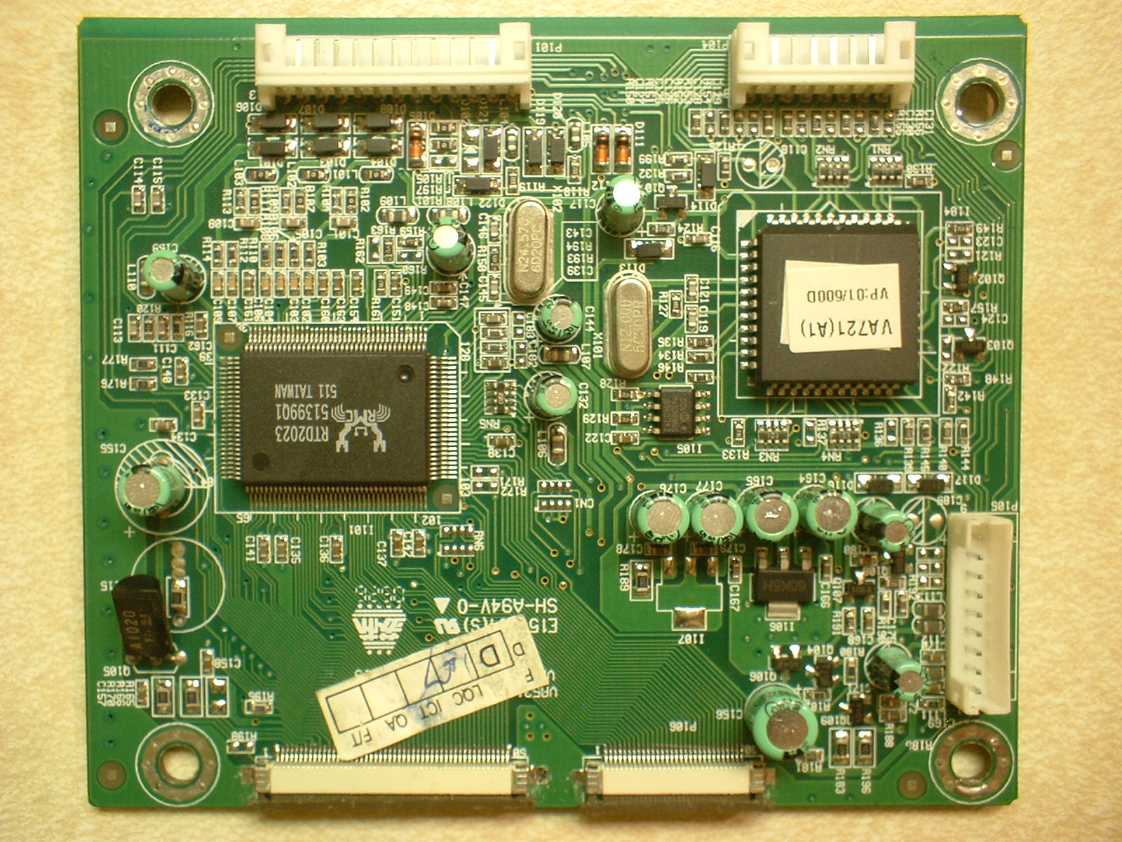

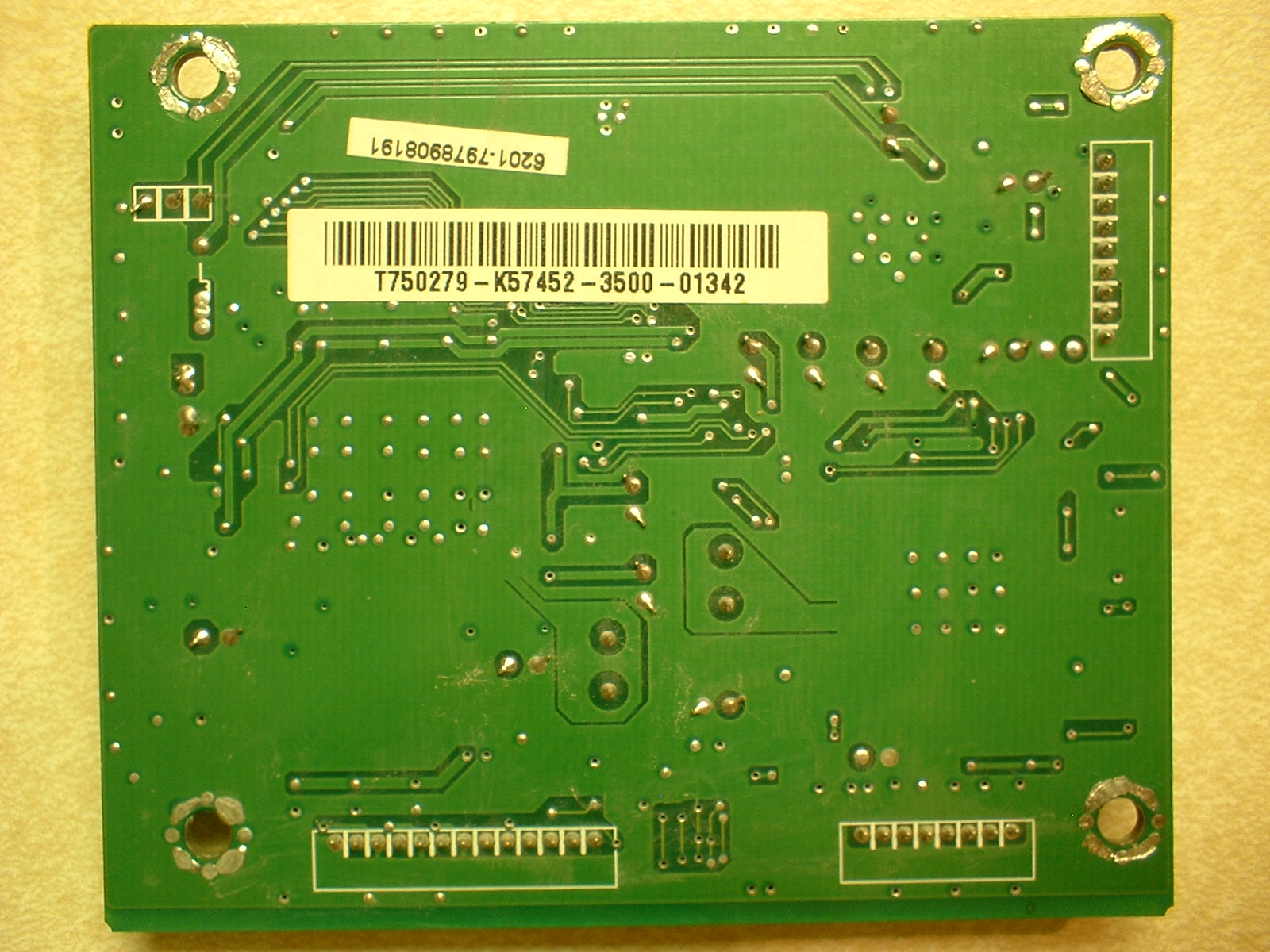

                      • retiredcaps
                        • Apr 2010
                        • 9271
                        #71
                        Nice clear photos, but most of us would prefer 1 picture of the top and 1 of the bottom instead of the quadrants.
                        Where are the pictures of the logic board (1 top and 1 bottom).
                        We need to verify that the logic board is getting the right voltage.

                        • mockingbird
                          • Dec 2008
                          • 5488
                          #72
                          I see a few small caps on the powerboard that have a plus vent. Are those Nichicons or did you not replace them?
                          • junktv
                            • Nov 2010
                            • 3065
                            #73
                            Here ya go.
                            On the pics sorry about that but if it's not realy close then they turn out blury.
                            Mockingbird, i didn't replace them.
