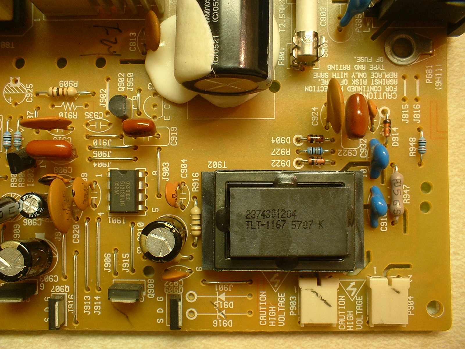

                      It's been dark for hours here but this is about the best i can do with my cheap older than dirt cam (fuji a200).
                      Where would q3 be and proper test method?
                      Also i was unsure on the 4 monitor plugs so maybe i had that wrong?

                        Nice clear photos, but most of us would prefer 1 picture of the top and 1 of the bottom instead of the quadrants.
                        Where are the pictures of the logic board (1 top and 1 bottom).
                        We need to verify that the logic board is getting the right voltage.

                          I see a few small caps on the powerboard that have a plus vent. Are those Nichicons or did you not replace them?

                            Here ya go.
                            On the pics sorry about that but if it's not realy close then they turn out blury.
                            Mockingbird, i didn't replace them.
