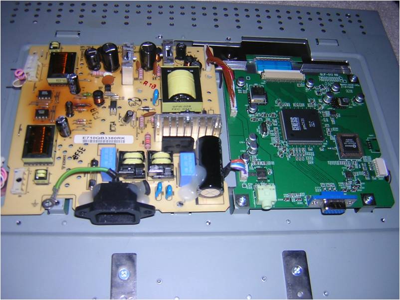

    Hi, I have an ACER AL1713m which does not turn on.
    What i have learned and what information I have gathered.
    1) When i plug in power to the monitor the LED does NOT come on.

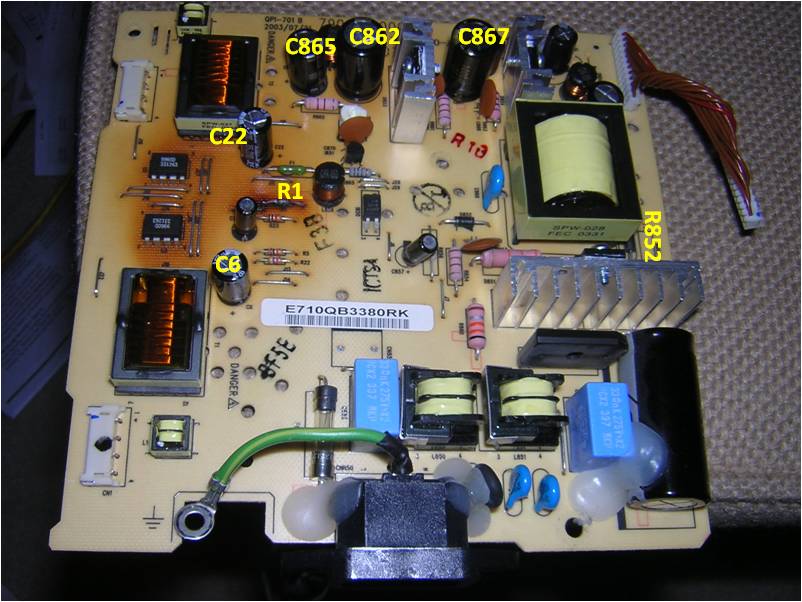

    2) I opened the monitor and found the following capacitors which were "bulging". I replaced the "bulging" capacitors.
    C867:1000UF/16v => replaced with 1000uF/25V
    C862: 1000uf/25v => replaced with 1000uF/25V
    C865: 470Uf/25v => replaced with 470uF/25V
    C22 and C6: 220uF/25V => replaced with 220uF/35V

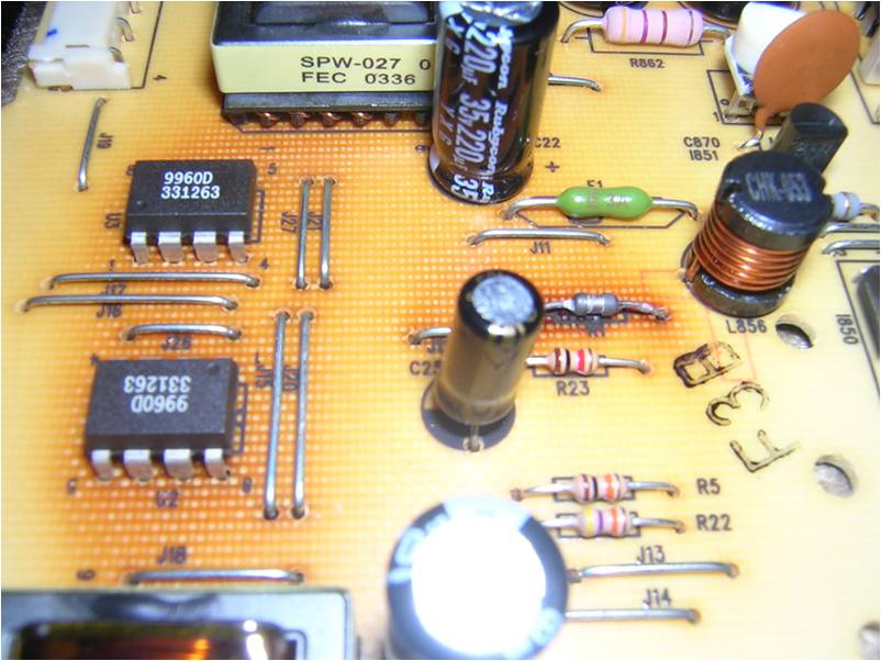

    3) I found resistor R1 was burned.
    From online literature I found that this resistor is supposed to be 10ohms,1/4watt. The resistor is visually burned up. I had trouble getting solder to “stick” to the holes which hold the resistor in place. I cleaned as best I could. Also, cleaned the leads of the resistor. I measured the resistance of R1 and it measured 13ohms. I re-soldered this resistor and put it back into the pcb. I would like a replacement but don't have one. With resistor R1 in place (although burned...see enclosed pics) the LED on light does NOT come on.

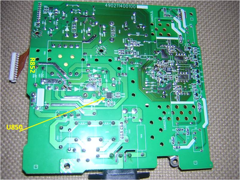

    If you look at page 26 it says that if no led lights comes on then check the "Q.P.I". I dont know what this is but if you jump to page 30 of the document it says to check device U850. I did not check this device as yet but I did look at some of the resistors R855, R857 and R852. According to the document i should check these resistors if there is a problem with U850.....i went ahead and assumed U850 would have a problem and looked at the resistors R855, R857 and R852. What i found was that resistor R852 measured only 0.5ohms. This seemed strange since the color band (i think....someone please confirm) says the resistance should be 938ohms. I dont have a replacement resistor for R852 but i think i should get one.
    Help:
    1) I know i should replace R1 but given that it still measures 13ohms.......i would think that with R1 in place as it is now i should at least get the LED to come on. Is this thinking flawed?

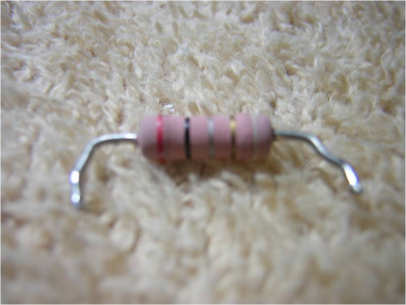

    2) R852: Did i read the resistor color band right? is the resistance 938ohms? I measure 0.5ohms. Could this 0.5ohms cause the LED not to come on or do you think there are other issues?
    Any help you can give or direction to trouble shooting would be helpful.

    It helps to know the standard resistor values. 938 is not a standard value. I read the resistor as red, black, silver, gold. This looks like a fusible resistor.

    R1 is disturbing. It's on page 45 of the Service Manual. It provides power to the inverter controller. No, that won't cause the 'No power LED' problem.
    But the inverter controller seems to be an OZ99R. I haven't been able to find a datasheet for that one, but the schematic will help. You can have chocolate - two M&Ms.

      Regarding Resistor R852.I see what your saying.........from the schematic it does appear to be 0.2ohm/1watt..........so this means the resistor is ok. RIght?
      For R1. I did find that i have two resistors in my "spare parts bin" that are 10ohm resistors. (both i bought from radio shack years ago). I have one that 10ohm and 1/2watt (5% tolerance) and another that is 10ohm Metal oxide resistor 1watt with 5% tolerance. I can give you the web site that i found the reference to 10ohm if you like....

        I measured the voltage on pin3 of the U850......i measured DV volts of (-78.1V). From the documentation the voltage is supposed to be 16V.......so something is wrong......right?
        I measured the pin3 voltage with power to the board and everything connected EXCEPT the speakers.

          It sounds like your making a mistake I have made in the past, ,there is a hot [hurt]side of the PS and a cold [low voltage side].To me it sounds like when you were measuring pin #3 you had the negative lead of your DVM hooked to the wrong ground point.

            ok......thanks. WHere should i measure the voltage from. Can you indicate on the picture where i should probe? Thanks.

                1. The part number for the SMPS controller is on the schematic.
                2. When measuring DC voltages on the 'Hot' side of the power supply use the negative lead of the large capacitor as ground, or in this case, pin 1 of the SG6841 (which is tied to ground) can be used.
                3. At this point I would not worry about the 10 ohm resistor.
                4. Yes, R852 is good.
