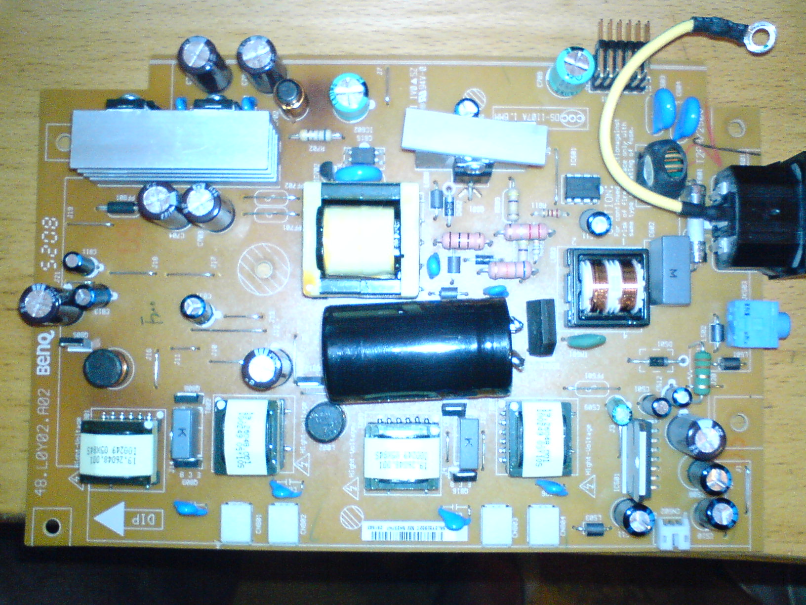

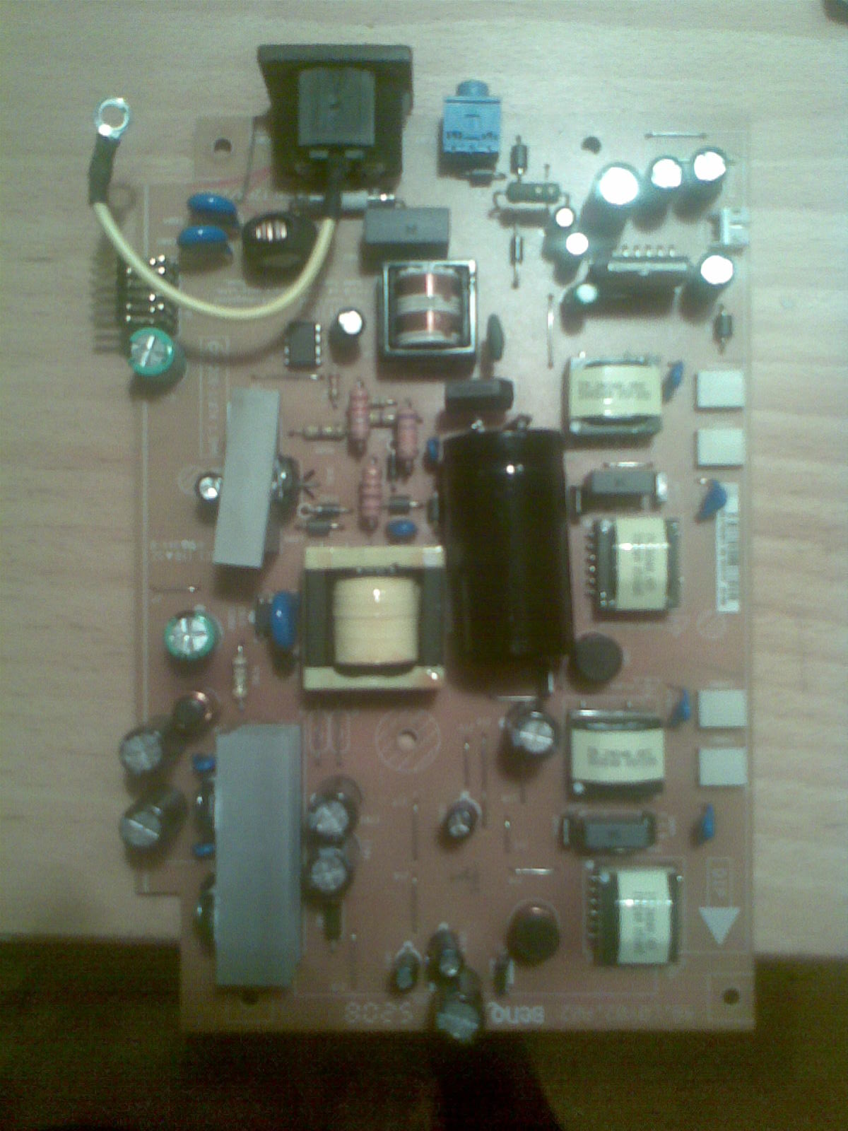

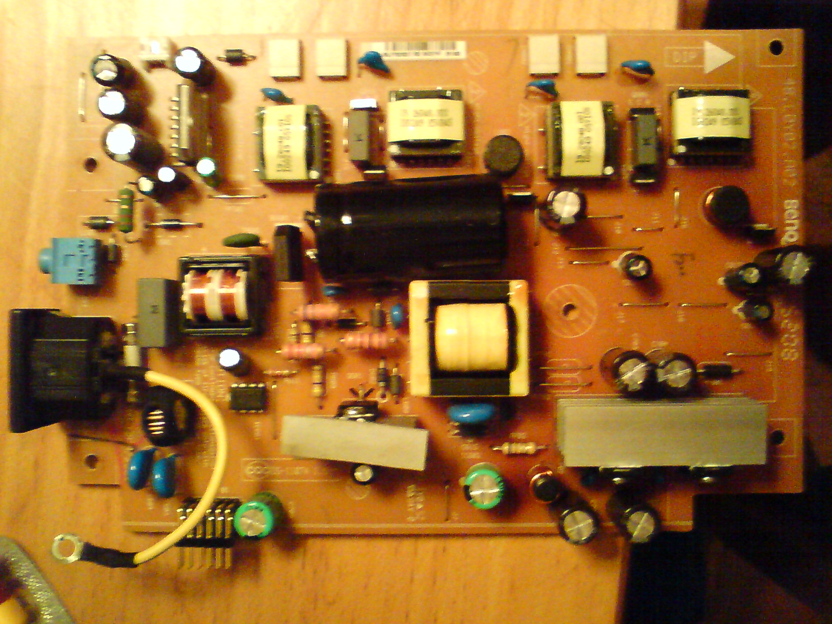

      Re: BENQ fp71e+
      there they are.
        Re: BENQ fp71e+
        Originally posted by rihardiii View Post
        there they are.
        That is the power/inverter board. The logic board is the one with the VGA connector.
        You will also need better photos as well.

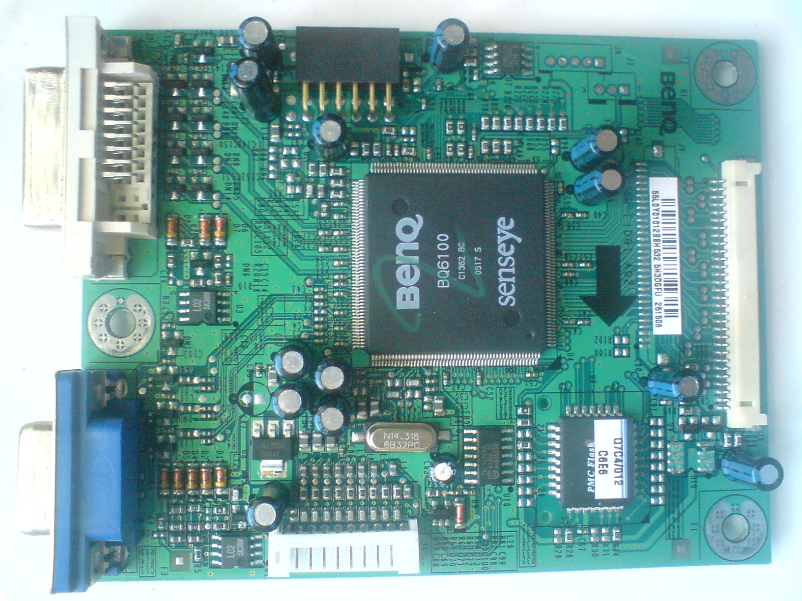

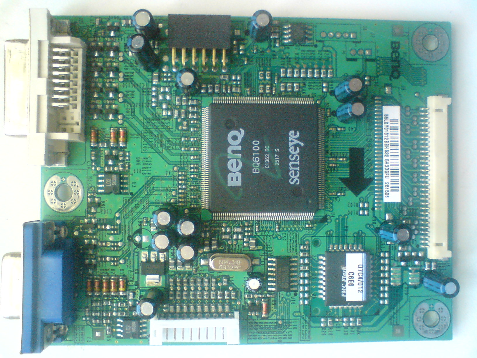

          Ok. Ill do it when ill get a chance, to take that picture. and for now there is 13 small caps, and 1 very smal cap.
            Re: BENQ fp71e+
            so, there they are. the best i could make.
              Re: BENQ fp71e+
              I can only think of 4 things to test/try.
              1) Try the alternate port. If you are using VGA, try the DVI to see if the same thing happens or not.
              2) U8 is a voltage regulator. Put your multimeter on 20V DC. Put your black probe on a ground screw. Put your red probe on the pins of U8. Report all voltage measurements. I'm expecting 0V, 5V, and probably 3.3V DC (or 1.8V).
              3) Blow a fan directly onto the logic card and see if the problem is heat related.
              4) Caps do not have to bloat to be bad. They can have incorrect uF or high ESR (ohm). As a last resort, you may want to try and replace all the caps.
