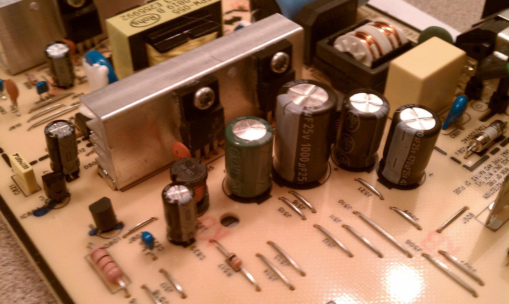

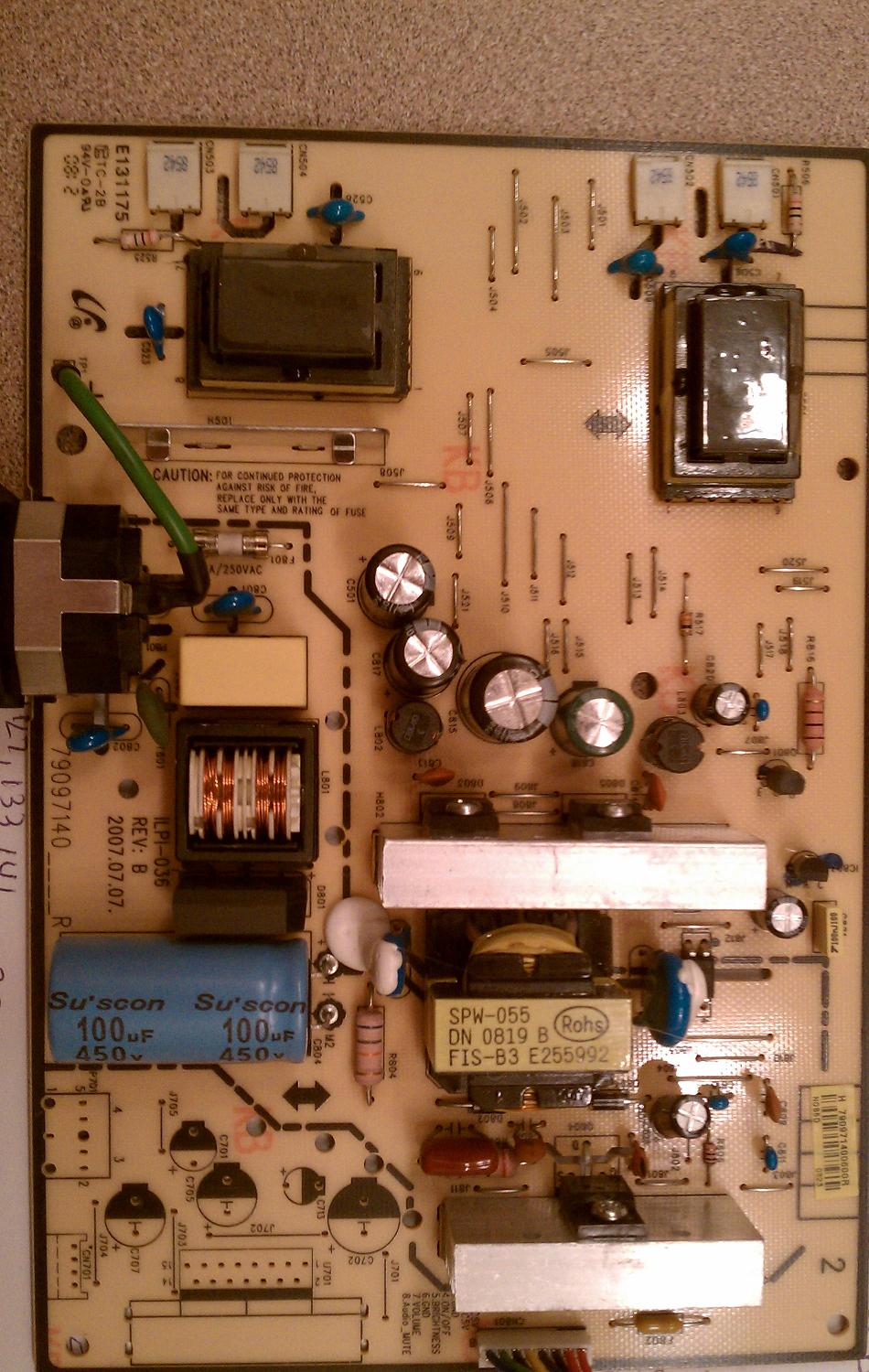

    Hello Everyone... I've spent the last couple of days absorbing the wealth of knowledge on this board -- THANKS!

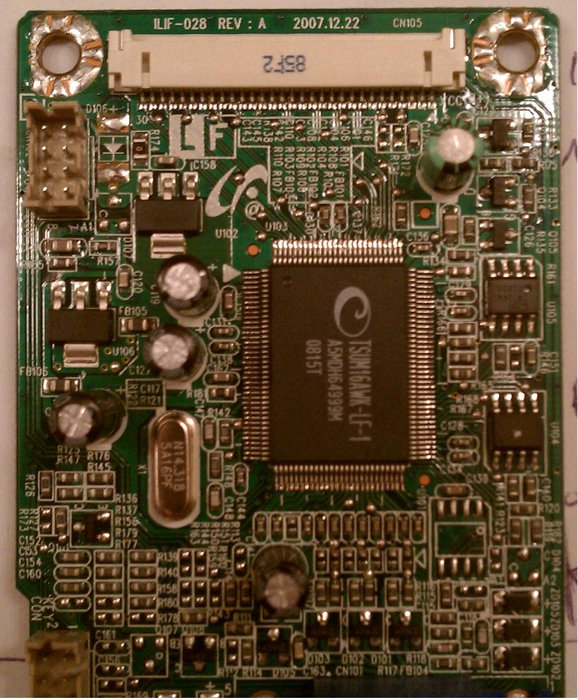

    I have a Samsung SyncMaster 920 19" widescreen LCD monitor that has recently started having troubles starting. When I apply power (with a VGA cable attached to the PC), the blue light comes on, I hear something in the power supply making a bit of noise, then it turns off. It seems to be about a 2 second cycle. I've been able to get it to start a handful of times, and it works fine once it is started.
    Note: If I remove the LCD ribbon, I can get the monitor to power on each time, and respond properly (obviously with an all-white screen).
    So I started digging around and I found that there is a swollen Samxon GK 1000uF 10v cap on the board. I would like to recap the PSU and the control board, but I'm having a bit of trouble matching up the proper replacement parts (ESR/ripple/etc). I was hoping someone could point me in the right direction on which series replacements I should use. My electronics knowledge is a little rusty, but from what I've been reading, ripple current needs to be equal or higher. Its mostly ESR I'm having trouble comparing. Do I just compare the impedance, or is there more to it?
    Here are the caps I'd like to replace (information was collected from the various data sheets):
    Code:
    Component	Value	Voltage	Model/Series	Brand	Ripple Current	Dimensions	Temp
    C820, 821, 826	47uF	25v	SH		Su'scon	110mA		8x12mm		125°
    C501, 817	470uF	25v	RZD		Lelon	1144mA		10x16mm		105°
    C818*		1000uF	10v	GK		Samxon	1430mA		10x16mm		105°
    C815		1000uF	25v	RZD		Lelon	1888mA		12.5x20mm	105°
    C119		100uF	16v	KM		Samxon	125mA		5x11mm		105°
    C124		220uF	10v	RGA		Lelon	175mA		6.3x11mm	105°
    C127, 133, 141	22uF	16v	SK		Su'scon	63mA		5x11mm		105°
    Thanks in advance!

    Re: SyncMaster 920 - Flashing blue led, power cycling, swollen cap in PSU
    That 1000uF 10V cap is providing the 5V DC to the logic board. If it is bad, that would explain why the logic board isn't working and thus no picture.

        Here is the parts list I'm looking at (in the same order of the parts in my previous post). All in stock at Digi-Key, less than $5 for all parts. If anyone notices something wrong/bad, please let me know...
        Note: The first component is originally a 125 degree piece -- I can't imagine that 125 would be necessary, but please correct me if I am wrong...
        Thanks again!
              Update!
              The monitor is working great! Thanks for all of your help, retiredcaps! And thanks to everyone else for building up a wealth of knowledge at this site.
              Again, thanks!
