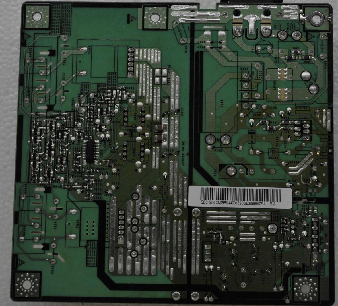

    heh.. i may or may not have tome tonight, but if i do i will take a bunch more pics, i definately do not have an issue posting there if it helps everyone out...
    im the meantime a revised pic from the op..

      It definitely looks like the two CCFLs are in series. Give it a try and see if any one CCFL will light up.

        you were right on the money plainbill.
        plugging in one ccfl plug at a time, i could see a glow about 1/3 of the way across the diffusers(lcd removed) except one plug did nothing. It was in the top ccfls, the one with the pink/wht wires. I pulled the diffusers and stuff down, the ccfl in question is literally fried, about 2mm missing, wire is fried going into the lamp, hell even the main diffuser got a little crispy in one spot..
        Now comes the fun part of trying to find these. It needs all four, theyre pretty rough looking. I cant believe the picture was not pink looking.

          Replacement CCFLs are easy - CCFLWarehouse or their eBay store, Plasmo Industries are a good source. Determining the diameter and length is a little more difficult. They aren't cheap, but a 26" monitor is worth it.
