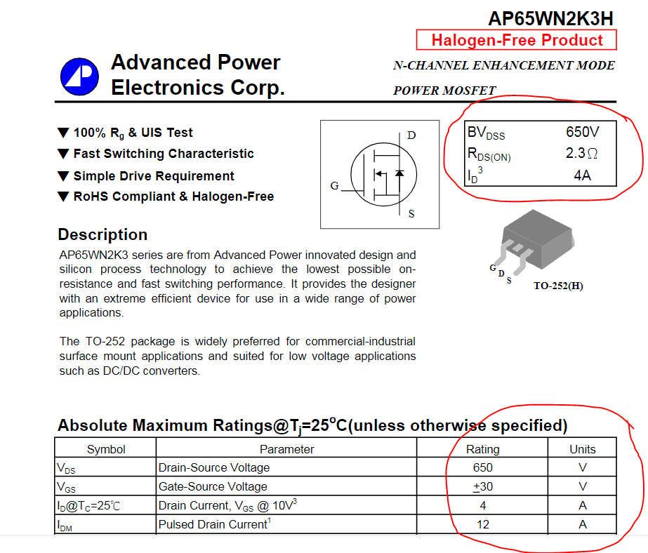

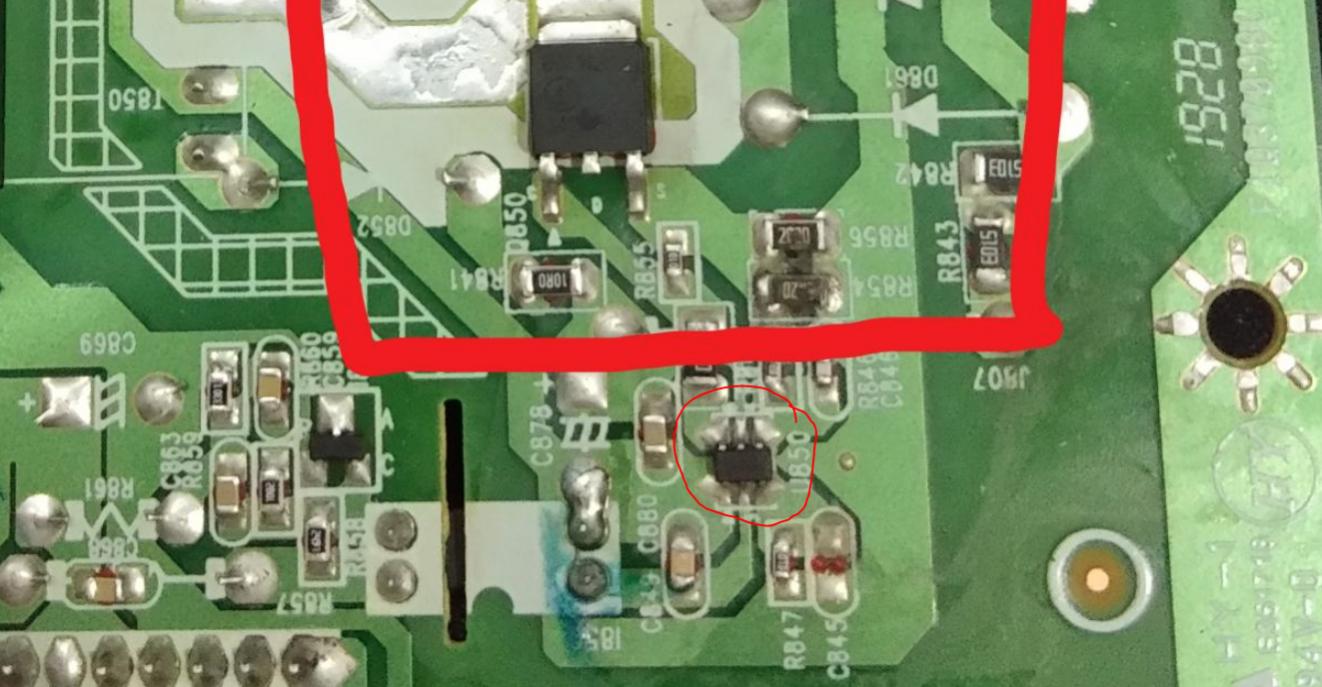

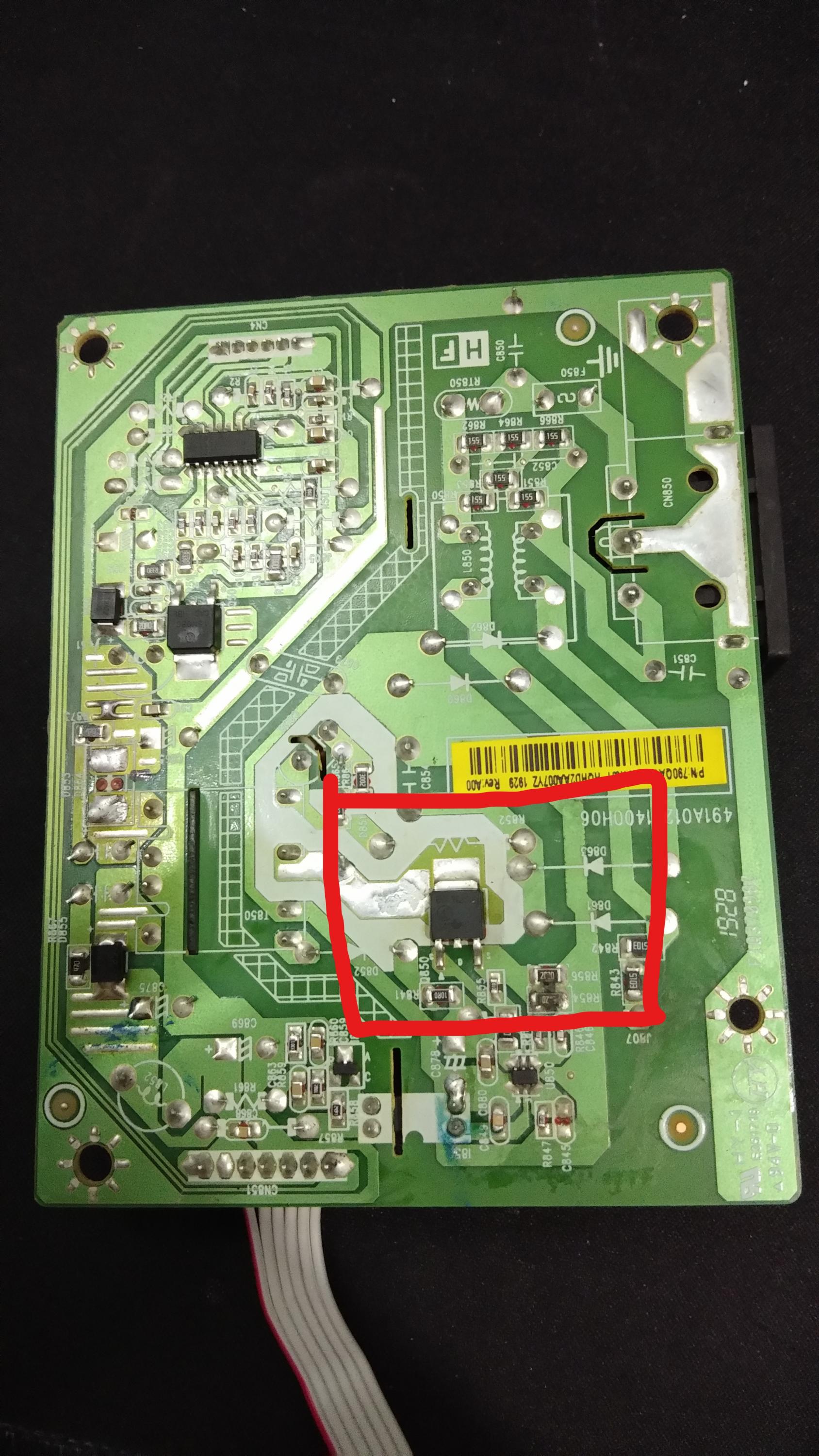

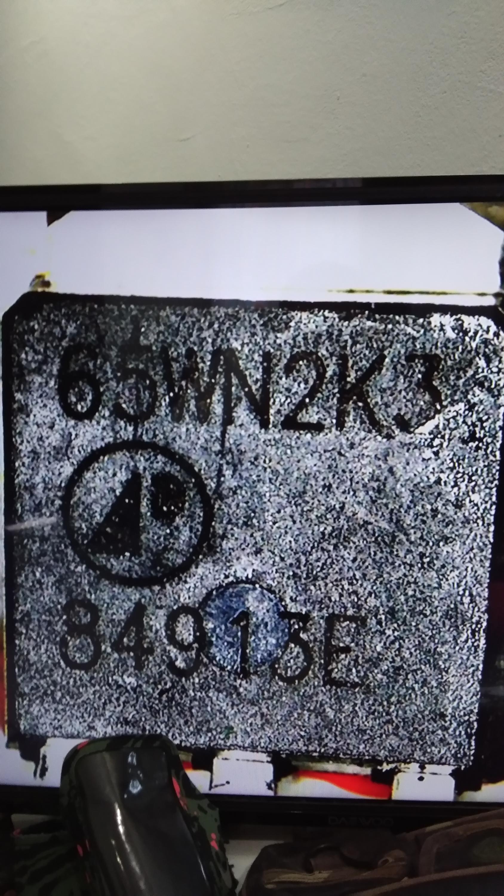

    Hello everyone. Greetings from Malaysia. I'm working on a Dell SE2419HR Power Board and I've identified a few components to be burnt. I can get the other components locally, but not the 65WN2K3 Mosfet. I was wondering if I could replace it with any other common models. If it is in fact possible, can I know what do I need to look for in the spec sheet when replacing the Mosfet.
    Thank you!
  • lotas
    • Jan 2016
    • 4786
    • Russia
    Re: Dell SE2419HR LCD Monitor
    If the MOSFet burned out, then with a probability of 99% the U850 burned out, to replace the mosfet, focus on these characteristics.

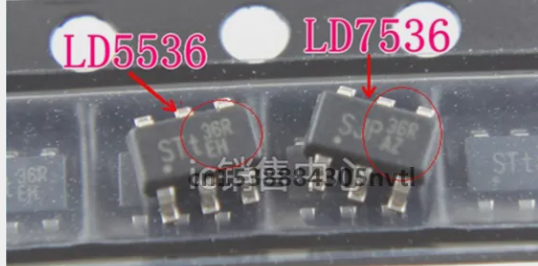

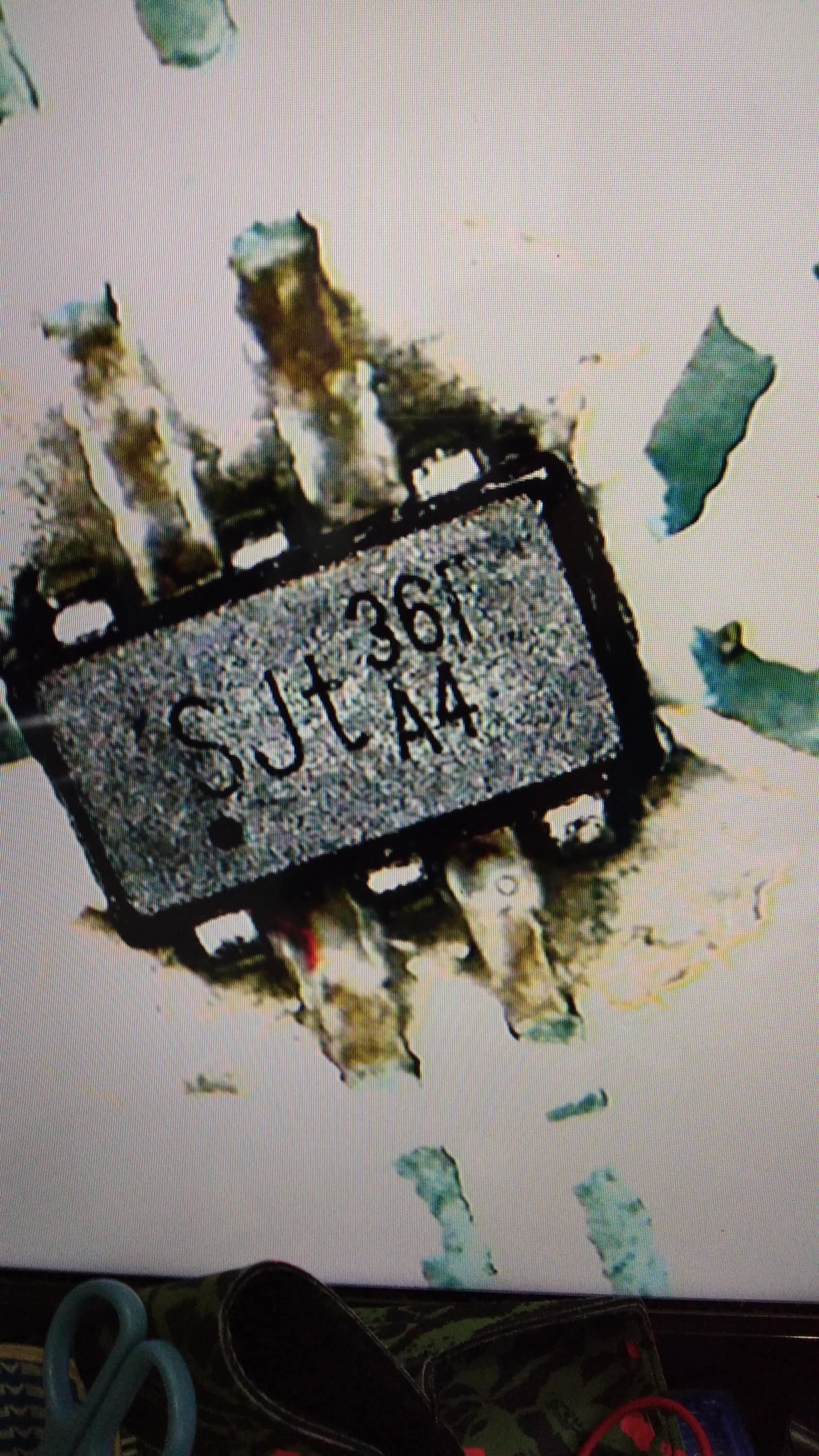

      Yes you are right! The U850 is burned out too. I tried googling the component but I'm not really sure what it is. Can you help me out? This is the marking on the component. Also, can I know which marking to look at. A4 right?
      • lotas
        • Jan 2016
        • 4786
        • Russia
        t36R - ld5536
        • lotas
          • Jan 2016
          • 4786
          • Russia
          Error, this is LD5536.
