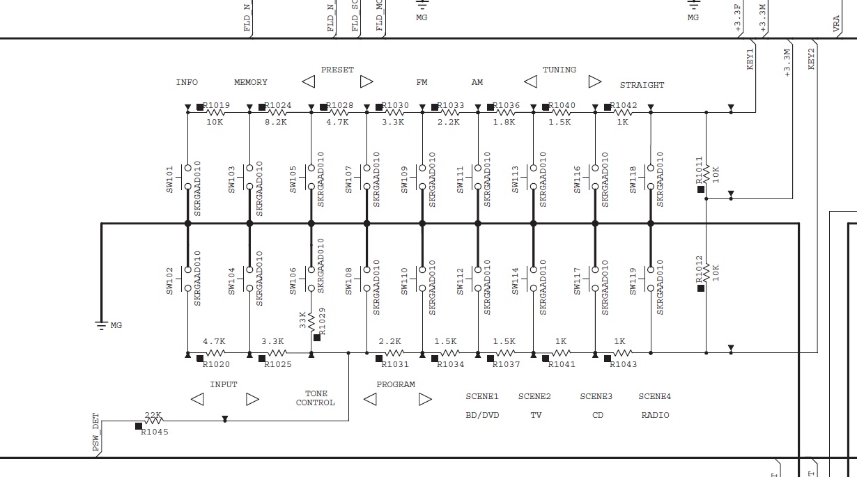

    Could someone please advise on this. I have this Yamaha taken from a friend for repair, especially since it had a USB for my interest. But it is not working at all.
    Here is what has been done so far. Checking the standby switch did not show 3.3 volts on one of its pins, the other was ground. it is showing as 0.60 volts. I have changed the switch as it had some resistance even when normally open. After changing the switch, I next saw that PIN 91 is not showing 3.3 volts.
    The processor clock pin show 2.8 on pin 18 (XOUT) and 0.80 on pin 20 (XIN). I am not sure if the processor itself is not working.
    Next, the CB 221 connector did not have +3.3M present on it due to bad connector pin contact with the flat cable. I did press it with a needle and now at least it shows 3.3 volts.
    Any suggestions/ideas or different ways will be helpful to me.

      I believe the /RESET pin should be high, When first plugged in and the cpu gets +3.3M Reset will go from Low to high, this happens fast.
      • redwire
        • Dec 2010
        • 3912
        Re: Yamaha RX-V373 no voltage on the standby switch
        You might have a stuck keyboard button?
        Power switch SW171 -> PSW_DET -> keyboard on OPERATION (1) -> CB221 as analog voltage KEY2 CPU pin 124 2.34-2.54V pressed. It should be high 3.3V with no button pressed.
        PSW_N_DET should be high 3.3V
        Next I would check 3D_PON CPU pin 84, R2253 to see if the CPU is turning on the +3.3D supply. +3.3M should always be up.
                    I have replaced the PFC cable and also tweaked the corresponding connector contact on CB221, ensuring it is in proper contact. Here are some of the voltages before (U) and after the key press (P), at CB221:
                    +3.3M = 3.3v (U/P)
                    KEY1 = 2.3v (U) and when pressed give random voltages.
                    KEY2 = 2.3v (U) and when pressed give random voltages.
                    PSW_N_DET : 1.4/0v
                    If you need any more voltage measurements for this connector, please let me know so I can note those down.
                    Any suggestions from the above information?

                              • R_J
                                • Jun 2012
                                • 9608
                                Originally posted by hemant_2222
                                I have ensured that the voltages are reaching the pins of key1 and key2. How much it should be ideally? It measures 2.3v in ideal conditions and when keys are pressed, the voltages drop, which are different for different keys.
                                What next can be checked, Any suggestions?
                                Look at page 88, +3.3M is on one side of R1012 Key2 on the other With no keys pressed there will be no current through R1012 (or R1011) so no voltage drop, so the voltage on either Key1 or key2 should also be 3.3v.
                                But IF one of the keys is pressed all the time, damaged, shorted, then it will cause the voltage to be lower and the microprocessor wont know what to do.
                                When the power button is pressed, one side of R1045 gets shorted to ground and a voltage divider is set up (22K+2.2K+1.5K+1.5K+1K+1K+10K)
                                The voltage measured between R1043 and R1012 (Key2) is the voltage the micro sees to understand the power button is pressed. Given the voltage and resistances, when the power button is pressed there should be about a 0.8 volt drop across R1012 so the voltage on Key2 should be about +2.5v with the power button pressed (3.3 when released)
                                On that same Key2 line, if TONE CONTROL button was pressed the voltage on Key2 would be about +2.65V, so a 1.5v difference between the micro knowing if the power button is pressed or the tone control button is pressed.
                                If the voltage is already at only 2.3v and not 3.3v the micro will never sense the power button being pressed.
                                If you check the voltage on the function switches, including power button, it should be ground on one side and +3.3v on the other, check each switch for voltage and if it is zero on both sides that switch is bad.

                                  • hemant_2222
                                    Hemant
                                    • Jul 2015
                                    • 69
                                    • India
                                    Super explanation. I will try this all soon.
                                    Considering the above detail, I removed R1042 and R1043 for isolation, the voltage on the other side (switches side) of the resistors is now 3.01 and 2.35v respectively. I will check more on this and update soon.
                                    What should be the voltage at the main power switch. It is now at 1.4v in normal condition.

                                      • R_J
                                        • Jun 2012
                                        • 9608
                                        That could cause part of the problem, there is a big difference between 4.2Ω and 100Ω, The voltages seen by the micro would be higher with the 4.2Ω so again it would see the wrong voltage and not know what to do. With R229 and R2230 removed, you can check the voltage on CB221 (pins 11,12) and see if it is +3.3 volts (no buttons pushed), If it is +3.3V then the fault is likely with the micro
                                        Look at the schematic, page 88. The voltage is supplied by +3.3M through R1012, you removed R1043 so there is NO way for the voltage to get to the switch PSW+_DET line
                                        If you removed R1042 and R1043, the voltage on the switch side? There is a switch on both sides! With those resistors removed there should be NO current through R1011 or R1012, so there would be NO voltage drop, also there should be +3.3v on one side of R1042/3 and 0 volts on the other side. on both sides of R1011 or R1012 since there IS a voltage drop (2.35v) on R1043, either on of those switches (SW119) is bad, or something on that KEY2 line is dropping the voltage, hopefully your microprocessor key2 input is not causing this.
