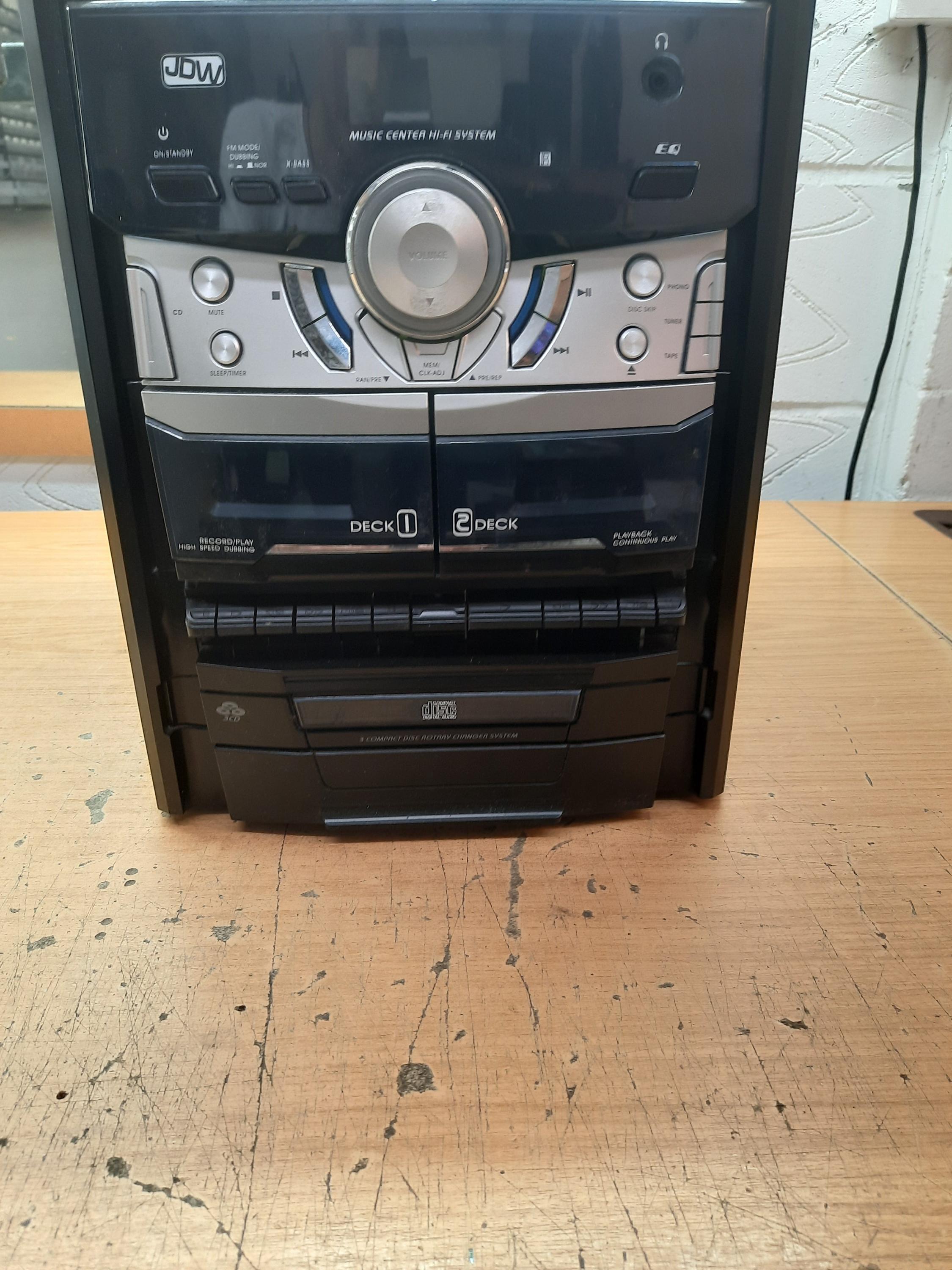

    Hi all
    This unit not ejecting CD tray.
    No motor/mechanical noise at all, therefore, might be a supply issue.

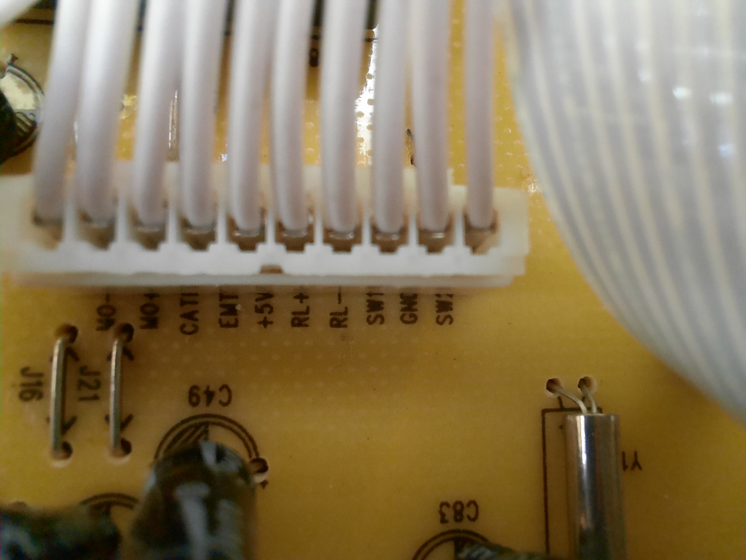

    Re: HF636P, JDW HI-FI schematic please
    On connector CON 7, measured 5V4 at pins marked MO + & MO -
    Could be for tray motor but need to strip out this 3 CD tray mech to find out.
    DOOR ERR appears in display.

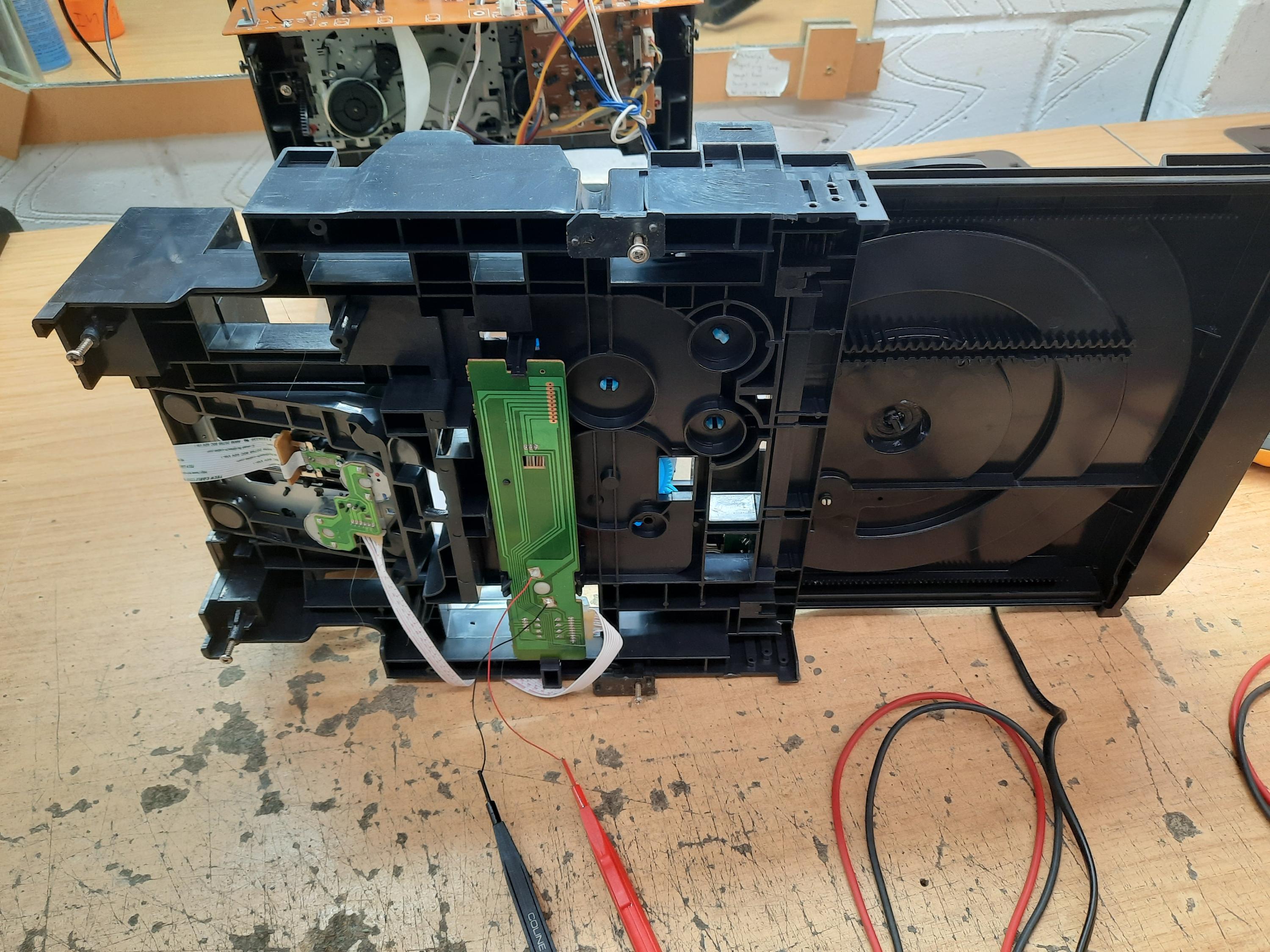

      Bit of a chore to strip mech out.
      Tested voltage directly at tray motor pins & 5V4 present.
      Gave the motor a little tap & the mech sprang into action.
      Need I say more?

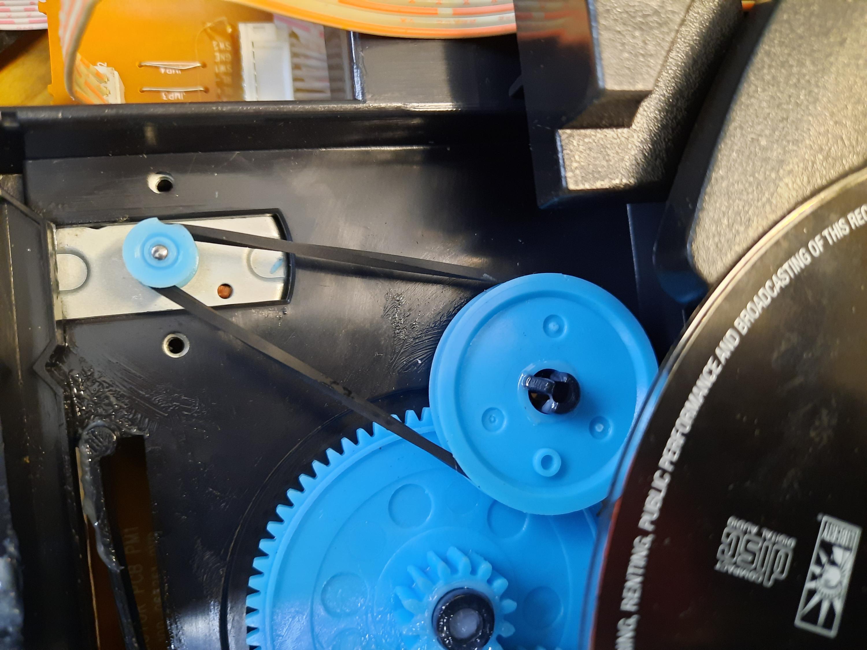

        Most likely stretched pasik (rubber belt) on the motor.
        • zen
          • 511
          Thanks very much for your input Lotas
          Not belt this time.
          Cleaned brushes & lubricated bearings with a very fine watchmaker oil.
          Working on test.
          • zen
            • 511
            Also replaced tray motor belt as it felt slightly slack.
