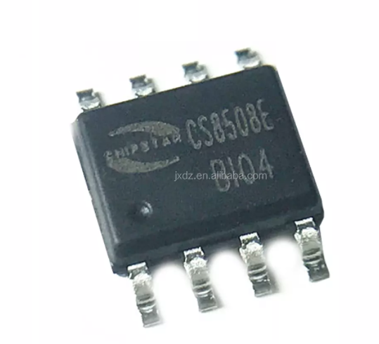

    Kindly please share pictures or identyfy damaged parts.
    Philips TAM2505/10
    It is about IC2 and IC4.
    Thank you

    Re: Philips TAM2505/10 - bad audio amplifiers. Help with identification
    It looks like, check the pinout.
    • lotas
      • Jan 2016
      • 4936
      • Russia
      Or CS8509E
      • rbvndonh
        • Mar 2021
        • 162
        • B
        Thank you for hints.
        It is for sure Chipstar. I can read CS85... on one the end looks like 8E.
        I see that 9E have same pinout, but looks to be better one to install?
        • rbvndonh
          • Mar 2021
          • 162
          • B
          Puchased original CS8508E. CS8590E have higher voltage, but bigger delay in ms (50vs200), so stay with OEM
          • lotas
            • Jan 2016
            • 4936
            • Russia
            The difference in voltage is only 0.4V, and in the delay it is large, it is correct that they chose CS8508E.
            • rbvndonh
              • Mar 2021
              • 162
              • B
              Working. Thanks
