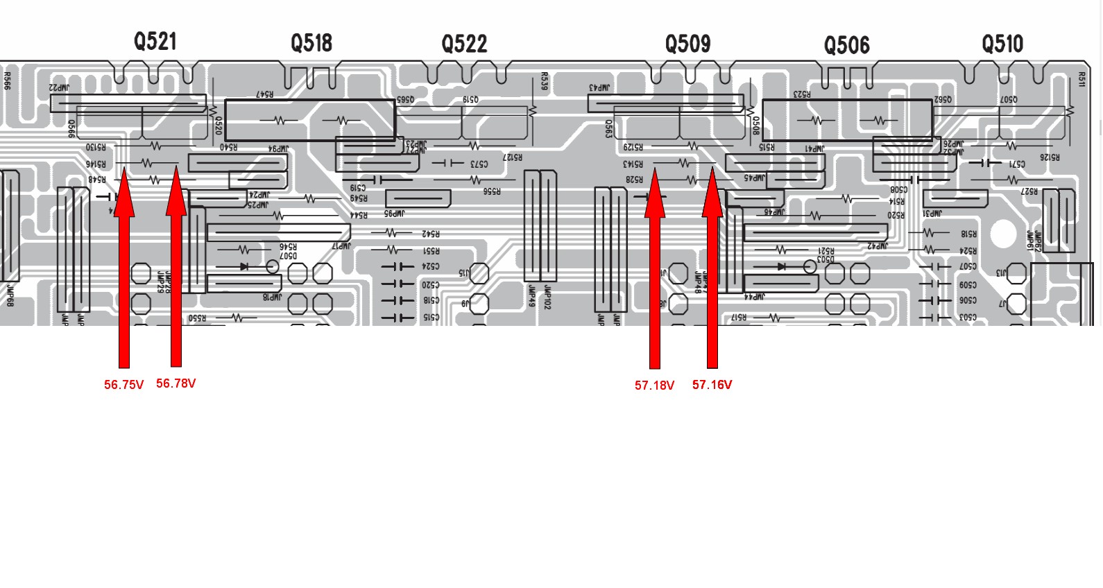

    Re: Help with blowing transistor NAD T752 receiver
    Originally posted by rddube
    Voltages on R5143 and R5146 is relative to ground on one end of the resistor (I can't see the point of measuring across a resistor, but maybe I'm mistaking?). Attached is the full service manual with all schematics. Tks.
    measure across to calculate the current .
    and with transistors base to emitter for vf . i often measure this to see if the transistor is likely ok .
      yes, measuring across is useful to calculate current or at least know the differential between two points. In this case actually this is VERY important as this tells the spread between the two bases of the driver transistors. The farther they are apart, the more likely that they will both be on ... and kill each other.
      Measuring the voltage WRT to GND of one pin on a resistor without telling which one it is...now this unfortunately is not very useful to me...
      Thanks for the schematic, now know what resistor you're talking about.
        Ok, now I get it..sorry, I'm not that experienced but you're right and thank you for the explanation..I will retake measurements on both pins of both resistors R5143 and R5146 and report back. I will show on the diagram the voltages for you. Keep in mind that bothe Q509 and Q510 + Q521 and Q522 are not installed. Tks again!
          Here are the results of the measurements in the photo.
            please take note whether its positive or negative voltages .this is important when using ground as reference .
            example .. 56v ....-56v ..
              Incidentally, if you short Q518/Q506's E and B together (or short B to the negative rail), this is one way to cause the downstream resistors and transistors to blow. Trying to figure out what you could have done to short them by a probe slip, as the pinout of the transistor does not make this easy as C is in the center...
              Theoretically other permutations (C-E short or C-B short) should not cause failure of the drivers as far as I can tell...
              50V on either pin is still way too high IMHO and the spread between base pins, still would suspect Q565/Q562 short assuming +50V at the resistor (versus -50V)...what's the voltage at B and E of these two transistors?
              Thanks Pete, yes, the sign of the voltage is also very important too when measuring WRT to GND. This will help pinpoint which side of the two (upper, lower) to look for clues...
                Redid the readings and they are all positive + both sides of each resistor.
                  I had installed 2 wires on E and on C (to measure between E to C) on Q506 and Q518, and it's when I was taking readings on the E side of Q518 that I slipped and touched the C side of Q518 and that's where I heard a noise and the resistor become hot because the output transistors had gone short.
                  "50V on either pin is still way too high IMHO and the spread between base pins," remember when I had good output transistors before I cooked them by accident, I was getting -6.08V at one of the 2 sides of R5146, and now I am getting 58V without the output transistors. Could they be required by any chance?
                  As for the readings on B and E on Q565/Q562 I will have to dissassemble and solder some wires as it is way too crowded down there with not much room to go and probe. Do you want me to to this? I am attaching a photo of what it looks like down there, it is under that little ceramic filter that you see in the photo.
                    The resistor getting hot is the reason (or a causal symptom) why the output transistors shorted. When the resistor gets hot, there is a huge differential across the resistor, which means the bases of the output transistors are wider apart -- and because of that, they both can be on at the same time, causing a rail to rail short, heating the transistors and burning them. So no, the output transistors shorting would not cause the resistor to heat up, rather it's collateral failure of an upstream issue.
                    Well don't know what to say, without data it's hard to make a judgment to pinpoint the rootcause... no access to the bottom of the board?
                    BTW you do have center channel and surround channels that are still intact? If you're not comfortable probing, don't short and cause more damage. One tech tip is to tape up the DMM probes so that only the tips are exposed, might help against some accidental shorts but won't help bridging adjacent pins.
