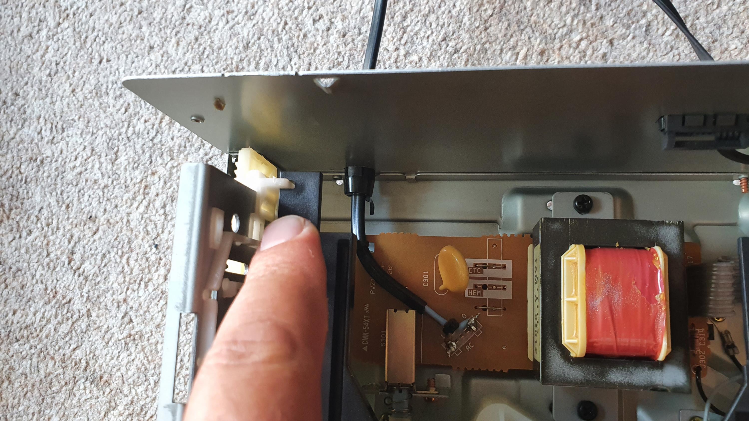

    Hi, i have got one Pioneer PD-Z560T 2 CDs player. The problem is that it is open tray 2 but close it immdetiatelly and does not open tray 1 at all. At the same time it does not play the CD which i managed to insert into tray 2. Just uploaded some short videot here as it is not very easy to explain that is happening. I can hear some noice as something is trying to spin the disc or something but do not have any idea when it is coming from.
    Any advises, please? Thanks.

    And it is already fixed
    Just one of the tray could not click into one of the plastic holder or something. Really do not know how to explain it:
    Just forced the tray a little bit so to click into it and now all works fine. Listening to Snoop Dogg now
    Will leave that here just for the history.
    Thanks all for readng.
