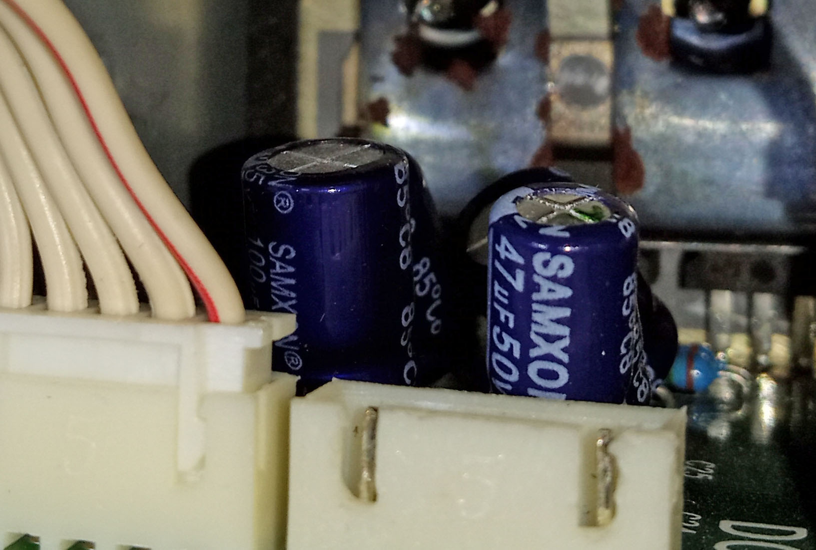

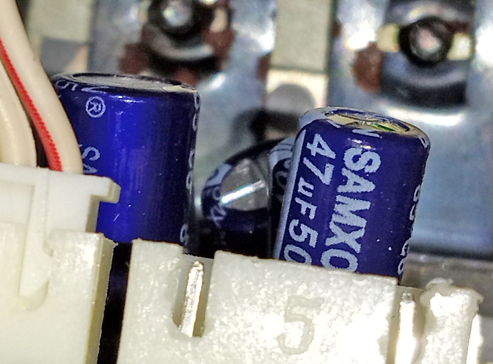

Klipsch computer subwoofer speakers hissing buzzing. Does this look like bad cap?

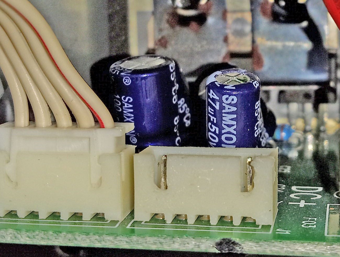

    Klipsch 4.1 computer speakers hissing.

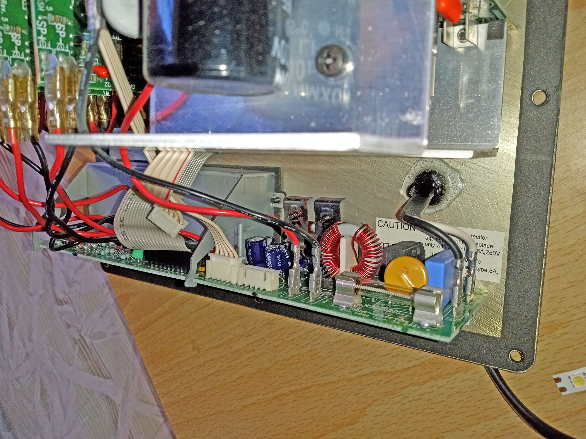

    Looking at all the caps on the amplifier, they all seem flat, except one maybe.

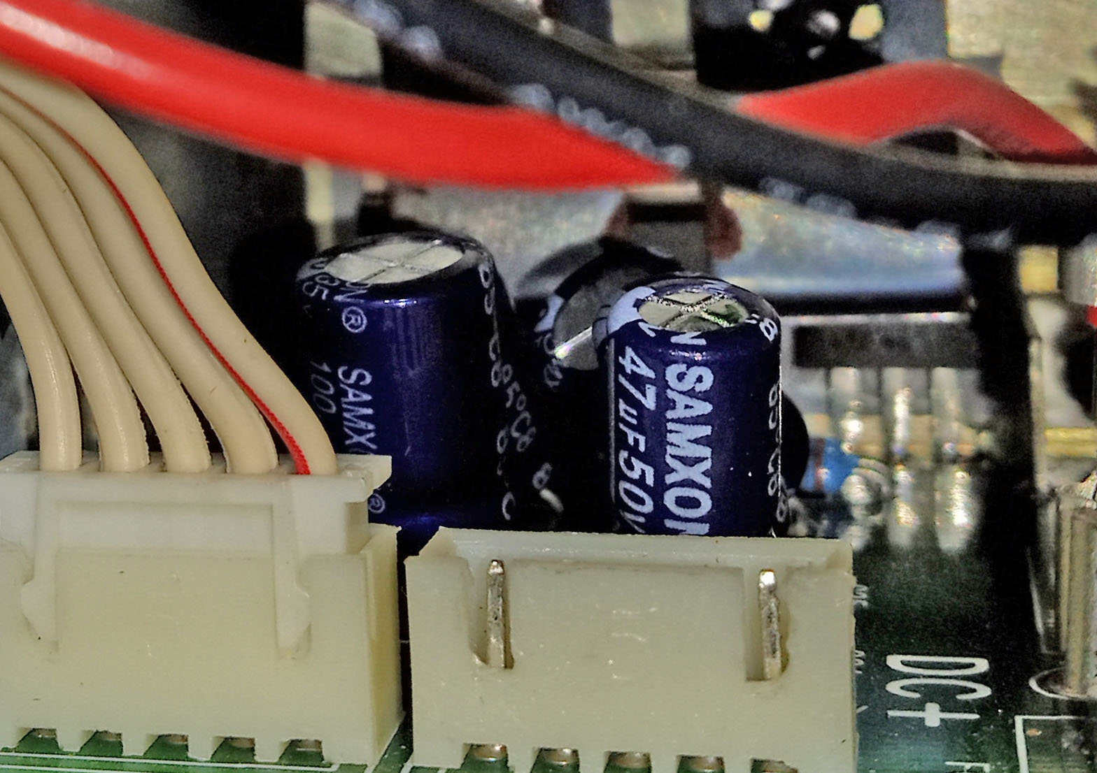

    Not sure if this is leakage, or factory marker pen.
    Can you tell?
    The speaker system recently developed nonstop hissing noise. after 22 years.
    Is there a special kind of cap I have to buy?
    Low ESR? or general?
    I see these for sale.... Panasonic FC 47uF 50v low ESR radial Capacitors caps 105C New low impedance

    Capacitors rated for 85°C are always "general purpose" capacitors (a capacitor grade).
    You should not replace them with low ESR capacitors because the circuit might not be designed to handle that.
    I would recommend United Chemi-Con KMG series capacitors, but really any "general purpose" series of capacitor from a reputable brand should do just fine.
    It is likely that after so many years at least the small capacitors have dried out inside, then they wont bulge, but still be just as dead

        Usually linear supplies are not sensitive to low ESR, only one way to find out
          Re: Klipsch computer subwoofer speakers hissing buzzing. Does this look like bad cap?
          Looks like a minor bulge, to me! A noob will think it's OK!

            bad confirmed
            old samxon 47uf measured 9uf.
            replaced with panasonic 47uf low esr.
            seems to be working. knock on wood.
              welp. old cap was bad
              but it didn't fix the issue. buzzing still comes and goes.
              Maybe there are other bad caps.
                the other 47uf cap was also bad, but not bloated.
                both 47uf measured 9uf.
                both caps replaced now. Didn't hear the loud hissing when plugging in the sub.
                hopefully fixed for good this time.
