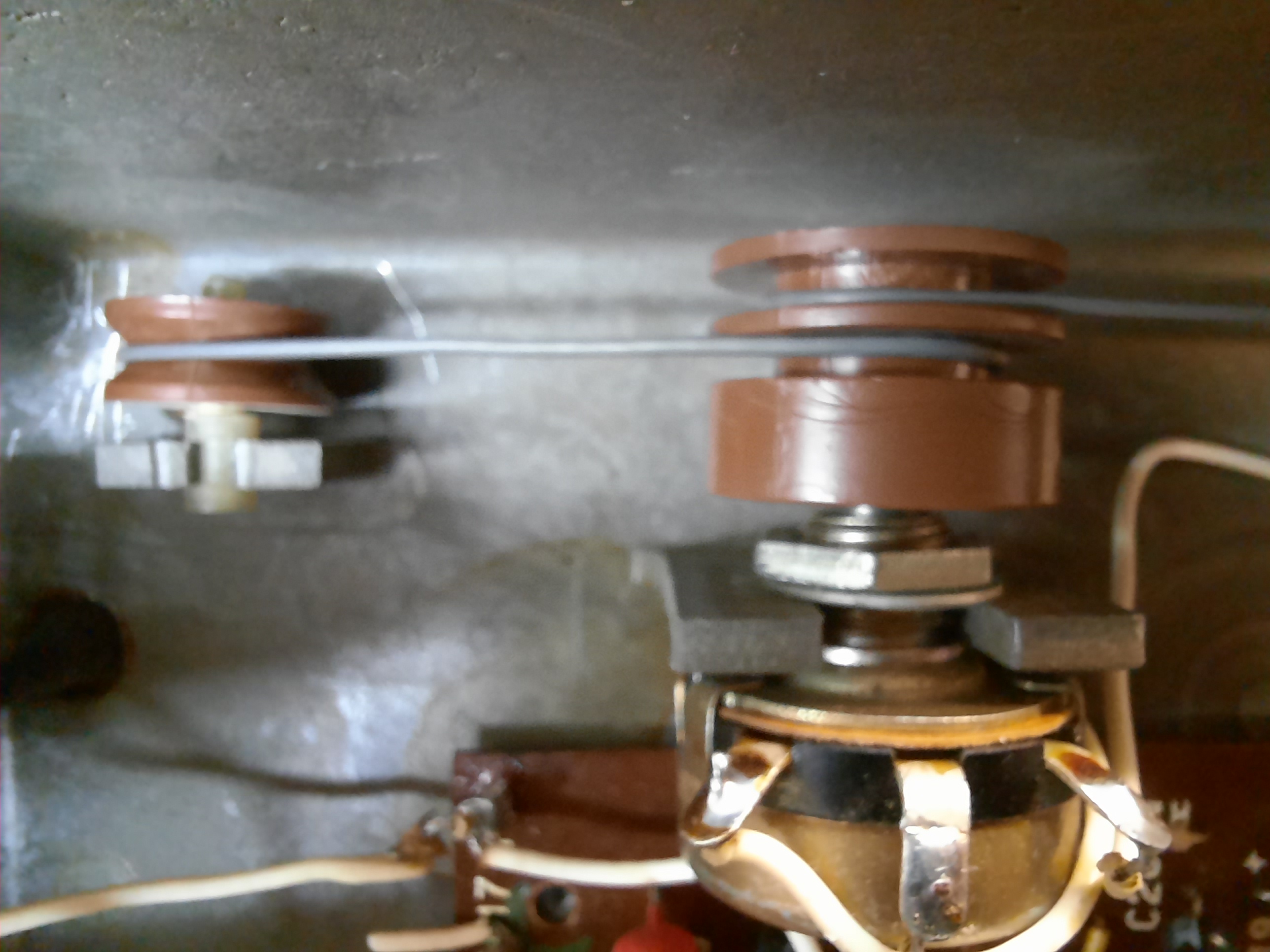

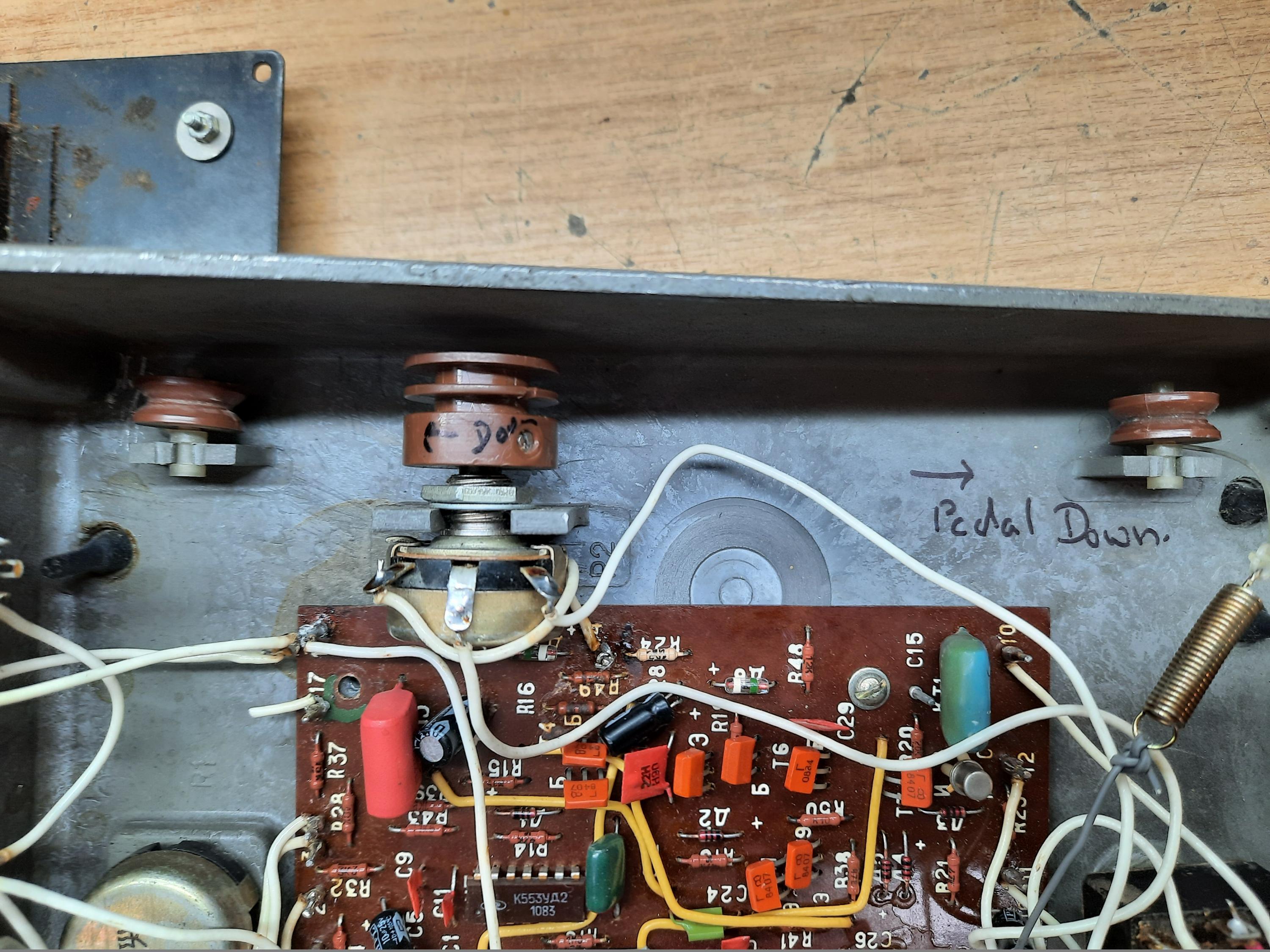

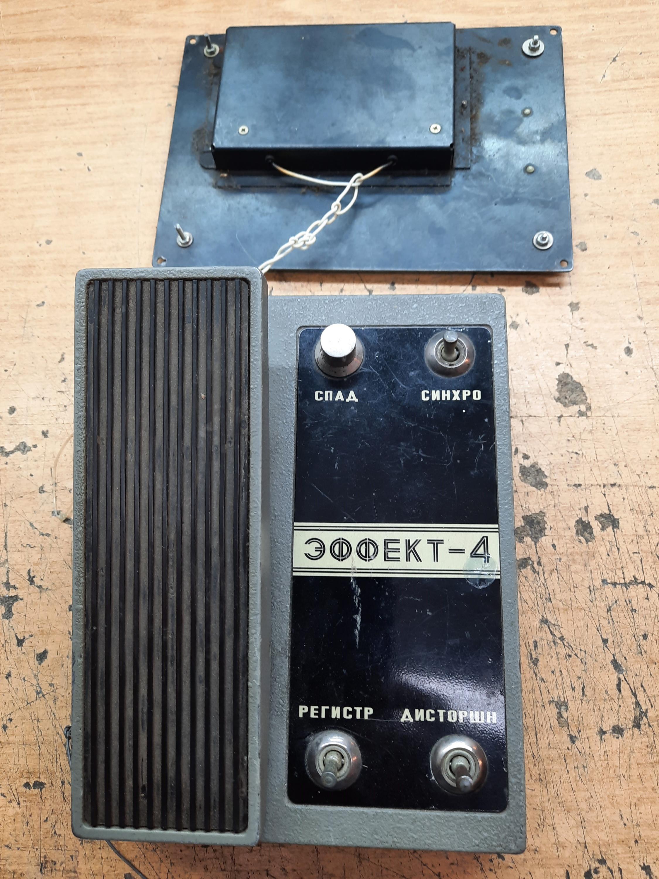

Foot pedal re-stringing diagram / advice please
  • zen
    • 511
    Any help much appreciated

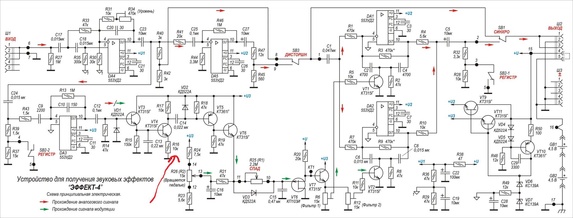

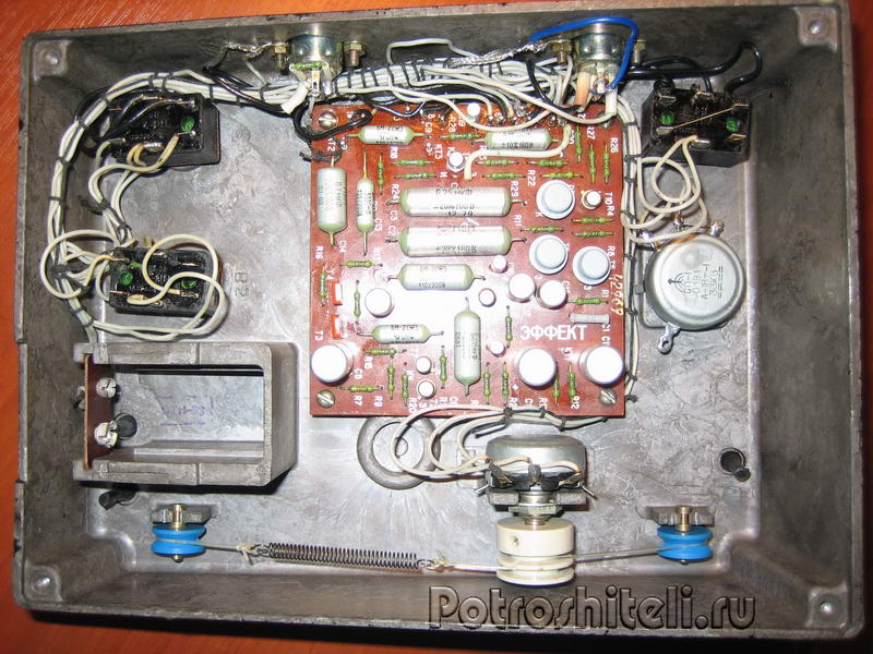

    Re: Foot pedal re-stringing diagram / advice please
    This is a soviet guitar prefix, the arrow indicates the resistor that you need to check on your 10 kOhm board and check VT4
    • redwire
      • Dec 2010
      • 3900
      I would get the model number in Cyrillic and search yandex for it. Or even similar models use the same string/pulley system. Maybe post here:
      http://sovietguitars.com/e107_plugin...ewforum.php?48
      The hard part is getting 270° rotation between full up and down of the pedal and I can't see the pedal pulley.
      Your R16 looks burnt- but it's more like glue is on it. 10k needs a lot of voltage to cook. A Q-tip and IPA can clean things up on the board.

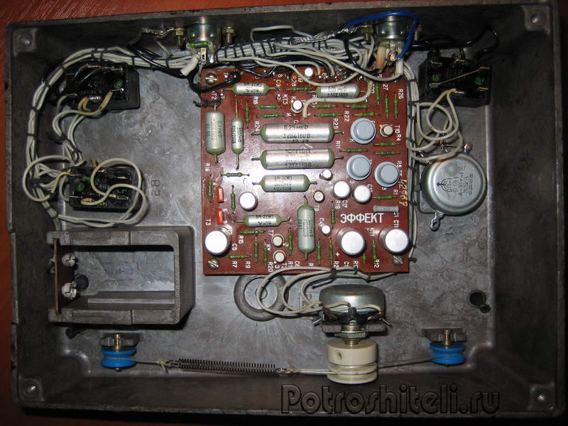

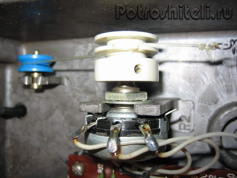

            • R_J
              • Jun 2012
              • 9514

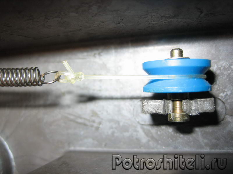

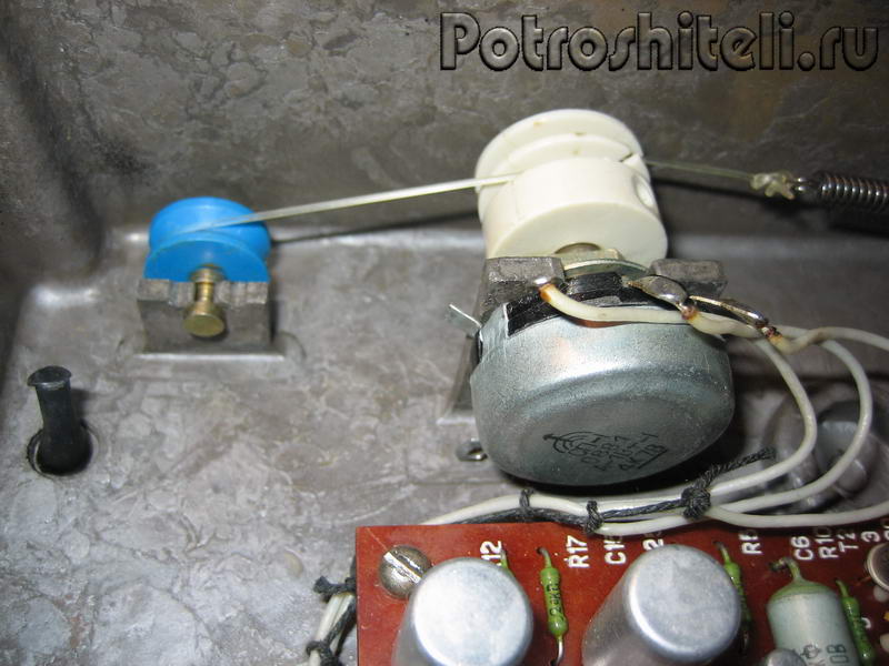

              This is what I found: This is the site: http://www.potroshiteli.ru/Reviews/Other/Fuzz.html
              • zen
                • 511
                Great RJ thanks
                Looks like string loops round once over the pot wheel .
                Should be able to sort it now .

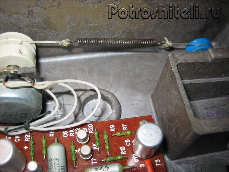

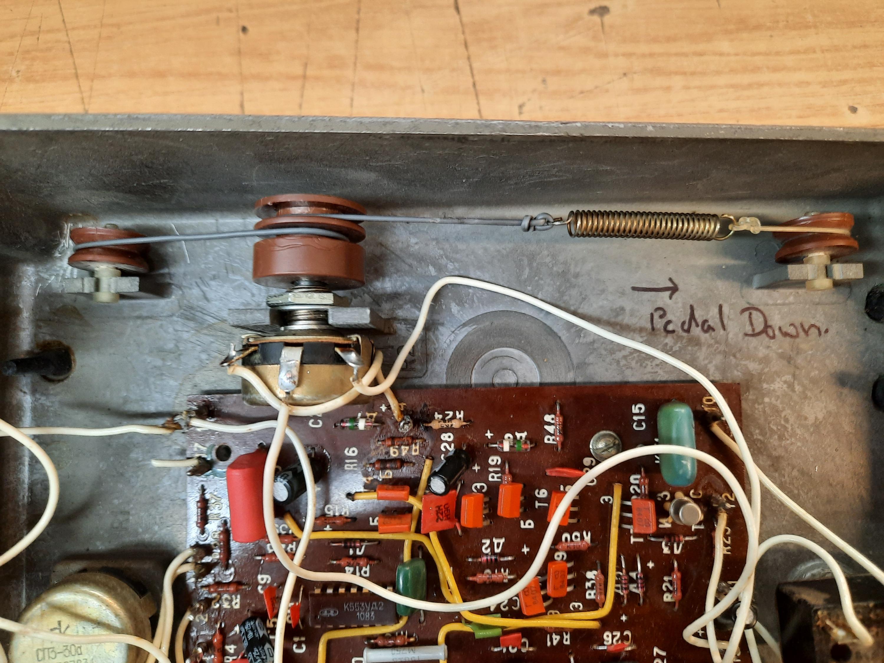

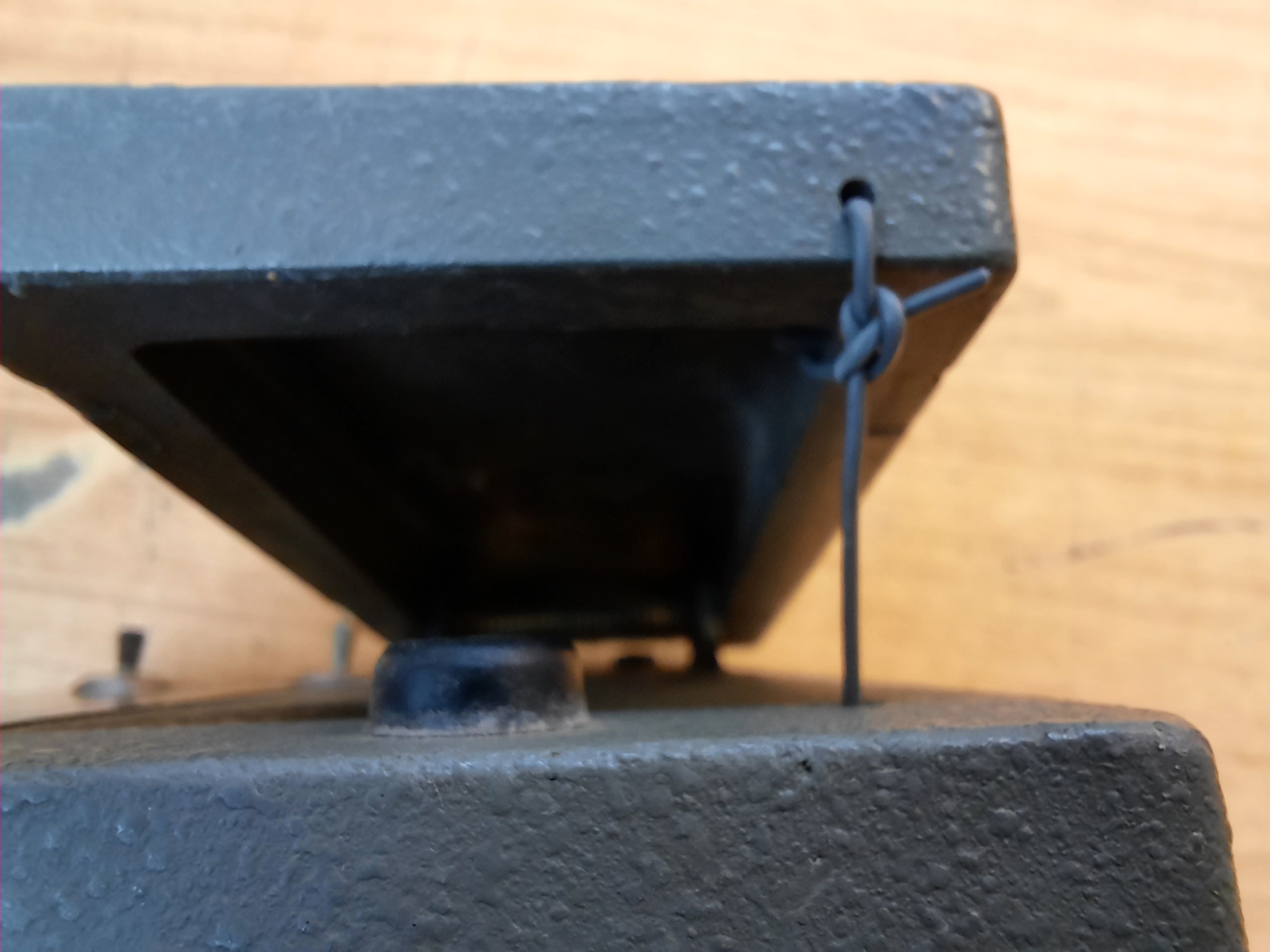

                • zen
                  • 511
                  Have managed to string it .
                  Don't seem to have the full range of movement from the pot , but i doubt that was ever the case .
                  Will test & report back .
                  Here's some pictures for now .
                  • zen
                    • 511
                    10K resistor mentioned by Skynet85 measuring good .
