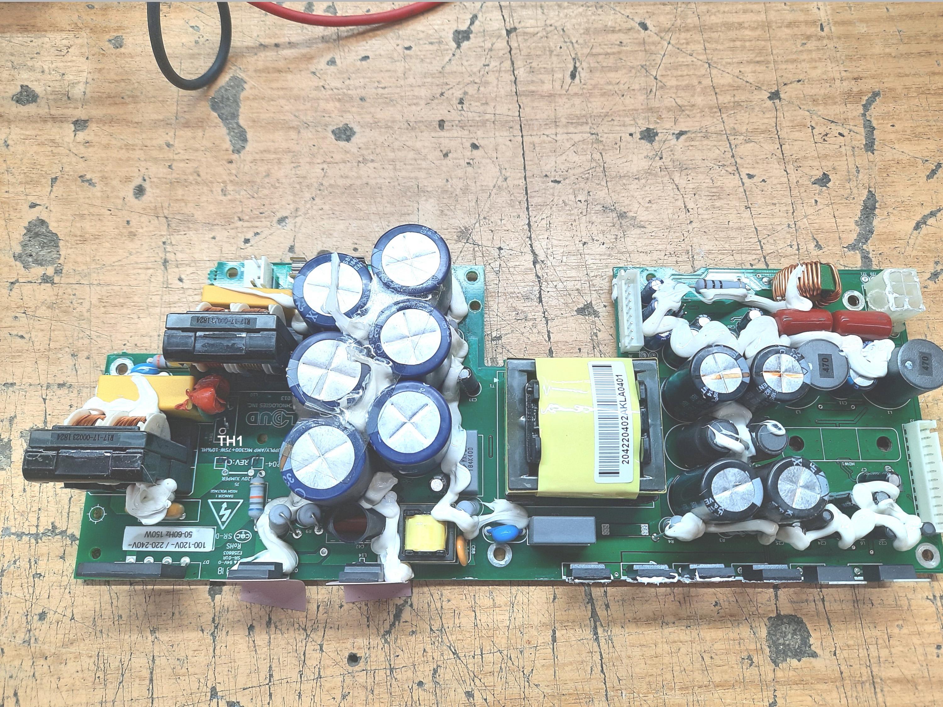

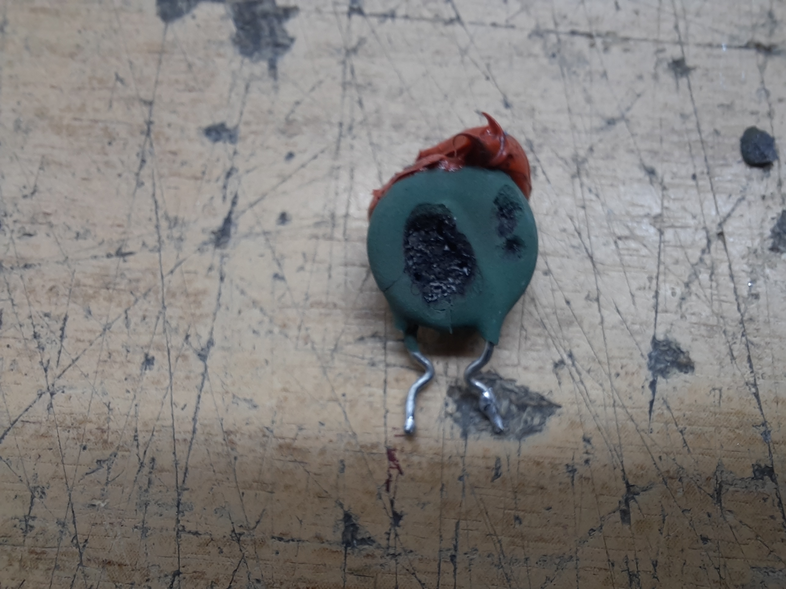

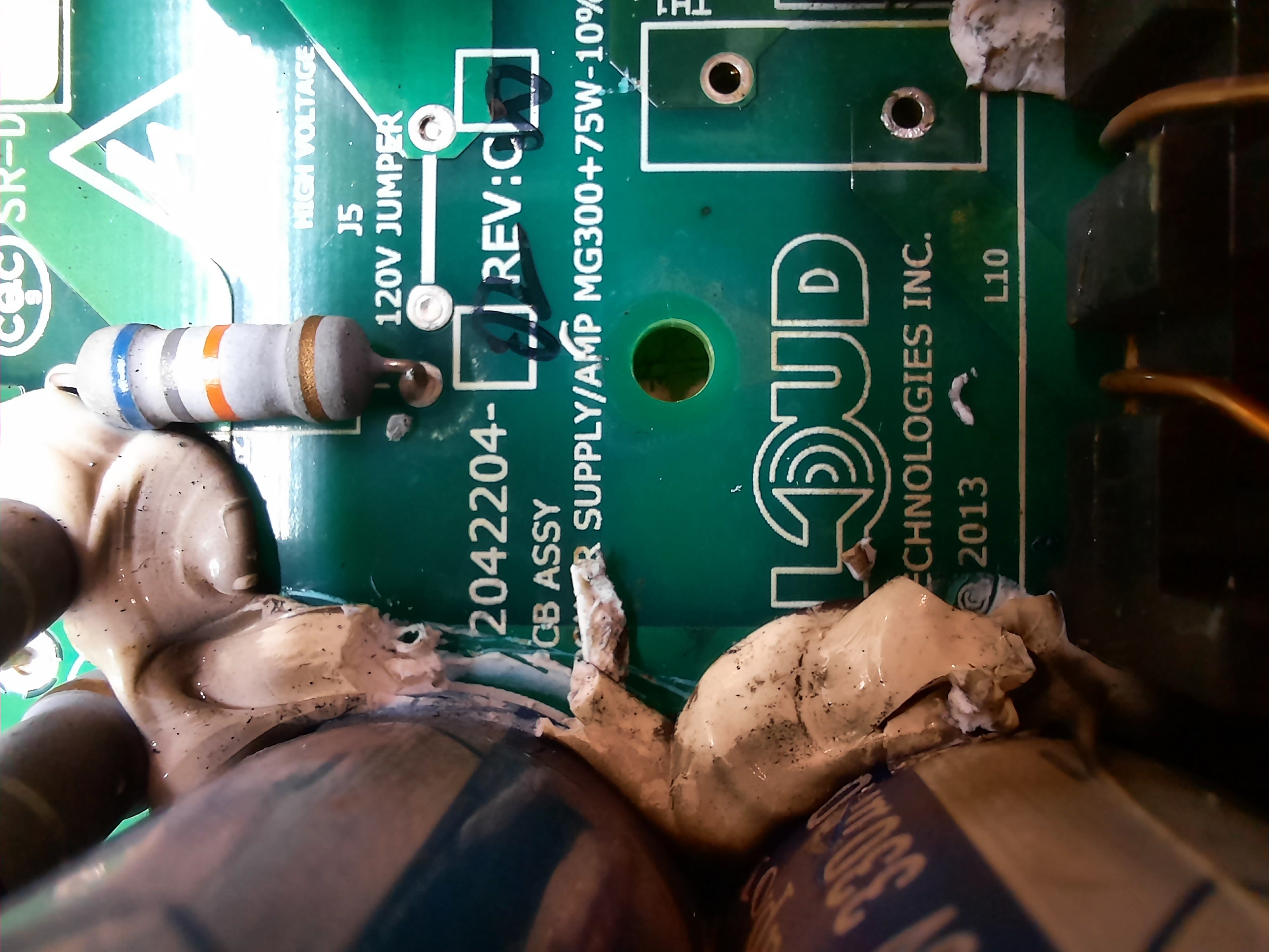

    Hi all
    This is my next project .
    Thermistor blown & cannot identify type .
    Can anyone help?
  • zen
    • 511
    Re: SRM450 Mackie speaker part id help .
    Nothing in service manual .

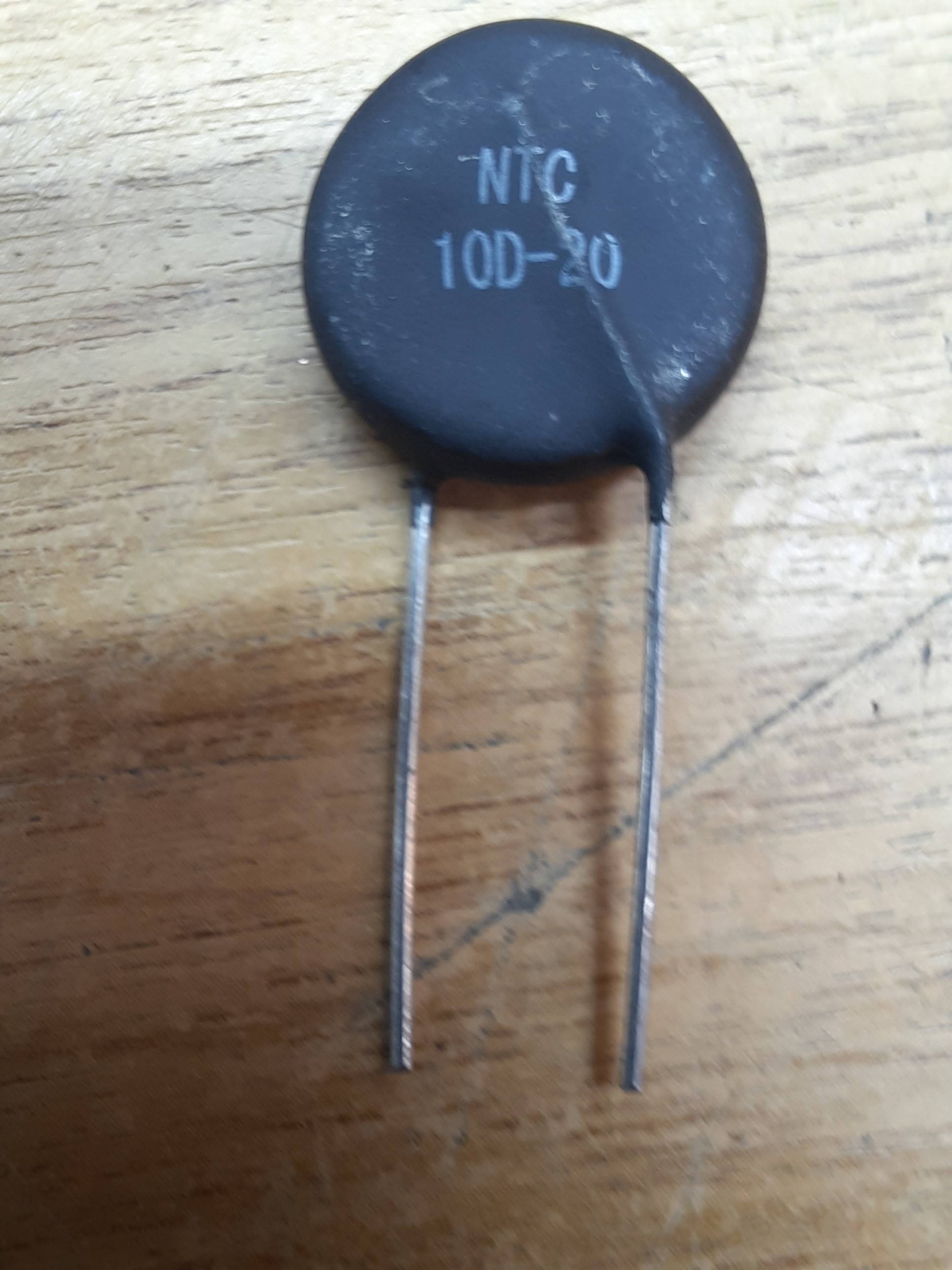

    Ended up using a powerful 10 OHM 6 AMP type .
    Unit now on test .
    Couldn't find any other issues apart from three 47MF 35V caps on the primary side of PSU measuring low .
