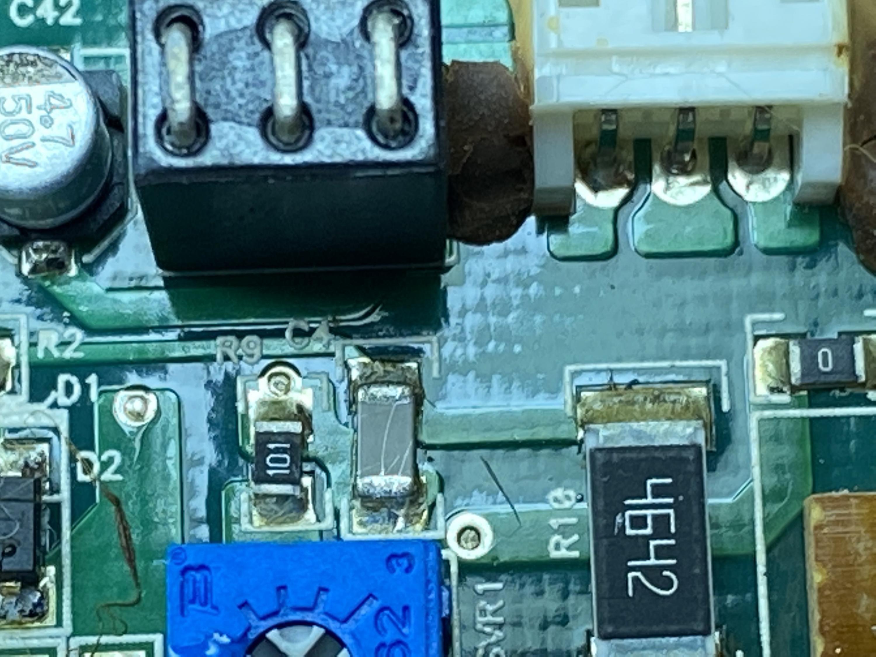

    Velodyne DLS4000r Parts ID
    I wonder if anyone could help. I am troubleshooting a Velodyne DLS-4000r that has no audio out. I traced the audio to the PA board and I get it to the C4 Cap, and nothing on the other side. I am trying to identify the value of this cap so I can replace it and see if that solves my problem. Maybe more wrong with this, but that is where I am starting. Does anyone know the value of C4 in PIC?

    Did you ever figure out the value of this capacitor? If not, just let me know and I can open my subwoofer to see if I can read it for you.
    I am in a similar situation. I have a fried capacitor in my DLS4000R sub, and I can't read the value to replace it.
