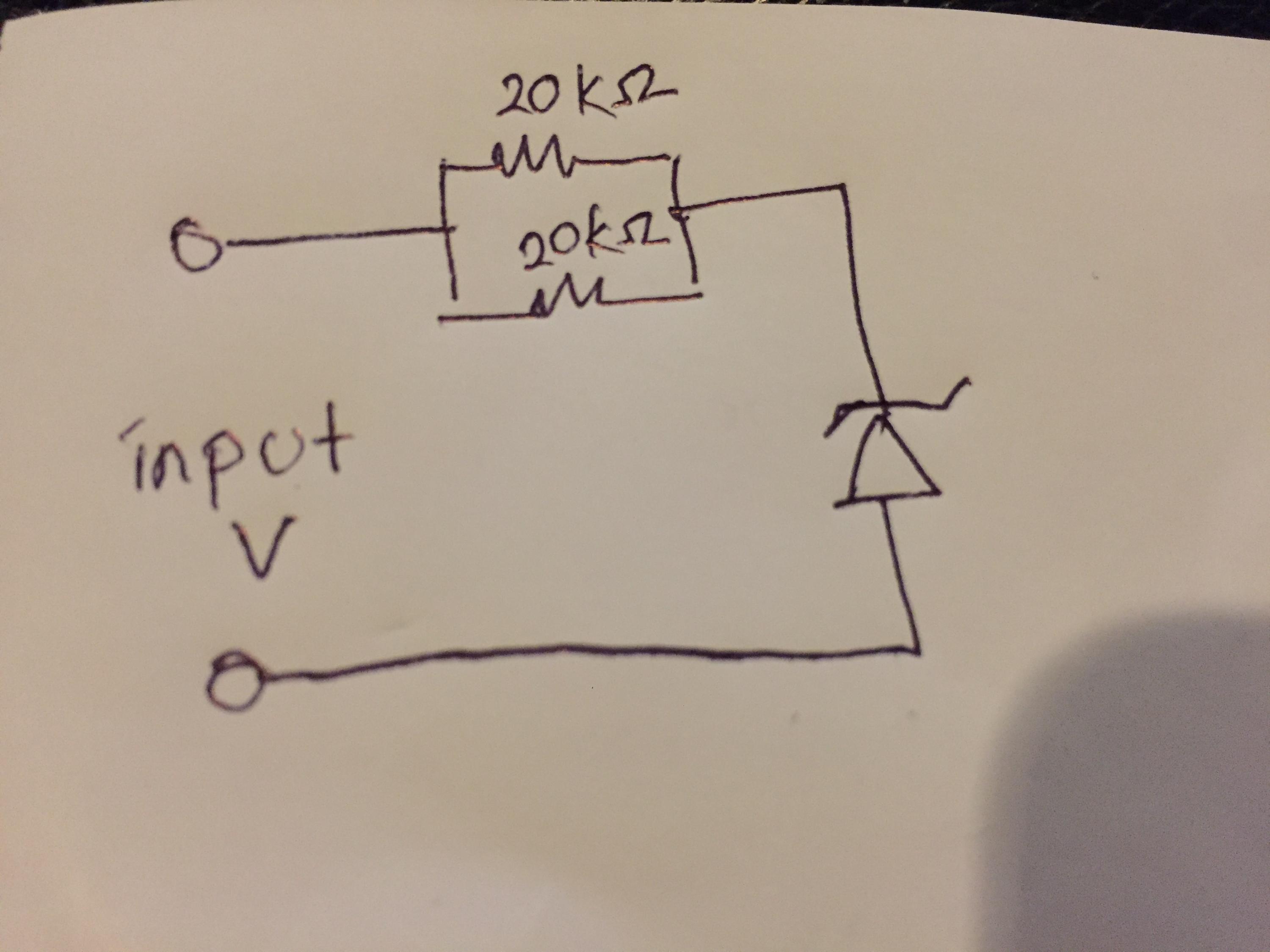

      Update on the test for the TVS diode:
      My test setup was isolation transformer -- variac -- rectifier --test circuit.
      Important note - there were no smoothing capacitors connected across the rectifier output so the DC was not smoothed.
      I had two 20k resistors in parallel connected to the TVS diode.
      TVS diode specs according to the datasheet
      Reverse Stand off Voltage (VR): 128.00V
      Breakdown Voltage VBR @1mA: Min 143.00V , Max 158.00V.
      Here are the results:
      When I set the input voltage to 154V = I measure around 120V across the diode.
      When I set the input voltage to 250V = I measure around 130V across the diode.
      What would your thoughts be on the results?
        • 31214
        Re: Bose L1 Compact Speaker, TOP258 IC blowing
        the tvs sounds good
