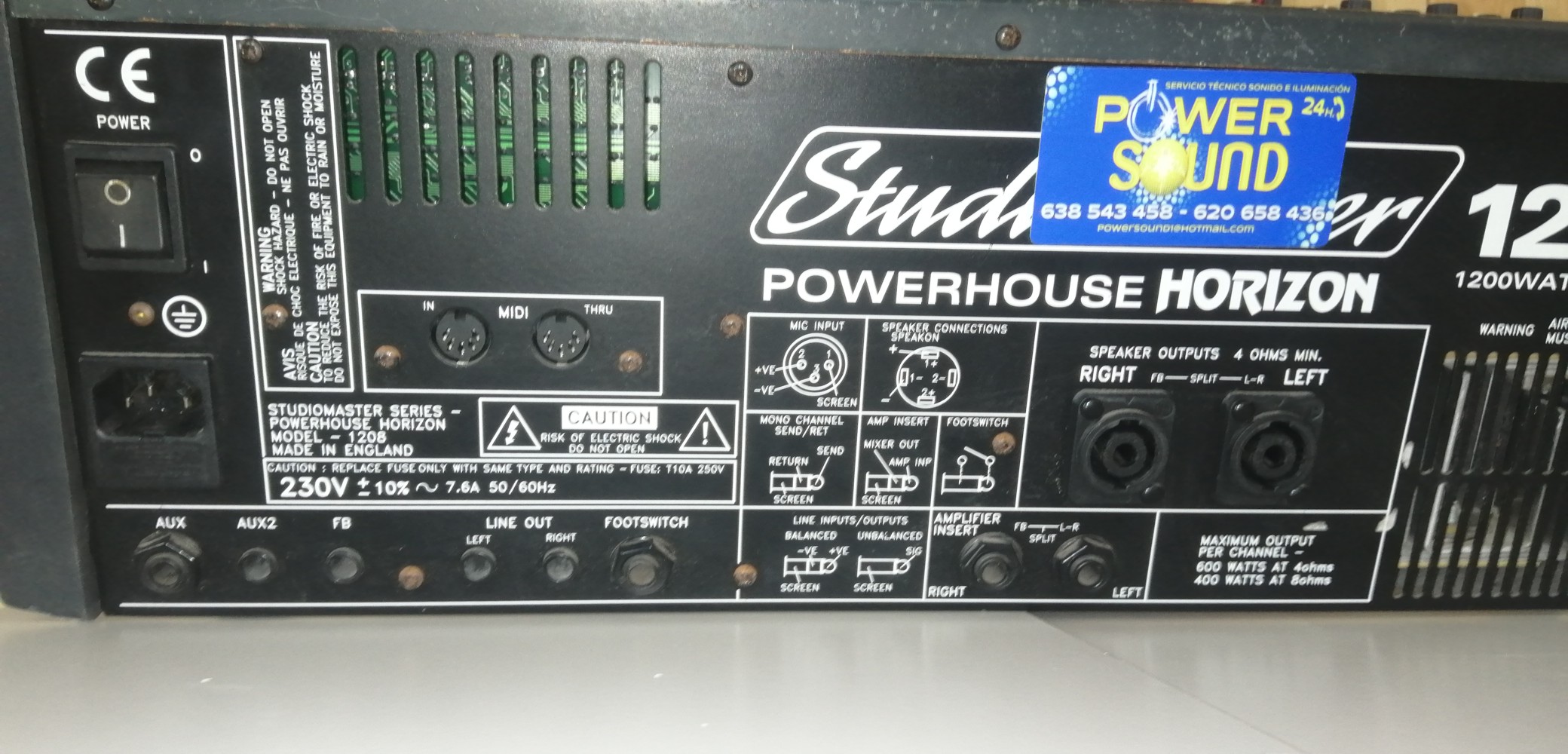

    first off plug into channels 1 and 2 ..pan one left and other right .. m1 m2 might be for monitors
    are there any switches on the back ? and any chance of pics to see the switches ?

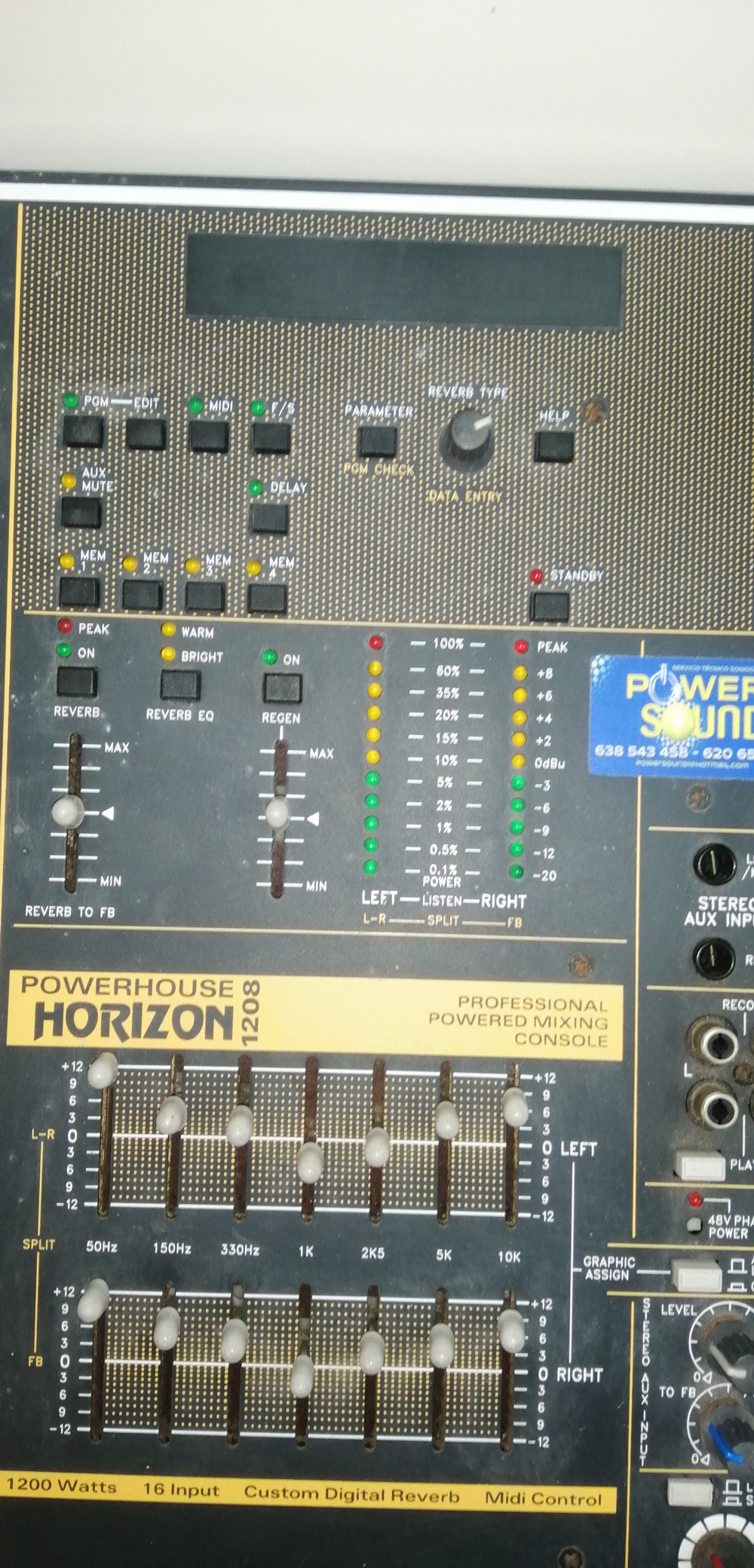

      Here are some pics
      The mixer is supposed to have some fault, but Domingo at Powersound speaks only 'some' English I only speak 'some' Spanish so we generally communicate in a mixture of Spanglish and gesticulation.
      As I understood what he was saying it has some problem with the speaker output on one channel, but that could be a mistranslation
      I will try channel 1 & 2 as you suggest.

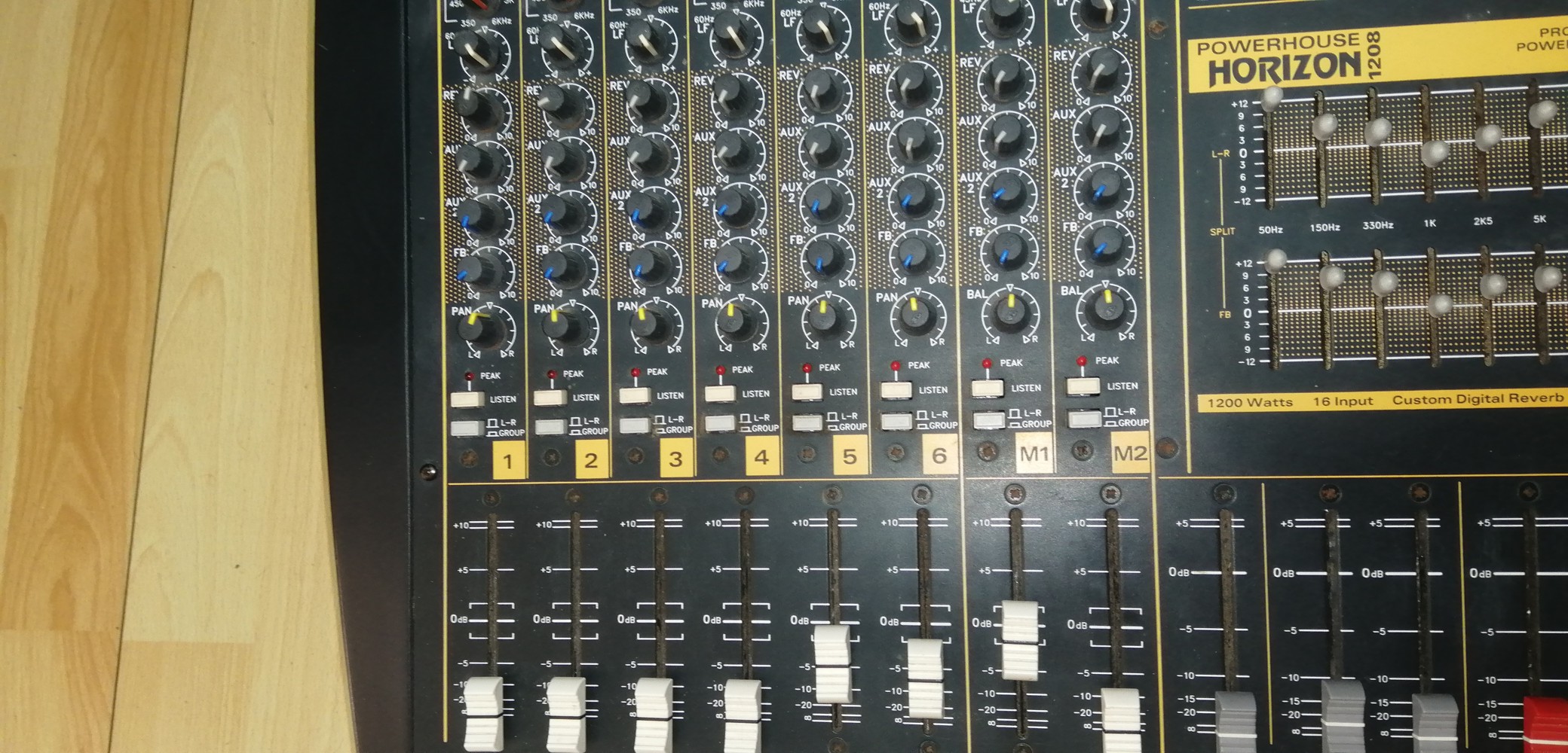

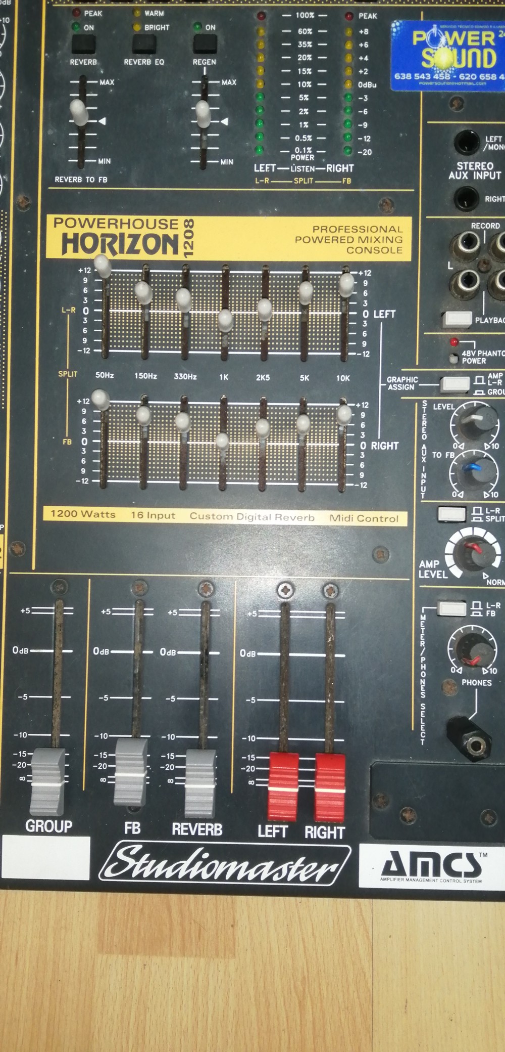

            I'm not sure what you meant by plugging into Line In - that's where I have my two Phono to 6.3mm Mono Jacks plugged in on stereo channel M1
            If I press the 'Listen' button in, on M1 channel, then the LED bargraph responds regardless of the Red Left/Right slider position - even if they are set to zero
            When 'Listen' is out I then have control of the LED bargraph using the M1 volume slider and the Red Left/Right volume sliders. So the above video is with 'Listen' button out
            Yeah I know how to plug in a Speakon connector but thanks for mentioning it
            On the Speakon connectors my speaker wires are connected to +1/-1 which would be the 'normal' way to connect them. The fact I don't get any turn on 'bump' or hiss on the speakers makes me think the amp just isn't running though it could have a circuit to stop the 'bump'
            I think the pgm button is for the programmable reverb but yeah I'll give it a go
            I guess the other thing is to open it up - possibly it is obvious where the audio out feeds from the mixer section to the PA section and I could use my scope, or just inject audio there from another mixer (non powered) that I have.

              Re: Powerhouse Horizon 1208 Powered Mixer - No speaker output
              looks like aux ins next to record ? if there is it should bypass the channels . although signals must be getting to the main sliders or the led.s wouldn't light .
              pgm is normally out to speakers .
              be easier if there is a manual for it .
              it should be pretty simple and modular inside like all my mixers .
