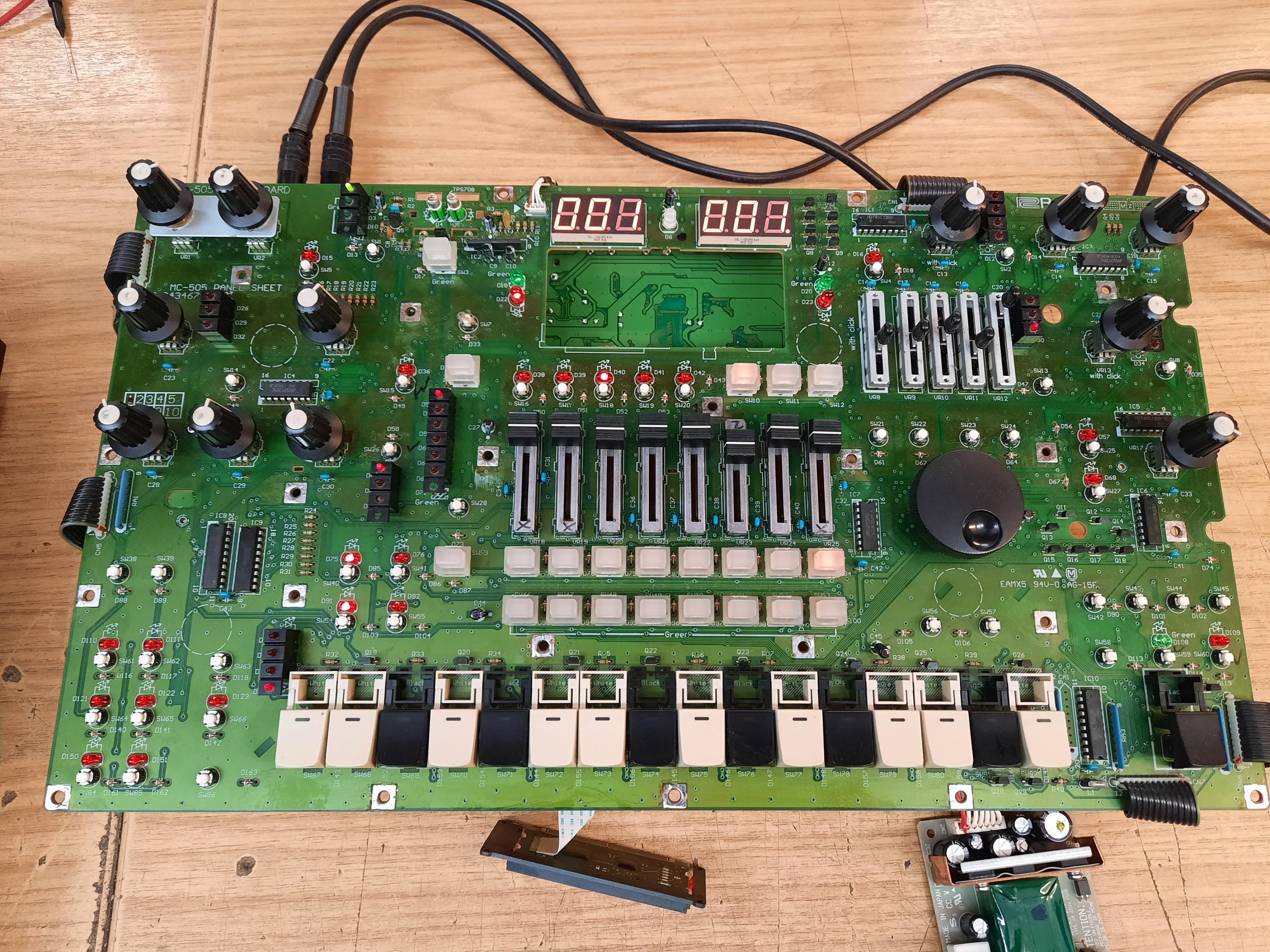

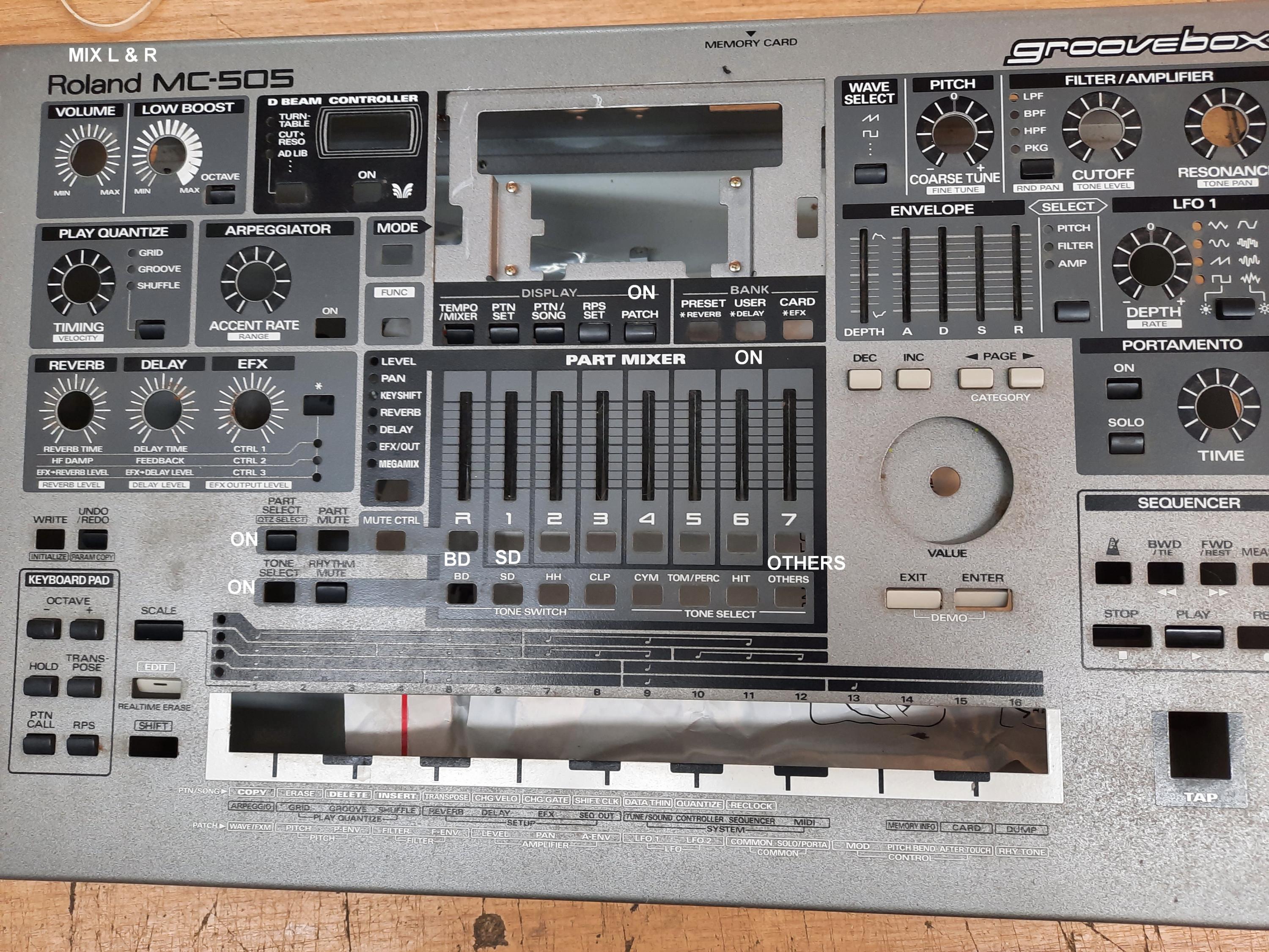

    MC-505 , Roland drum machine , schematic please
    No experience whatsoever on this unit & hoping someone can help.
    No audio from keyboard when , BD , SD , or Others selected ( see pictures )

    Re: MC-505 , Roland drum machine , schematic please
    the liquid spill is obvious - check for corrosion everywhere
      Hi & thanks
      No liquid damage
      Seem like a genuine failure .
        • 31214
        nothing to see on the top, got a photo of the other side?
        and that other board in the center too.
          Have managed to source a service manual .
          Will update with some info & more picture when i have a chance to work on it again .
          Thanks once again for your advice .
            Managed to restore missing functions with a system reset .
            Power on while holding down SHIFT, then press ENTER. Note, this procedure takes
            several minutes
