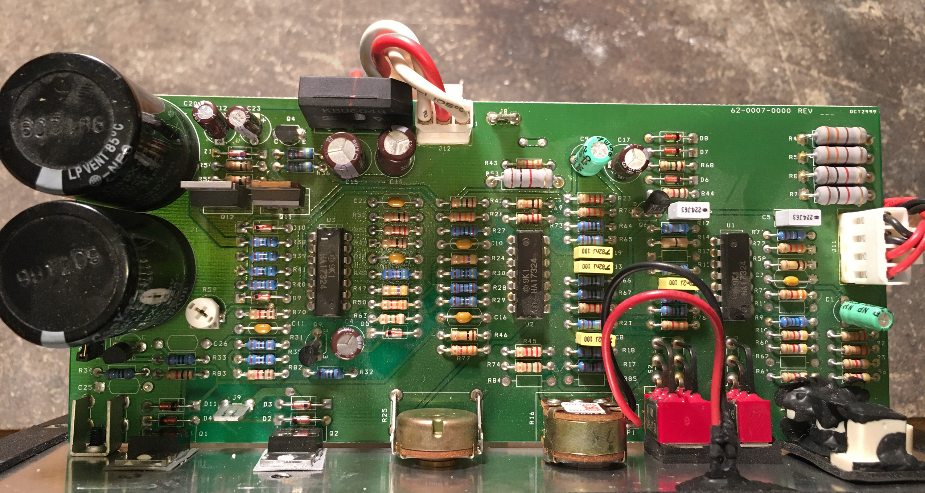

    Symptoms: Sub works, but produces a constant low level hum/buzz.
    Troubleshooting: The amp uses CapXon capacitors, the first (and only) troubleshooting step was pulling the caps (other than the large power supply caps and non-polar caps) and testing with an AVR transistor tester (upgraded with a precision voltage reference and 0.1% reference resistors):
    Code:
    Part  Original Measured   ESR   Vloss
    C4  100uF 25v  75.62uF  2.1 ohm  3.3%
    C12  22uF 50v  22.54uF  8.5 ohm  4.7%
    C14  220uF 25v  231.1uF  0.34 ohm  1.8%
    C15  220uF 25v  227.2uF  0.45 ohm  2.1%
    C17  47uF 50v  46.29uF  0.52 ohm  1.0%
    C23  22uF 50v  22.27uF  9.0 ohm  5.2%

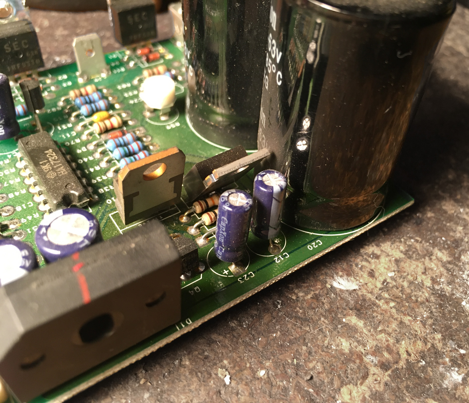

    Replaced all of the above with old salvaged Panasonic 105° caps (KM series) - C12 and C23 have the classic symptom of measuring good on capacity but with high ESR. These caps are surrounded by the power supply caps, a pair of power transistors, and the bridge rectifier - to add insult to injury, one of the power transistors was bent over as close to the caps as possible. I'm sure this was just an attempt by the amp designer to create a nice little oven to keep the caps in a thermally stable environment.
    The large power supply caps and non-polar caps measured okay and left as-is, I didn't bother pulling these out and instead used the AVR transistor tester's in-circuit mode:
    Code:
    C1  2.2uF 50v  2.49uF  3.7 ohm  Non-polar
    C9   22uF 35v  27.8uF  1.9 ohm  Non-polar
    C20 4700uF 63v  4630uF  0.74 ohm
    C21 4700uF 63v  4650uF  0.75 ohm
    Result: Success! The low level hum is gone, and the sub works perfectly. This is an anemic sub (8" driver with a 50w amp), this post is for reference in case there are other Polk subs around this era with the same symptom. The first image shows the bad C12 and C23 caps, the second image shows the amp after replacing caps. Hope this helps!
      That's very funny!
      Technically speaking, if you NEVER turned the sub off, those hot regs would keep the caps warm, which would indeed decrease their ESR and keep them running.
      Then again, with CapXon, you never know if that will work either. They just seem to like to fail, especially in audio equipment from that era. I rebuilt a set of JBL tower speakers with built-in subwoofer amps for someone, because one of the speakers was buzzing and popping badly. Replacing all the small caps didn't do the trick in my case, since it was one of the big CapXon 63V, 4700 uF caps that had gone open-circuit. Though JBL's design was probably a bit at fault too, because the 63V caps in those speakers were sitting at 58-60V DC with the amp unloaded - a bit too close to the caps' maximum rating. I replaced them with 80V caps. 100V would have been ideal, but there was no space on the board / in the box these amp were sitting in.
