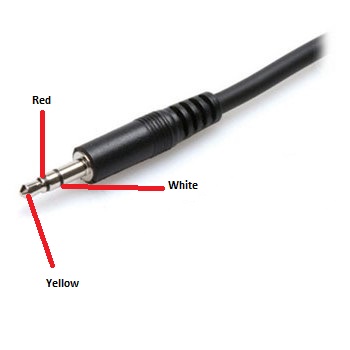

                    I measure with buzzer and this is how it's connected

                      Re: Repairing mini XLR to 3.5mm cable
                      Can someone help ?

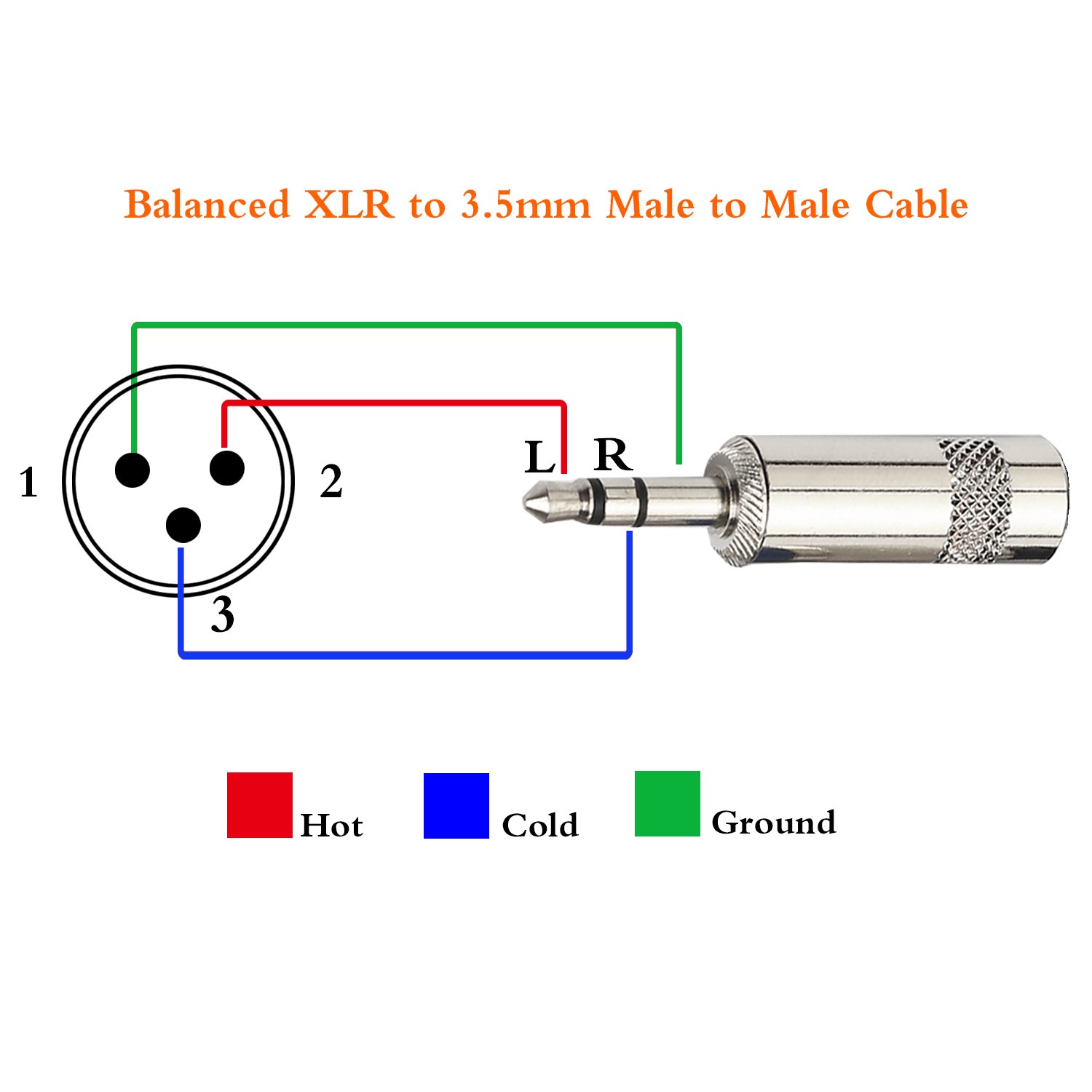

                        Does this help?
                          Aren't white and red wire for left and right speaker, and yellow ground ?
                          This what you gave me is XLR scheme.
                          I need female mini XLR with 3 pin sheme to 3.5mm male.
                            White connects to the ground in post #10, the other two are L & R.
