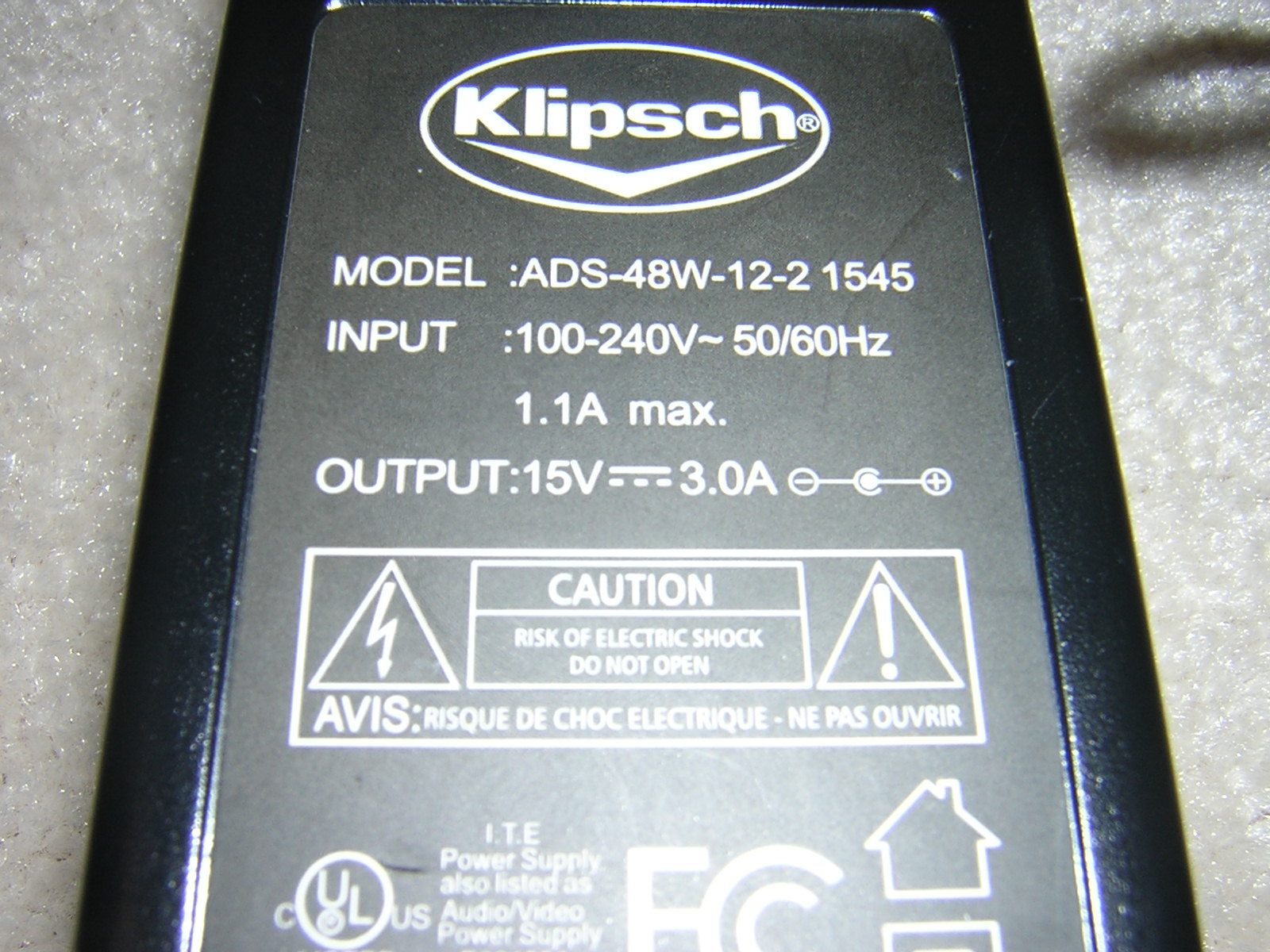

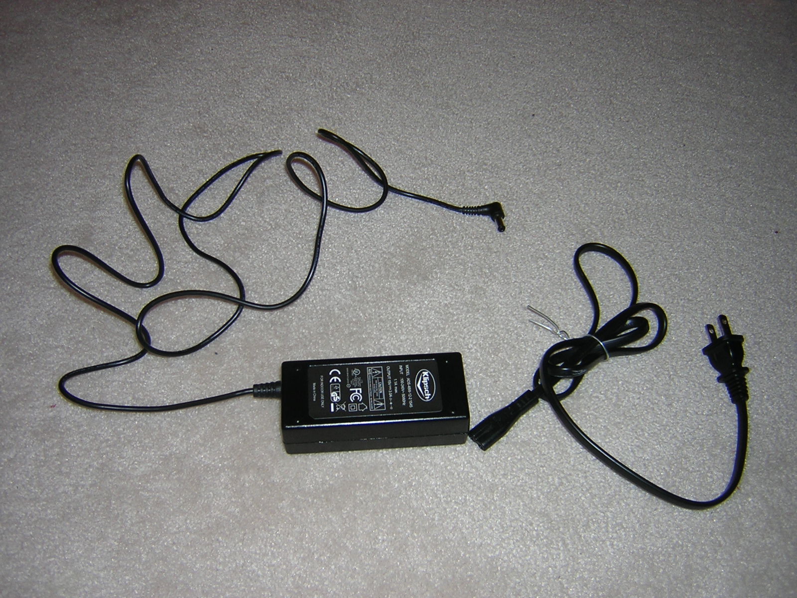

          I am enclosing a picture of the power cord since i keep referring to it.
          How to test is the power cord is operating correctly? If i am looking in the wrong place just let me know..........but if you know how to test such a thing please let me know.
            • 31305
            #45
            Re: Bad caps or inductors on Klipsch ipod speaker unit
            that's a switching psu, you'd need a scope to check that.

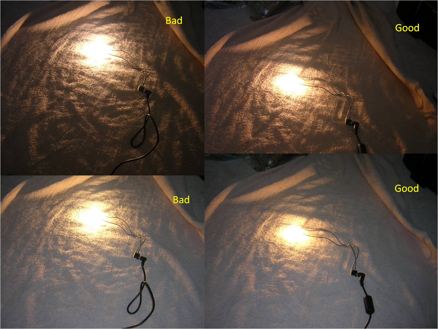

                          I dont know if this will work but i wanted to ask anyway.
                          I have read somewhere online (does not make it true) about wiring up an automotive bulb/lamp and putting one lead on the +V and one lead to the gnd of the power cord...........But what i am not sure of is what i am supposed to see after i do this. Also, if 15V are coming off the power cord do i need at least a bulb that is 15V or higher (i only have a 12V right now).
                          Any thoughts on this?
                          Am i wasting my time thinking it could be the power brick?

                              forget the car bulb - that's just to test if you dont want to risk your stuff.
                              you already tested & found 15v - test-complete.

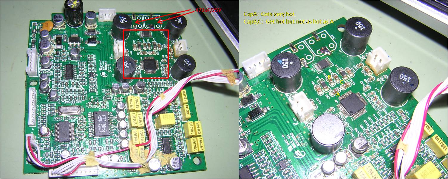

                                Its been a while since i posted on this particular thread but i recently bought two 470uF low ESR value caps to put into this thing to see if this fixed the problem.
                                Well, it did not. I "THINK" it may have helped a little........ie....takes a little longer to get hot now but it still gets hot. I did a little probing with my finger and i found something i wanted to ask about.
                                I am enclosing a pic as reference. Note: The two new caps i put on the board do not happen to be in the pic.
                                In the pic i identify 3 surface mount small caps. CapA gets hot...very hot. Caps B and C also get hot but not as fast or as hot as cap A. Could this capA be the problem or do you think its something else?

                                  That's an excellent idea. The brake filament on an 1157 bulb ?(commonly used in many automobiles) is rated for 2.1 amps at 12.8 volts. Hook it up to the power supply and measure the output voltage. If the voltage drops down to about 8 volts it would be a good idea to open the power brick.

                                    What about the "caps" in the picture? Do you think they could be bad? I had heard that these caps rarely go bad.

                                      Do you think if i replace the small caps that thiswill eliminate the heating?

                                        Its been while since i posted anything here.
                                        But i wanted to let you all know that thanks to bad-caps forum i was able to figure out what the "problem" is......ie...what is causing caps to get hot.
                                        It was the EXTERNAL power supply. I did the lamp test and it was obvious that the bad supply made the lamp burn brighter than the good supply.
                                        I also verified that using a good supply the cap does NOT get hot.
                                        I am attaching a pic of the lamp test using a good and bad supply. Its hard to tell from the pic between good and bad but look at the amount of light output for each.....the bad supply has a larger diameter light output as compared to the good supply.
                                        The pics are not as good as i had hoped......if your just looking at thelamp its easy to see the bad supply is much much much brighter......so bright it hurst your eyes.
                                        Now comes the task of figuring out what is causing the external supply to output more current than its supposed to.
                                        Note: I did measure "voltage" of the bad supply with nothing connected to it and it was as it should be ~15V. This is the voltage value on the label of the supply.

                                          You've got it backwards. The bad supply isn't putting out too much current, it's output has too much RIPPLE. Odds are the output caps are bloated.
