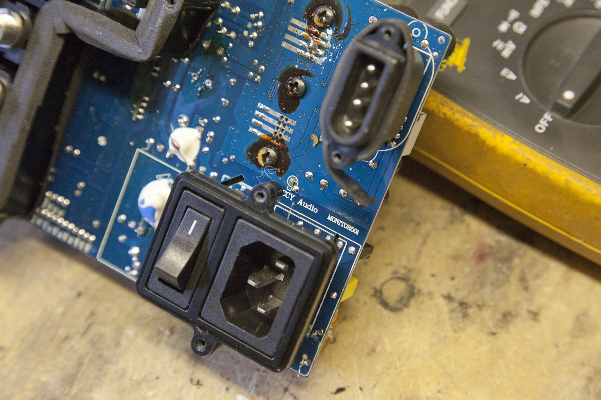

    AEG BSS 4812 only blinks its red light. No sound even from aux, and the bluetooth is not visible to cellphone. When I plug it to computer via USB, a microphone device appears. So the power supply seems to be working.
    The board says CCY audio Monitor50i-M. I can't find any information.

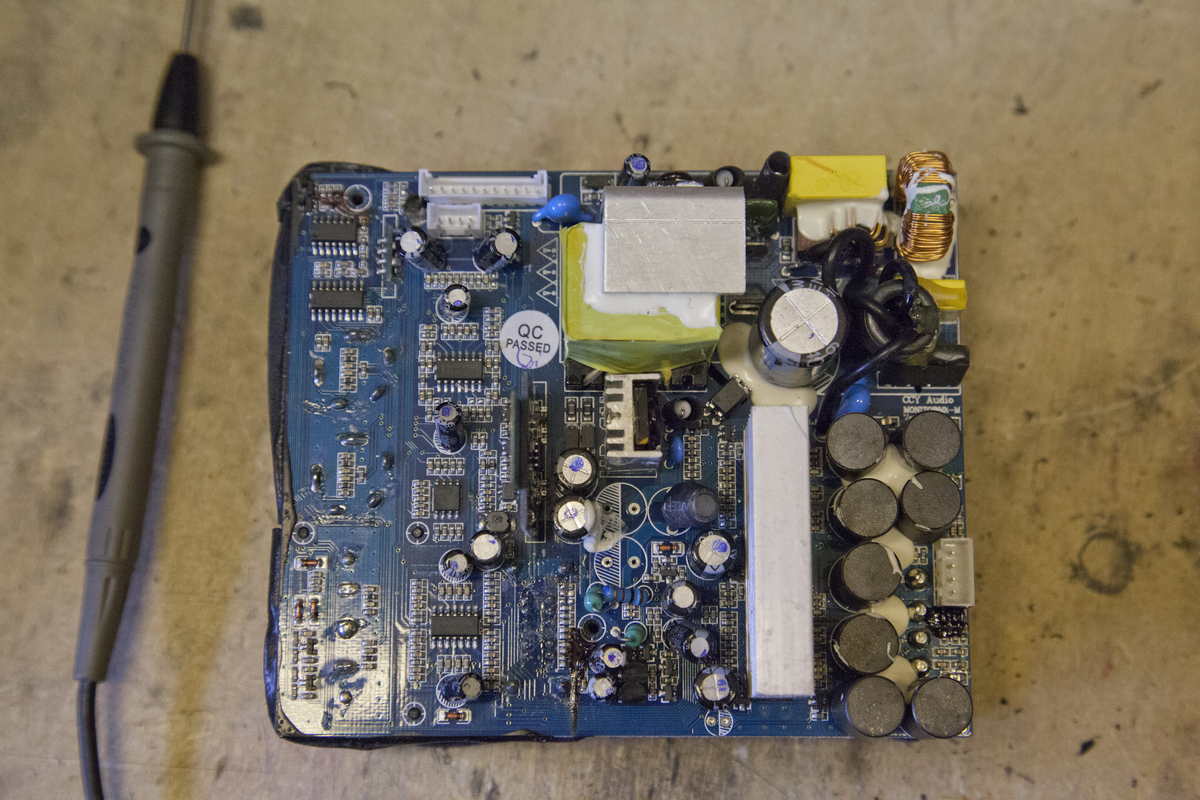

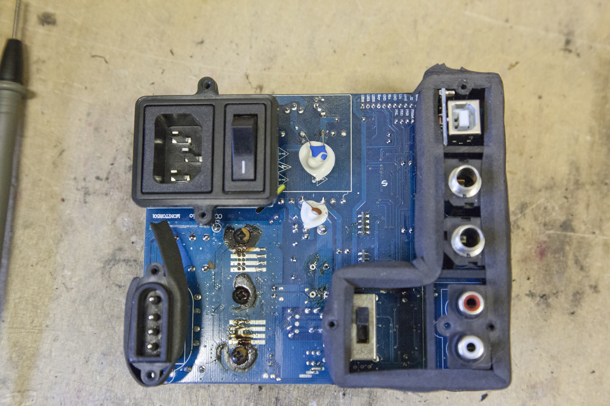

    Please show us pictures of the top and bottom side of the boards. There may be many sub-power supplies, Voltage regulators, buck/boost converter... that will need to be checked.

      It seems to be a generic chinese board. First pic shows two missing capacitors, I removed those.
        Re: AEG bluetooth active speaker fault
        If I heat the top left area within 1 inch of the corner, it starts to work. I tried with a piece of cardboard to prevent other areas to heat. The chip is a CD4052BM and the smaller one has no markings.
          4052 is an analog switch - probably for selecting the source.
          some small caps in that area too.
          i notice it has conductive/corrosive brown glue in places!

              If I heat the corner too little, the light blinks barely visible until I press the button to change input. Then it blinks normally, i.e. the fault is on.
                The capacitor in the middle of the top edge was forgotten one, I changed it and so far the speakers have worked every time I switched them on.
