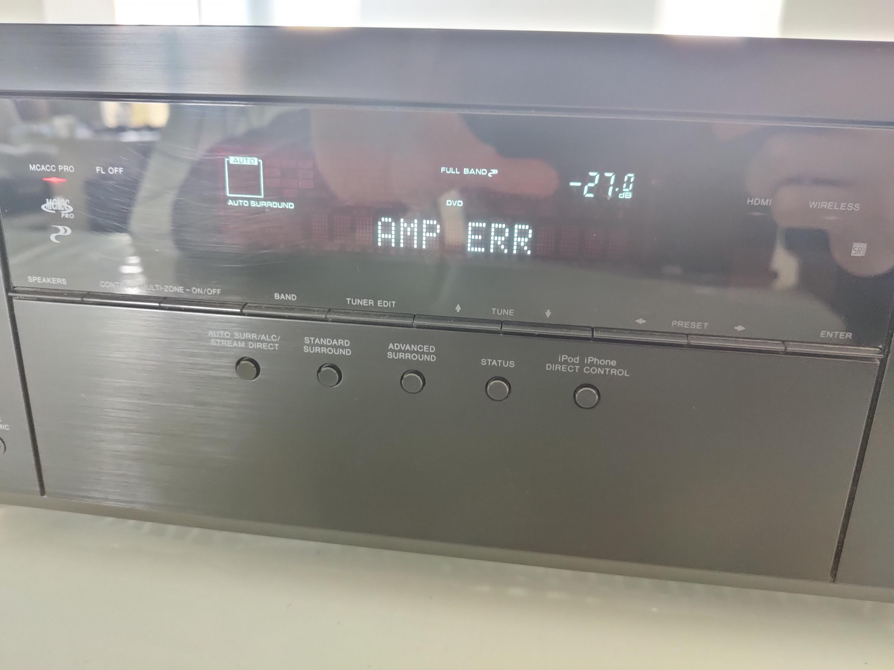

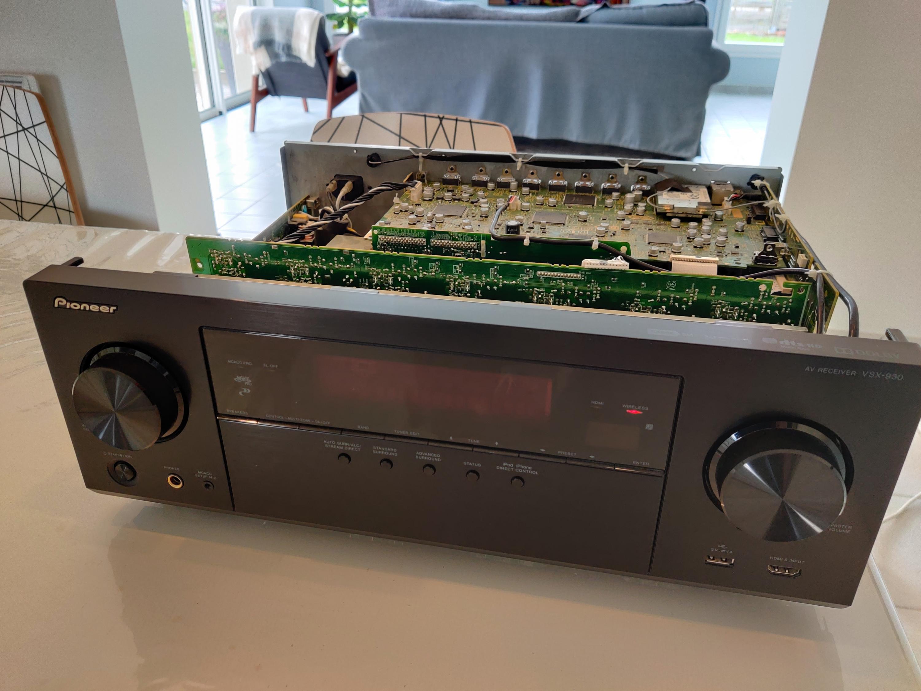

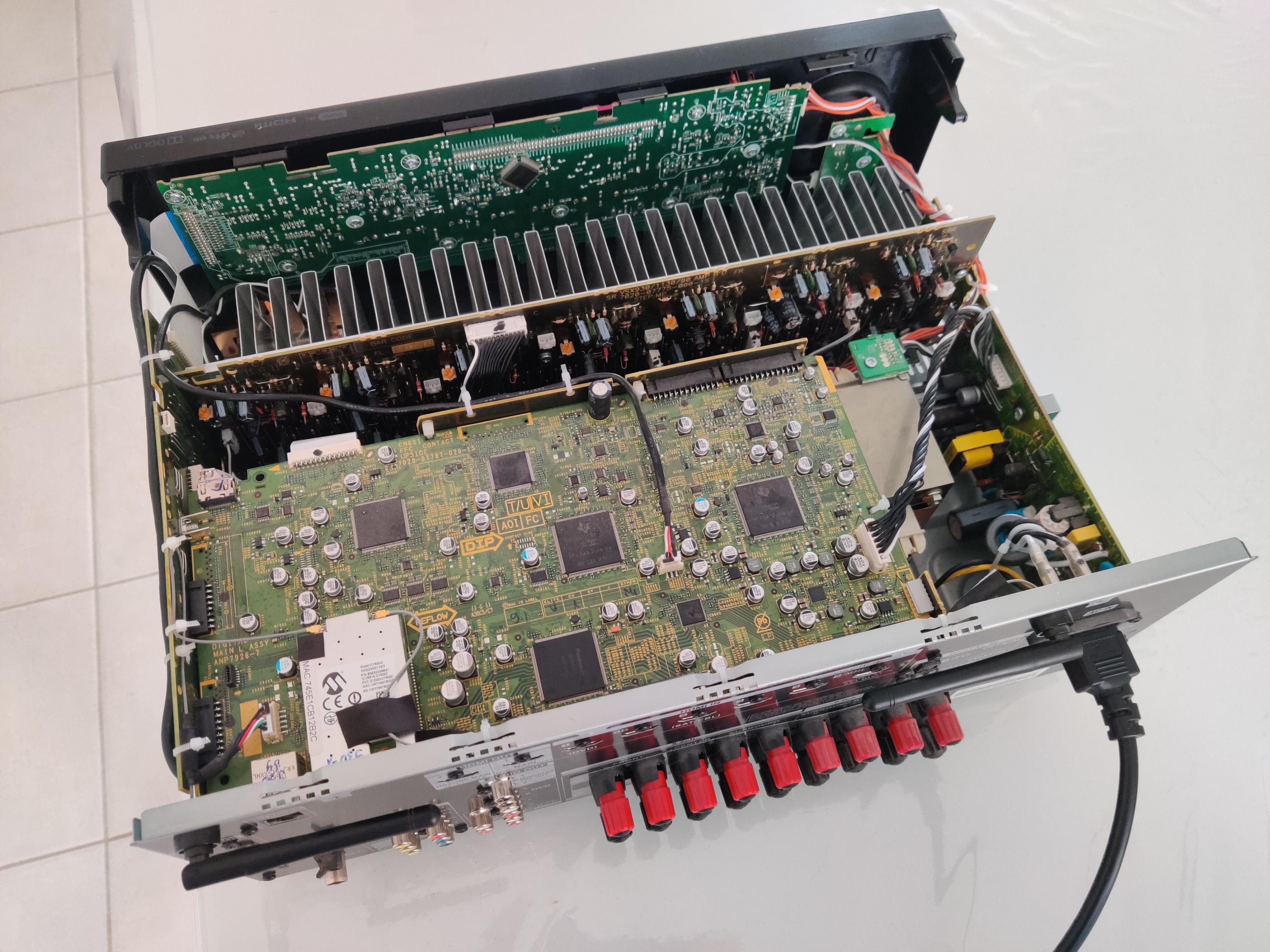

                Sorry to bump an old thread but I'm having the exact same problem.
                Got amp err on the display then when reinserting the amp board. I'd tried unplugging different channels as desoldering each transistor and checking them seems like a huge hassle. Though I think it's 5.1 surround left, so that would be surround back left? That speaker made a popping noise once, the AVR reset and then it made another popping noise and I got "amp err" and a blinking MCACC light. However as I was plugging one of the cables in I got a small arc (the AVR was powered off so I assume it's residual power from a cap somewhere. Now it's the WiFi light that flashes and I can power on with the power button but it shuts down just as quickly. Visually the board looks immaculate and it broke down whilst running the speakers at 45dB attenuation.
                Did OP ever find a solution? Any advice for me if I'm to repair this or is it wrecked now?
                Thanks!
