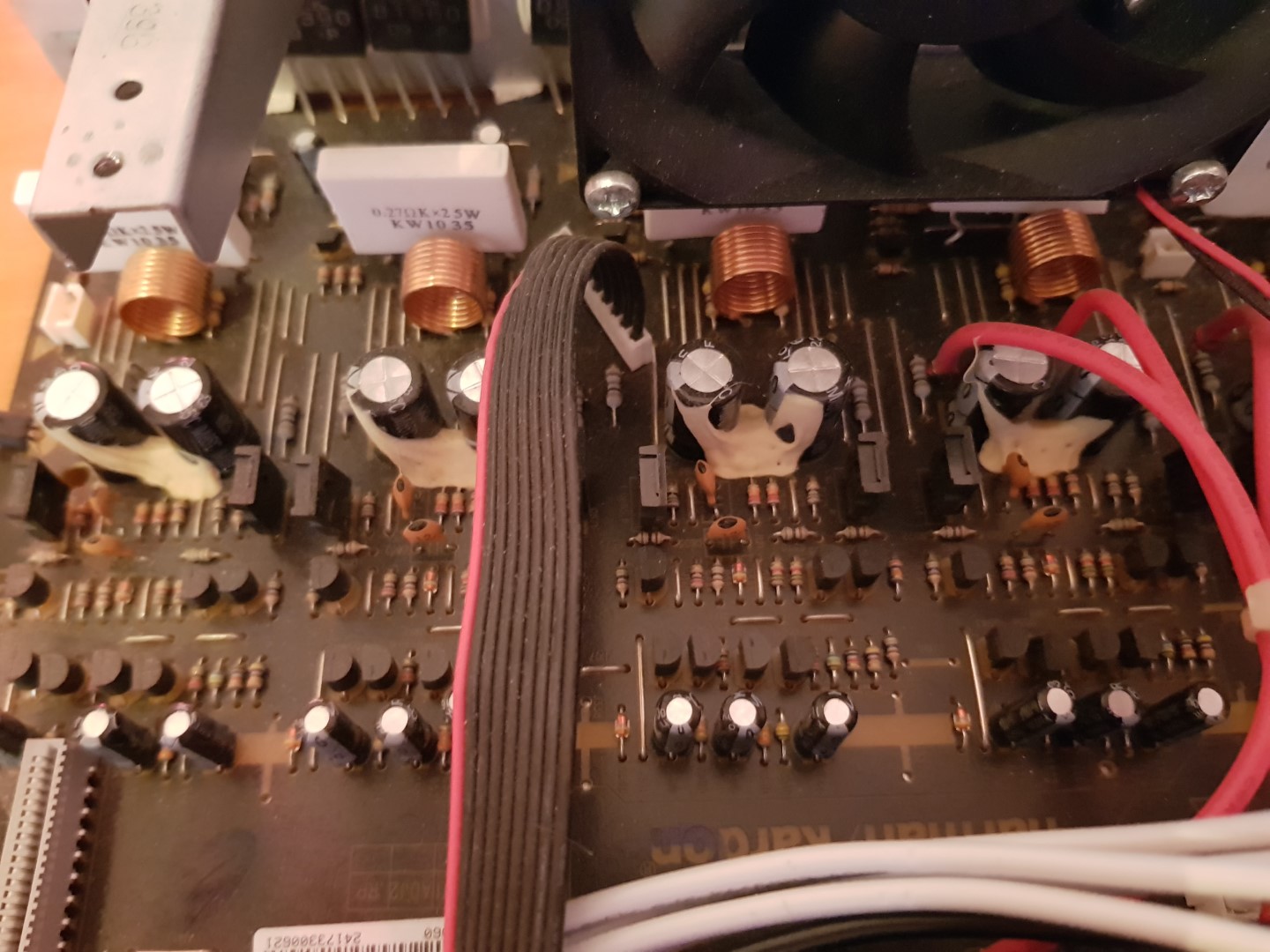

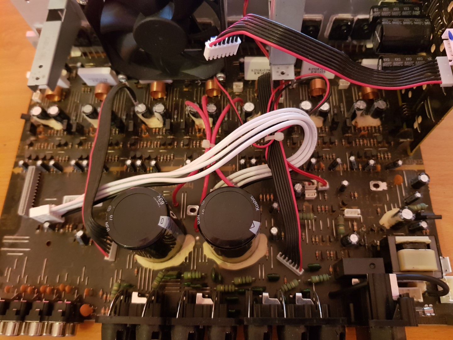

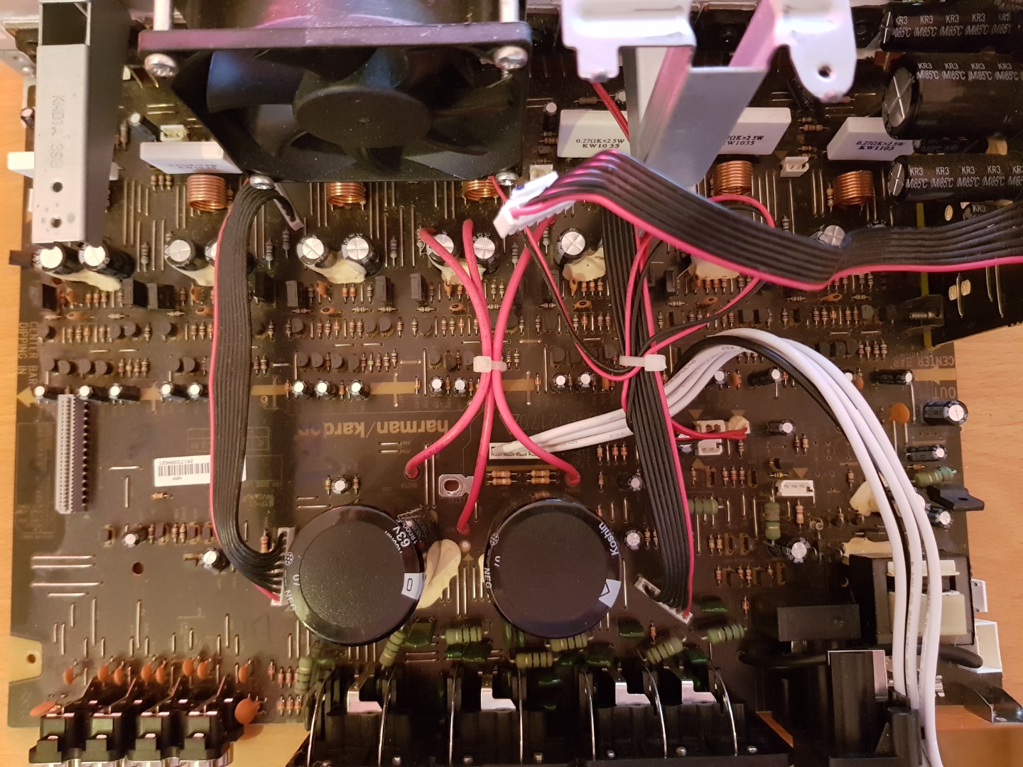

    Hi
    Background:

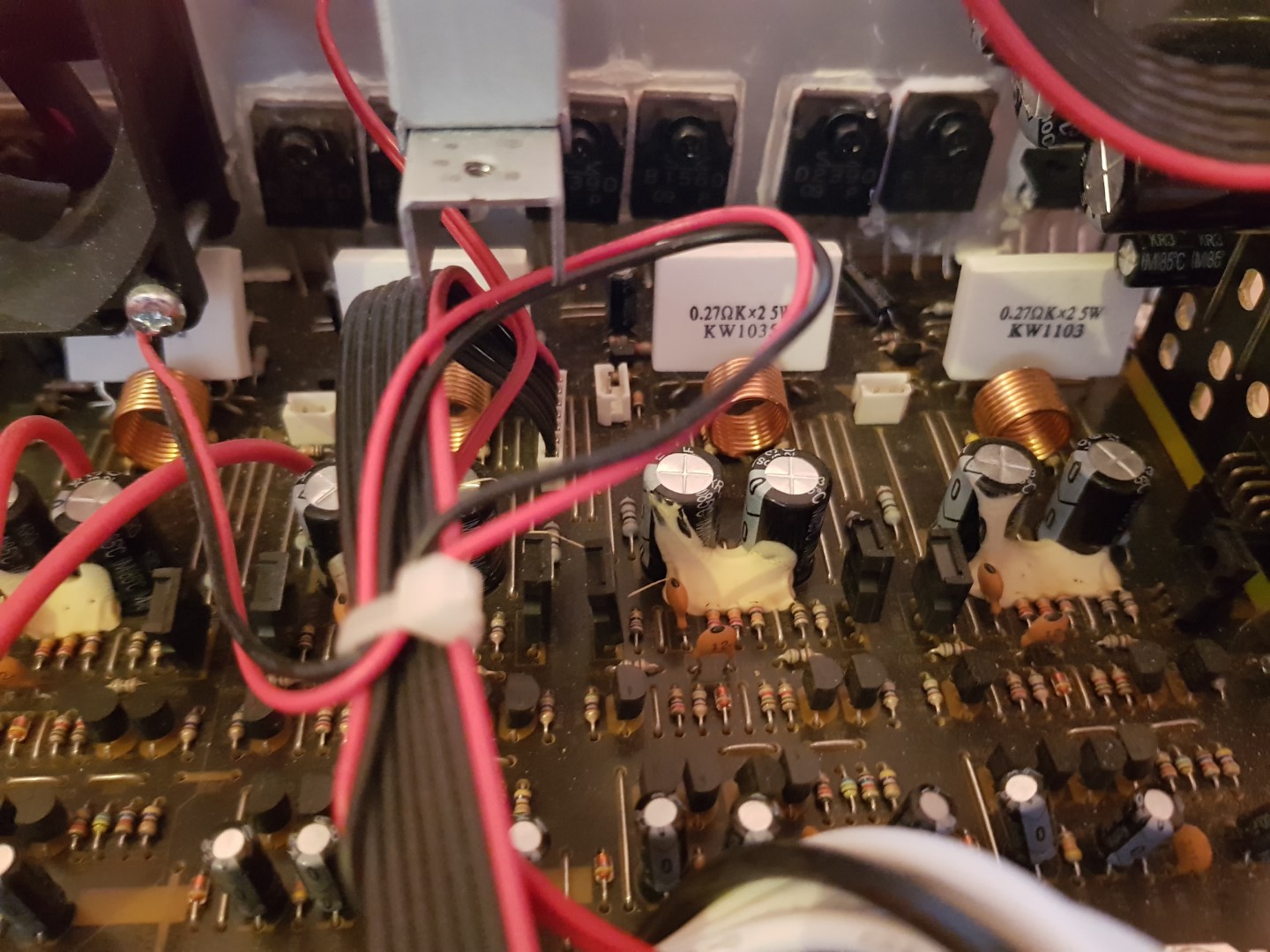

    This unit suffered from high voltage, 27 V, on the surround Left channel. This triggered the protect circuit, as its supposed to, after start up.
    After disassembly I checked the Power transistors Sanken B1560 and D 2390 and measured all channels. Found one B1560 broken.
    Also the corresponding large dual ceramic resistor 0.27 Ohm had one resistor shut.
    Problem:
    Even though the 27 V offset value has been reduced I still have DC Offset on nearly all, including the one repaired. Occasionally the protect mode hits in.
    Here is my measured values:
    Center 2.7 V
    Surr L 2.7 V
    Surr R 1.3 V
    SBL 0.117 V
    SBR 0.0286 V
    Front L 0.5 V
    Front R 1.297 V
    Service manual do not cover DC offset and I cant find any obvious reason why the values diverge this much. Other than having to change all transistors, is that really necessary?

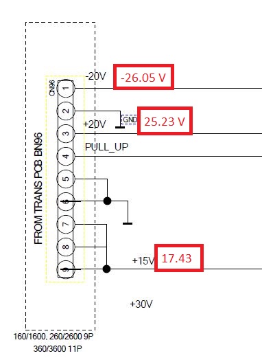

      Hi
      I checked the mains from transformer, though semi-complete. Missing HDMI-board but powered on.
      Measured BN96 from the main transformer board, see attachment.
      Service manual is not quiet clear, two values are stated on different boards.
      Pin Measured Should be
      1 - 26.05 V -17, -20
      3 25.23 V 17, 20
      9 17.43 V 15 V
