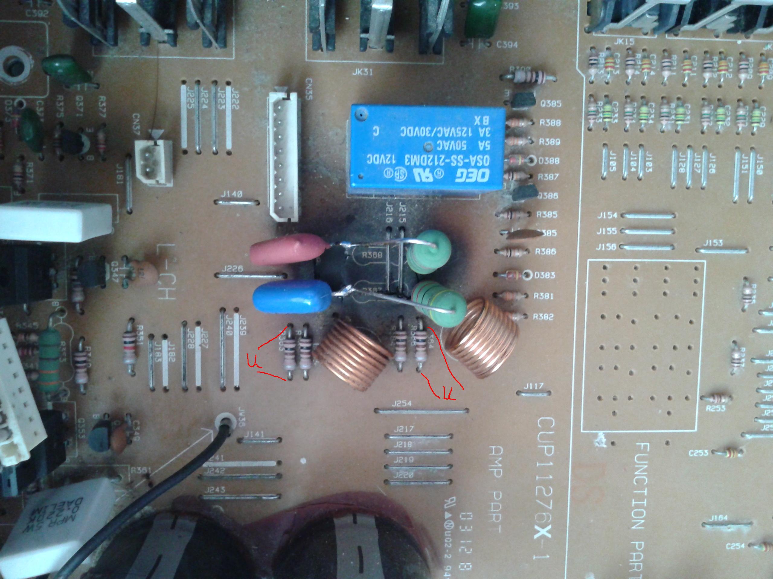

    I have this amplifier for repair.
    I found scheme for Marantz PM4200/N1B from
    here: https://www.manualslib.com/download/...tz-Pm4200.html
    Heat comes from C4467.
    As i notice it has higher base voltage.
    I move back and back and notice that problem start
    from first transistor after IC AN7062N - A1268.
    On second chanel base ot A1268 has 1.7V, but on chanel
    that produce a lot of heat A1268 has 2-2.1V on his base.
    Where to continue to check for fault?

        Ah, right - the "C4467" part threw me off. "C" is usually the designator for capacitors, and since you didn't say "one of the C4467's" (because there's two of them, one on each channel), i didn't think it was the marking representing a 2SC4467.
        You could compare the voltages on CN37 and CN38 (see "Idling current adjustment" on page 5 of the service manual), and if one of them is far off (which it may well be), see if you can adjust it to bring it back to where it should be.

            Thanks for reply and support.
            Here is the results:
            1. On CN37 (without heat) voltage start from 1.7 and start to increase with 0.1v (1.8 1.9 2.0 2.1.....).
            At 3.2V i turn off amplifier. Then move to CN38 and turn on amplifier. It show ~0.2V (40 times more
            than normal). No way to adjust it with potentiometer. BTW both pot`s are on middle position.
            With pot on problematic side i can adjust voltage of emiter on transistor A1268 (next to IC AN7062)
            to ~1.9V (it must be 1.7V).

                Lets start with the reference numbers, Emitter of a1268 has no meaning, Please use the transistors position, Q349, Q350, Q326 or Q325 ? these are all a1268, you see the confusion?
                If I asked for the voltage on 10, where would you measure it? but if I asked for the voltage on R337 or R338 you would know where to check it.
                As for the adjustment, you are doing it all wrong, If you adjust VR31 You must watch the voltage on CN37
                If you adjust VR32 You must watch the voltage on CN38
                You adjust the voltage on those plugs for 5mV (0.05V)

                          May be this is the right side of schematic - Q379, Q371, D373, R359 (0.22 ohm,
                          5W)?

                              Re: Too much heat from Marantz PM4200/N2B
                              Thanks to all for support.
                              There is 2 diodes in series (D331 and D333). May be they use them
                              like Zener diode at 1.4v....
                              So, one of this diodes has problem. I don`t know the right words, but
                              other diodes has ~0.7 voltage loss over it.
                              But 1 diode has 0.98V across it. And this was 0.2V difference between
                              both channels.
