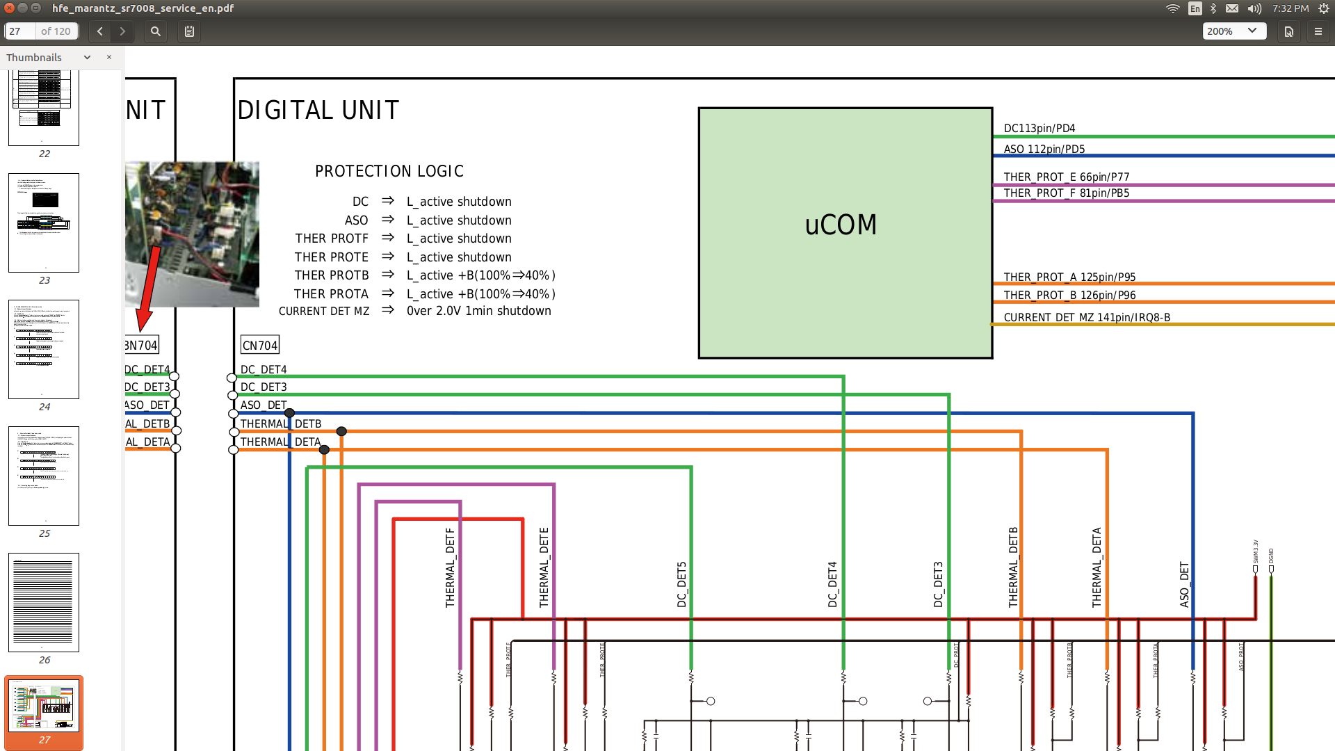

    If I measure the Thermal Detect B line coming from the Amp it measures identical to the Thermal Detect A line (about 1v). This makes me think the problem is not in the amp but in the way the B detect is handled.
    I can't tell if the cpu is looking for active low or active high to shut the unit down. I'm attaching the SM, schematics and a screenie of the pin designations of the cpu.

                      There doesn't seem to be any documentation on the levels of detect but this is from the SR7008. I don't know what it's saying but maybe it's relevant to SRx008 series ?

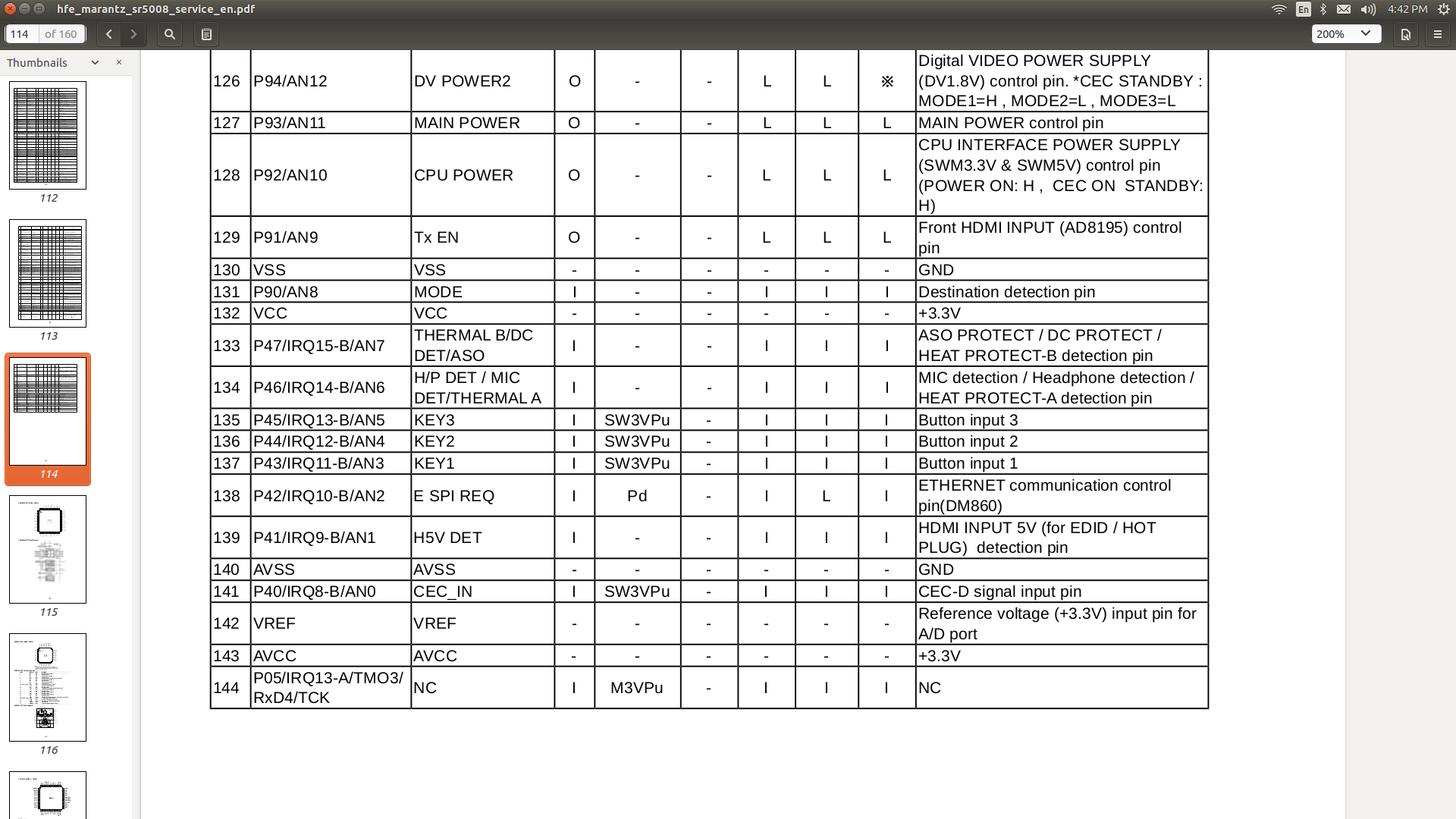

                        I would think that with out any error transistors turned on there should be 3.3 volts supplied to the cpu via the pullup R3227, the same with the THER_PROTA line, It should be 3.3v via the pullup R3251
                        The CPU is looking an analog input on pin 133 so its not a high or low (0 or 3.3v)
                        cpu pin 133 or 134: A/D converter AN0 to AN15 Input pins for the analog signals to be processed by the A/D converter
                          Thanks for that explanation. That makes sense.

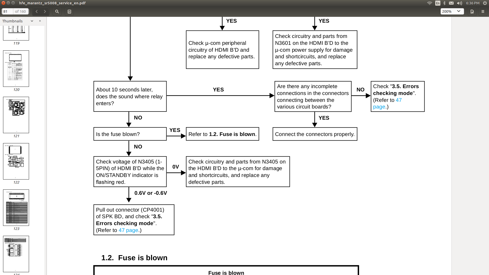

                                  I have not yet removed this transistor because the logic doesn't seem quite right, or maybe I'm over thinking it.
                                  This troubleshooting flowchart from the SM indicates an error condition presents with a +0.6v or -0.6v on one of the detection pins. I measure 0.7v on both thermal pins when the unit is trying to start up before it goes into protection. At that point the voltage returns to zero when the led flashes red as it says. Isn't that to be expected ? Shouldn't I see the error voltage when the unit is trying to start ?
                                  • R_J
                                    • Jun 2012
                                    • 9583
                                    Re: Marantz SR5008 Protect Mode
                                    I never did like flow charts, especially chinglish. It seems to say if you get +- .7 volts that is good, if its 0 there is a problem. Its obvious if the amp shuts down the voltage would go to 0
                                    What about pulling CP4001? That should eliminate any error signal coming from the amp board.

                                      I read it that +/- 0.6v is amp damage (DETECTION circuits detecting something) and 0v means the PROTECTION circuits or cpu itself have a problem.
                                      Either way I cannot find a CP4001 so I'm not sure which connector they're referencing. I think it's just a means to let the unit power up without shutting down to check what faults were registered.
                                      Question: Should the amp error detection circuits work unplugged from the rest of the circuit (the protection circuits) ? If that's the case and the amp is NOT the problem unplugging connector C404 should allow the unit to boot up fully but it still goes into protection.
