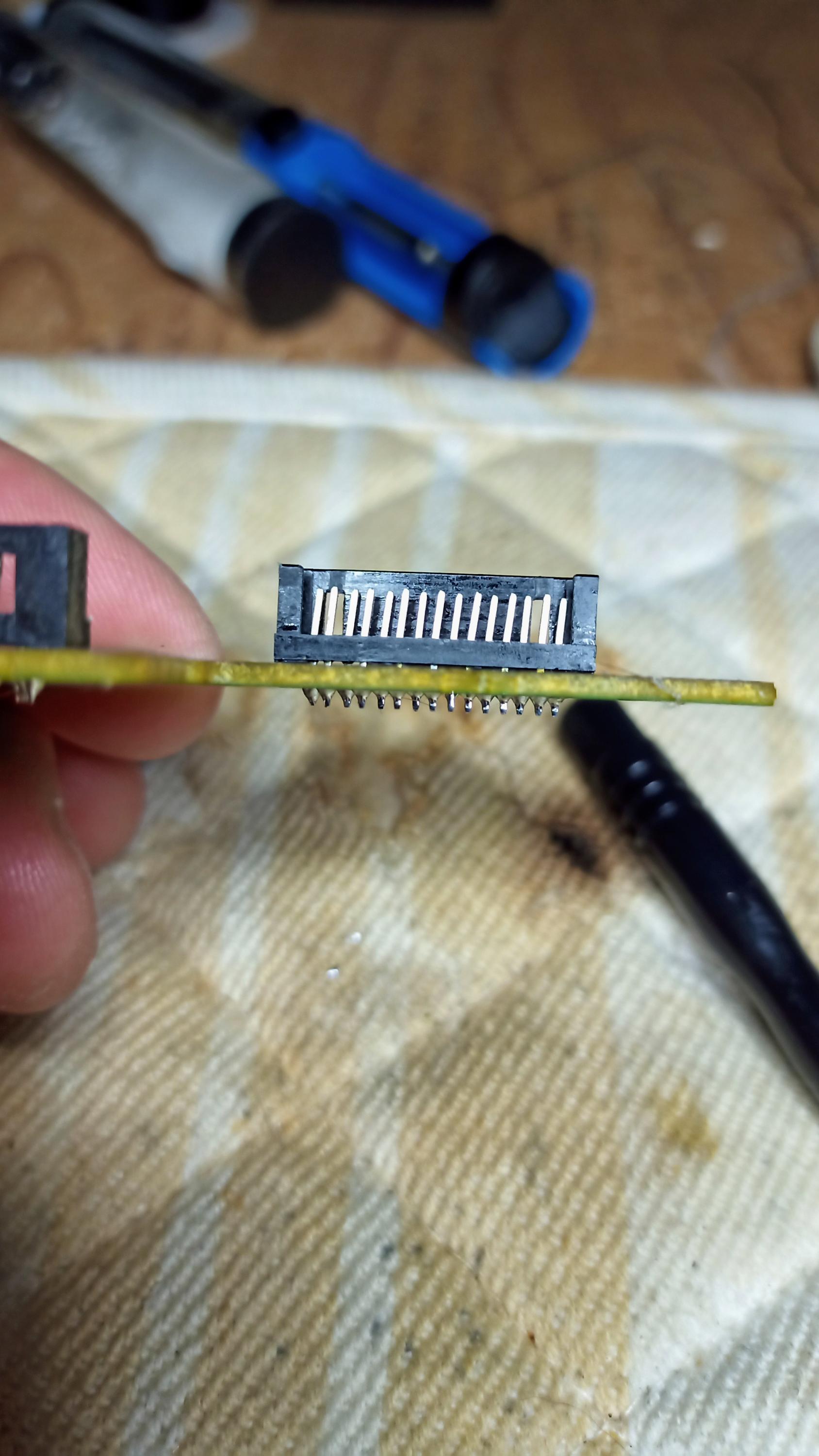

                        The problem is definitely the edge connectors. I located three that were causing my problems.
                        I want to say it was the female part of the connector but I find it hard to believe these were not making full-time contact. I suppose the male pins could have been oxidized or something of the sort but they looked fine to me.
                        I resolved the issue by slightly bending the male pins within their sockets before replugging. The extra pressure helps make solid contact.
                        I would guess there's a manufacturing defect of some sort here. I tore this thing down and rebuilt it several times before isolating the problem and all the other edge connectors have held up fine.
                        • mmartell
                          • Oct 2013
                          • 3189
                          #32
                          Re: Marantz SR5008 Protect Mode
                          Pic of one of the male connectors...

                            I know this is old by my unit just started doing the exact same thing do you recall what 3 edge connectors, i want to be least invasive as possible with pin bending.
                            • mmartell
                              • Oct 2013
                              • 3189
                              #34
                              I still have this unit but have not plugged it in in some time. As for which connectors I don't recall except that one was the vertical board extending from the back plate.
                              There is something going on here for these to fail this way. You would be better served to find another way to make those contacts reliable again - I seem to remember my "fix" not holding up very well.
